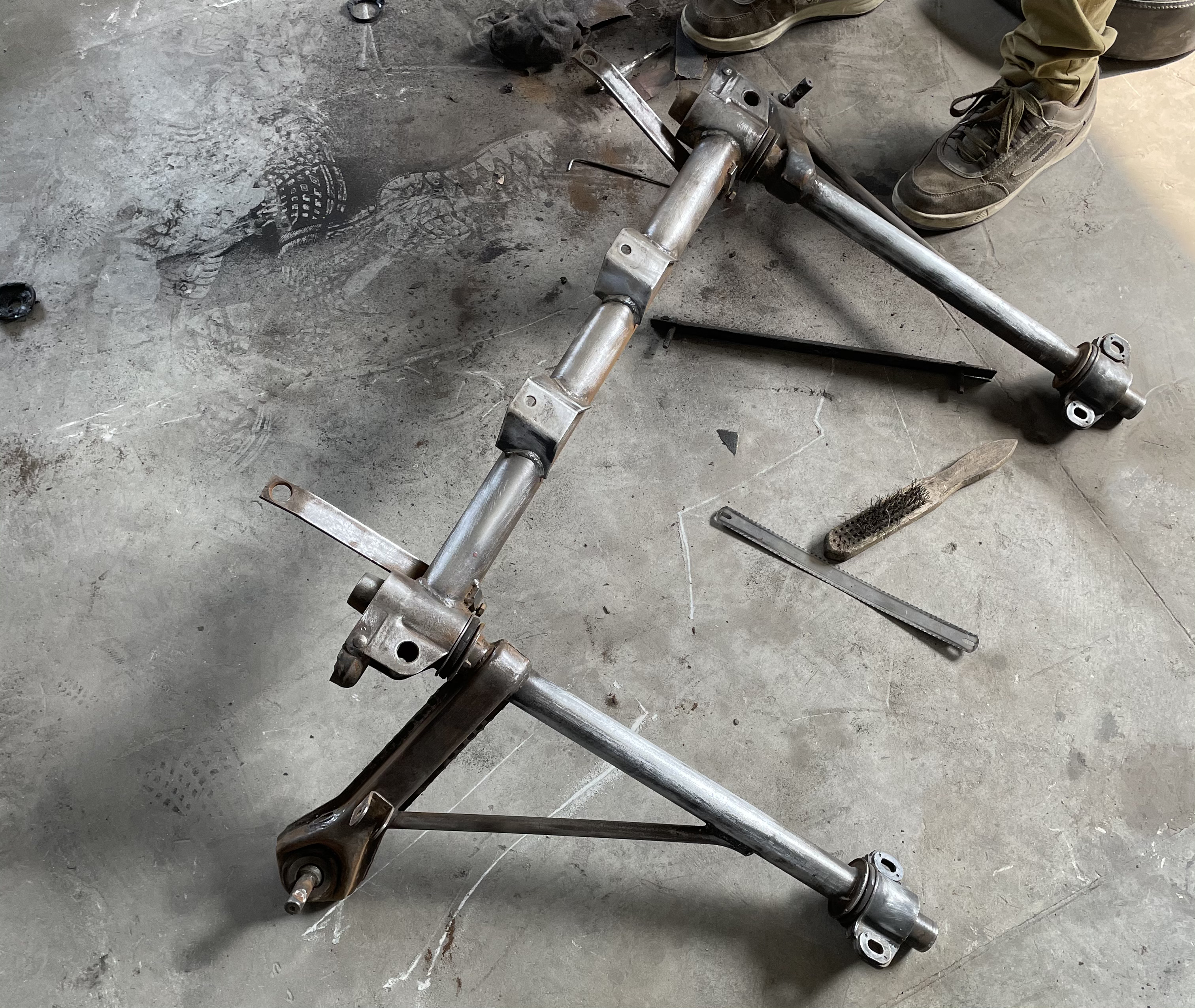

Asheikh   Trailing arms   Feb 10 2021, 05:56 AM
Asheikh   Trailing arms   Feb 10 2021, 05:58 AM

ClayPerrine   Check the powdercoating on the rear trailing arms....   Feb 12 2021, 10:23 AM
