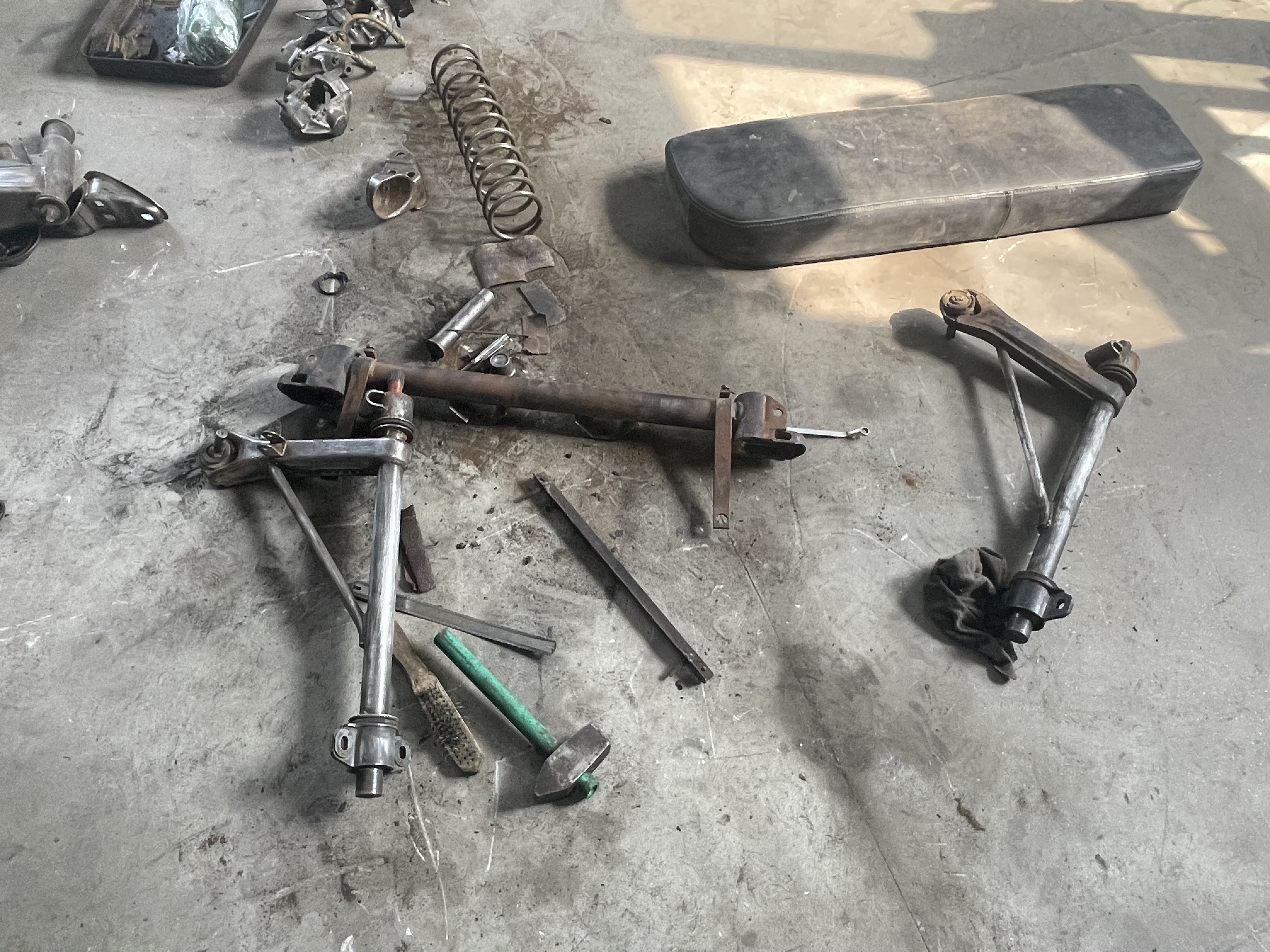

Asheikh   Going to disassemble the complete suspension syste...   Feb 9 2021, 11:51 AM
Asheikh   Hope I’ll be able to get the calipers repaired l...   Feb 9 2021, 11:54 AM

Asheikh   Going to send all the following parts for powder c...   Feb 10 2021, 05:14 AM
Asheikh   Trailing arms   Feb 10 2021, 05:56 AM
Asheikh   Trailing arms   Feb 10 2021, 05:58 AM
