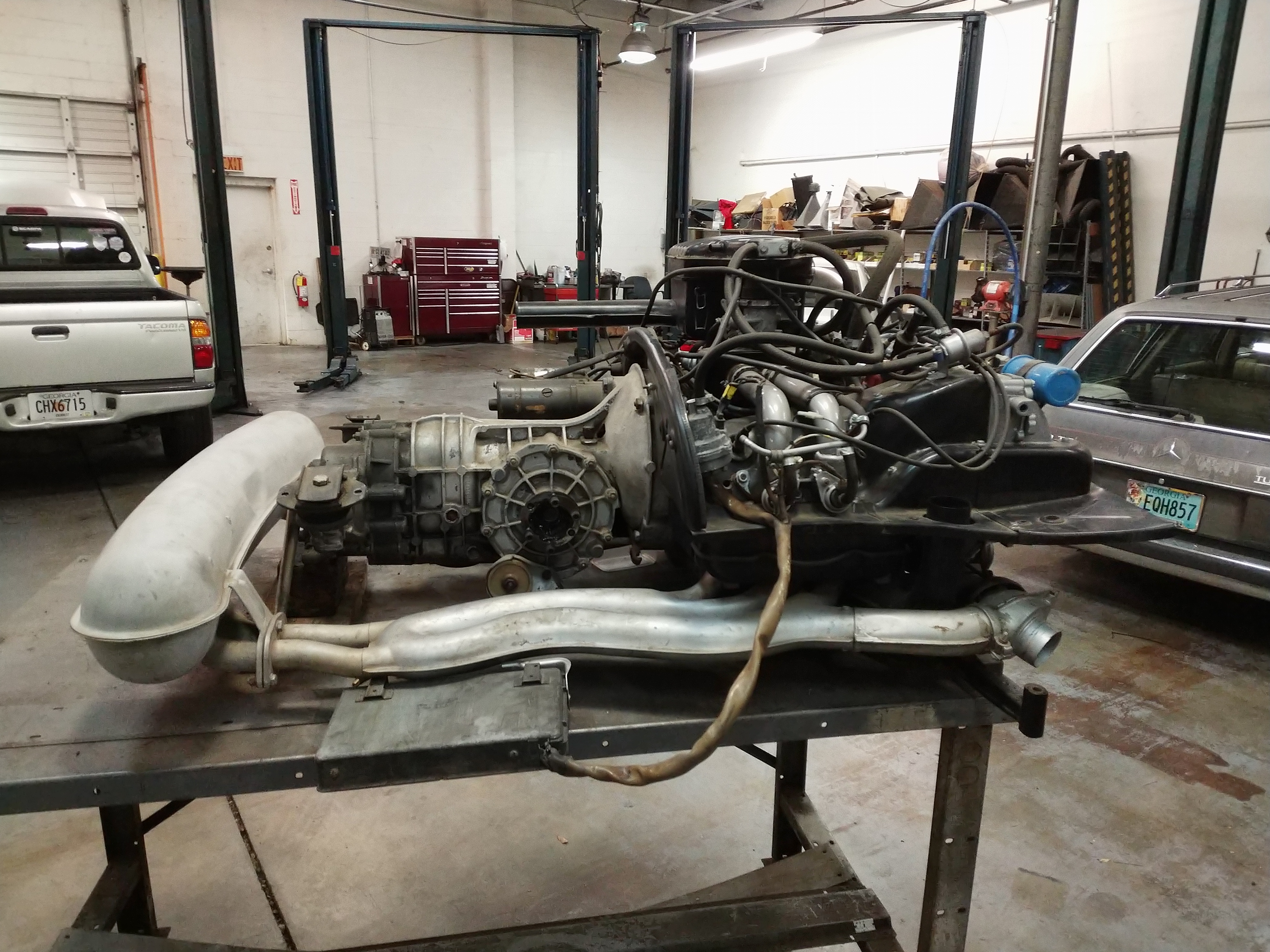

I have bought a complete rebuilt engine and transmission plus exhaust for my 914
http://www.914world.com/bbs2/index.php?sho...=343411&hl=
Jon @yostcorners
Has been extremely supportive and helpful Thank you Jon.

Asheikh   I have bought a complete rebuilt engine and transm...   Feb 12 2021, 10:27 AM
