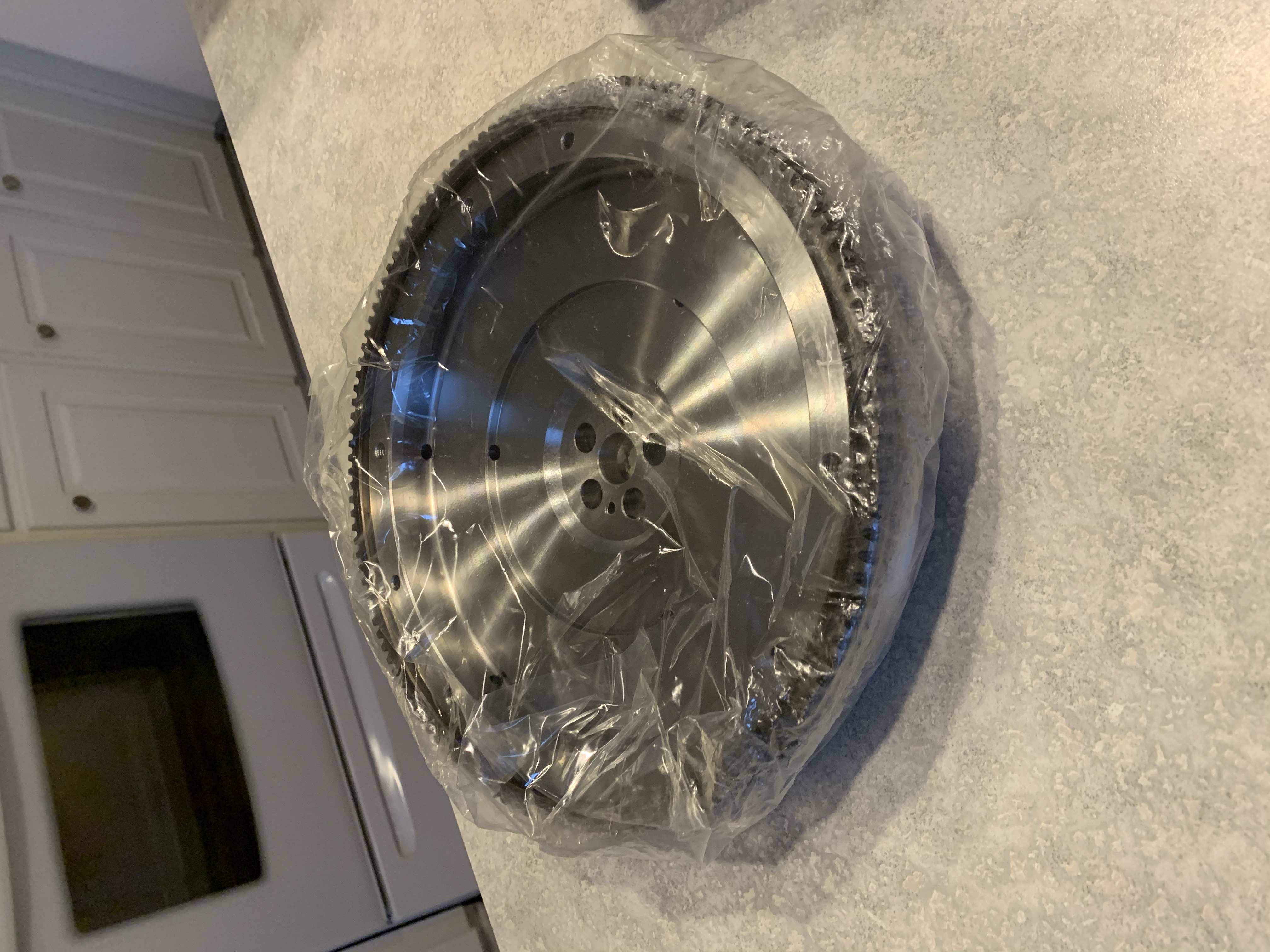

Fly wheel arrived from http://ljaircooledengines.com I was inspired by Jake to shed a few LBS.
Here is the untouched fly wheel on the lathe. It came in at a healthy 18.7 pounds before I started in on it...
https://www.youtube.com/watch?v=7BGFDnC200M

rfinegan   Fly wheel arrived from http://ljaircooledengines.c...   Feb 13 2021, 05:48 PM
rfinegan   Finished weight at just under 16 lbs. For a weight...   Feb 13 2021, 05:54 PM
