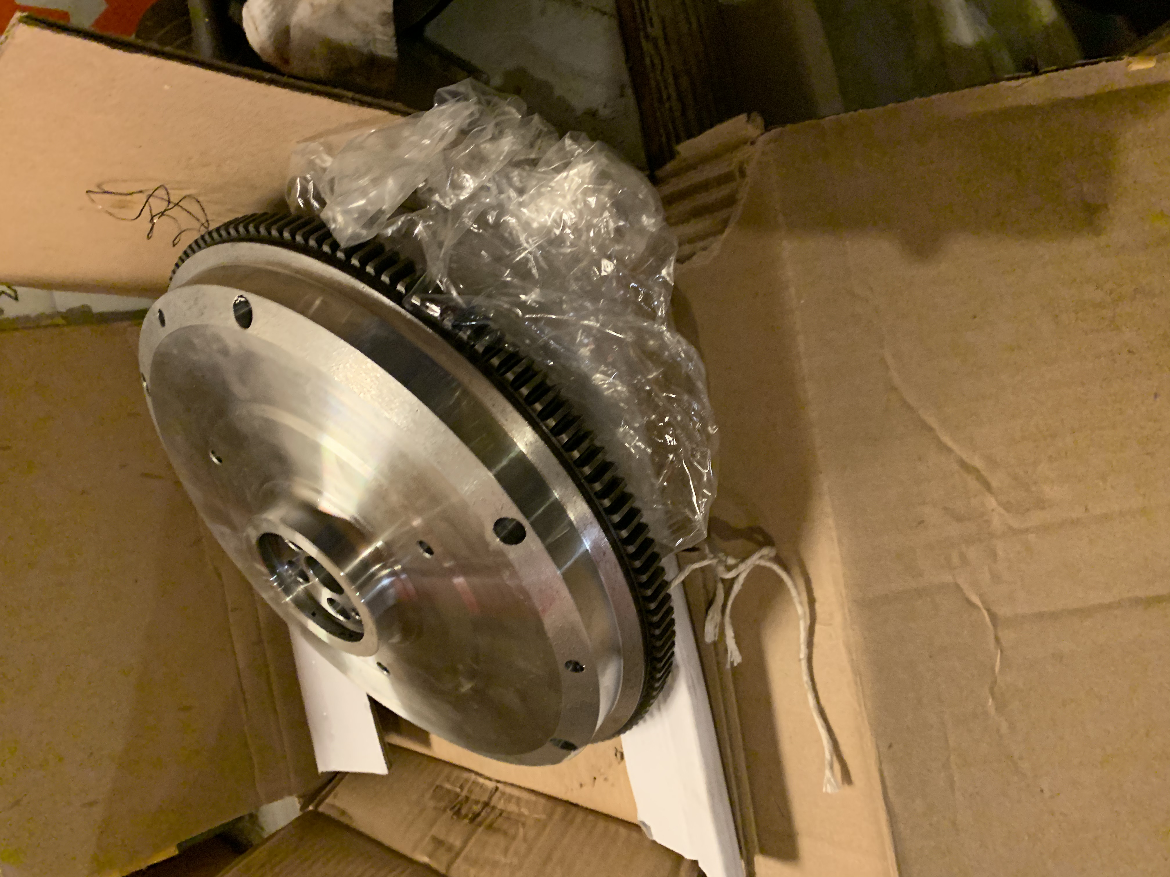

Finished weight at just under 16 lbs. For a weight savings of almost 3 pounds . Not bad for my first DIY lighten flywheel (conservative approach)

rfinegan   Fly wheel arrived from http://ljaircooledengines.c...   Feb 13 2021, 05:48 PM
rfinegan   Finished weight at just under 16 lbs. For a weight...   Feb 13 2021, 05:54 PM
