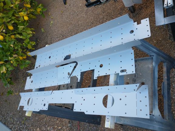

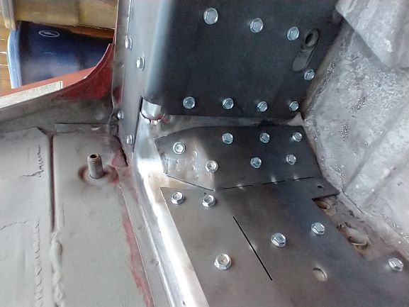

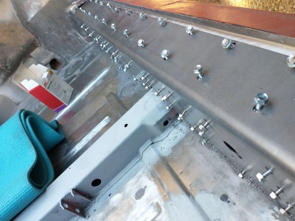

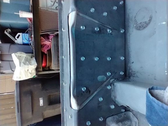

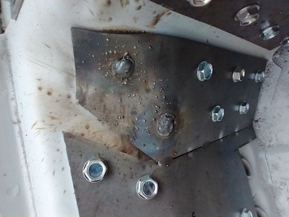

I got each and every hole filled with a screw, and did my best to fit the panels as snug as possible. My hands sure are not used to driving that many screws!
Attached ImageAttached ImageAttached Image
My AWOL order of weld-thru primer finally showed up, so I undid each and every screw. Which is a bit of a PITA as the self-tapping tip never wants to come out! For some reason this reminded me of the pincushion guy from Hellraiser!
I got the backs of the panels all primed, and primed the bare metal of the longs and lower firewall.

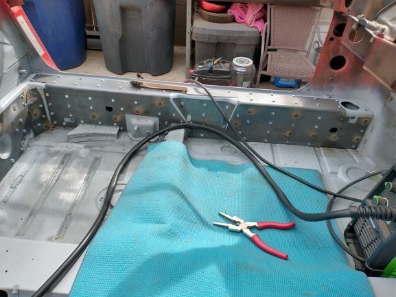

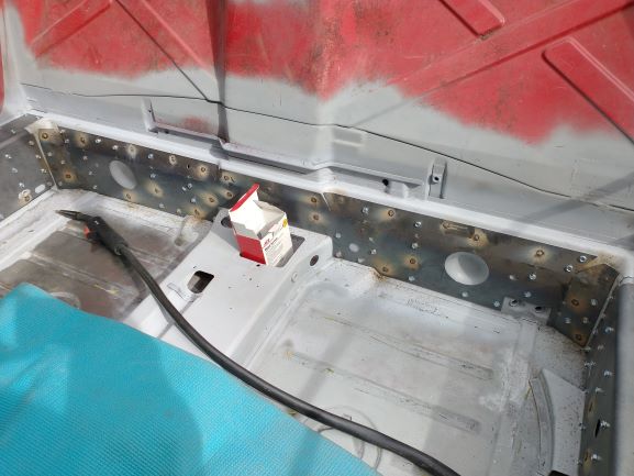

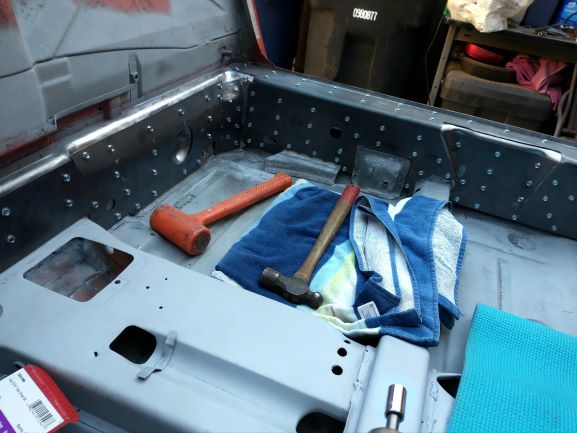

Once they were all screwed back in place, I tested my settings one more time to make sure things were good to go. I got the welder and everything I needed setup inside the car so I did not have to climb in & out any more than needed! I would take one screw out, then fill that hole with weld. Then take another screw out and weld. Then I would move to another panel on the other side of the car and repeat.
My welds are nothing to write home about, but the price is right! (IMG:style_emoticons/default/lol-2.gif)
