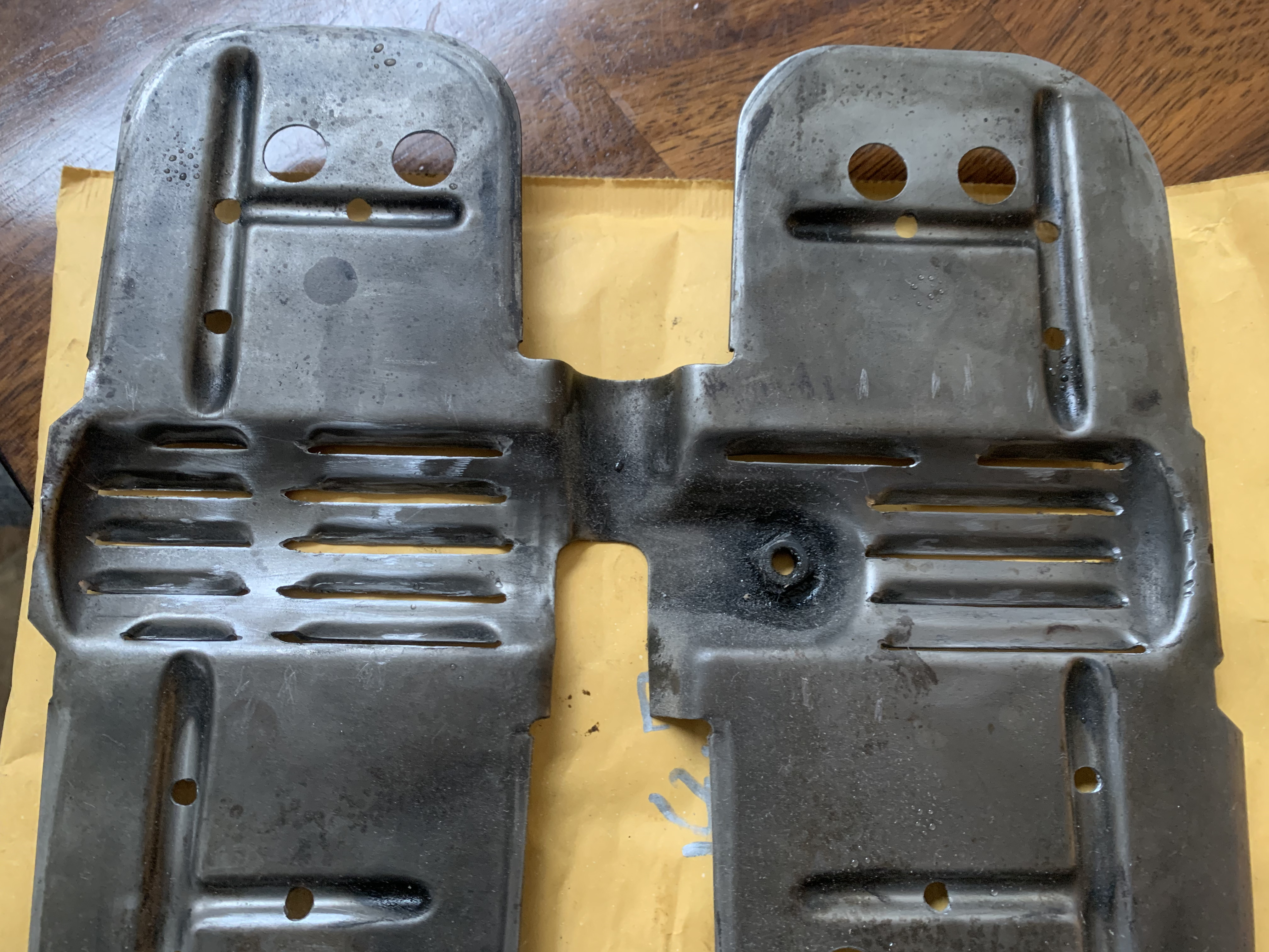

Decided to change things up a little today. I decided to modify my oil baffle/widage tray. A few guesses where to places oil returns to keep the push rod tubes and valve covers full of oil during sustained high revs and let the oil drain back a little more freely. Opened the center louvers for the same reasons. I guess there is not wrong way to do this. But some mods are better then others depending on what you are trying to improve.
Stock tray keeps the oil from sloshing pretty good , but drain back suffers with "Hi revs" . Early engine 1.7 did not have this?
Step bit
Cordless drill
Sceatch owl (to her find the locations )
Cut off wheel in die grinder
Debur tool
Polish /Buffer on angle die grinder
I may have done this different on my second Mod ..but learning here as I go...
