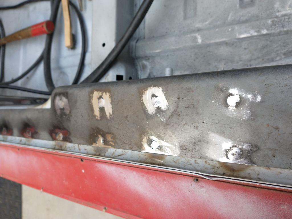

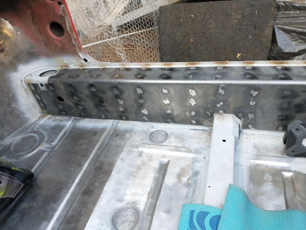

Today was mostly washing/cleaning up my truck, but I did manage to spend a couple of hours on the 914. I got all my rosette welds ground down. A few little spots here and there, but overall not to shabby for me.
Attached ImageAttached Image
I did some test welds, and tried to ensure my settings were ok, and worked on trying to stay straight! Looking a bit better... (IMG:style_emoticons/default/idea.gif)
