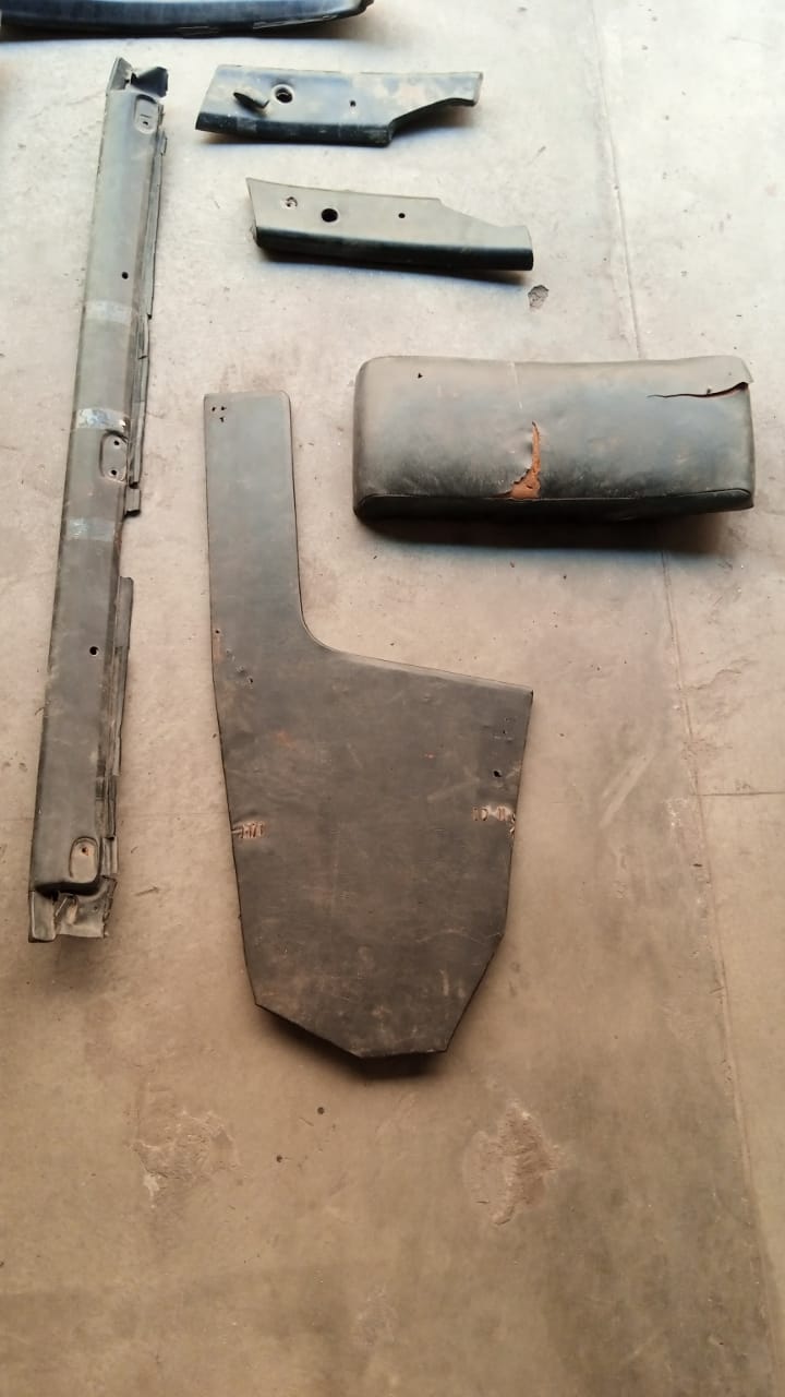

mrholland2   Why the odd boxed section it the rear trunk? Was...   Feb 11 2021, 06:43 PM
Asheikh   My older brother tried fitting in some garbage Toy...   Feb 12 2021, 10:12 AM
