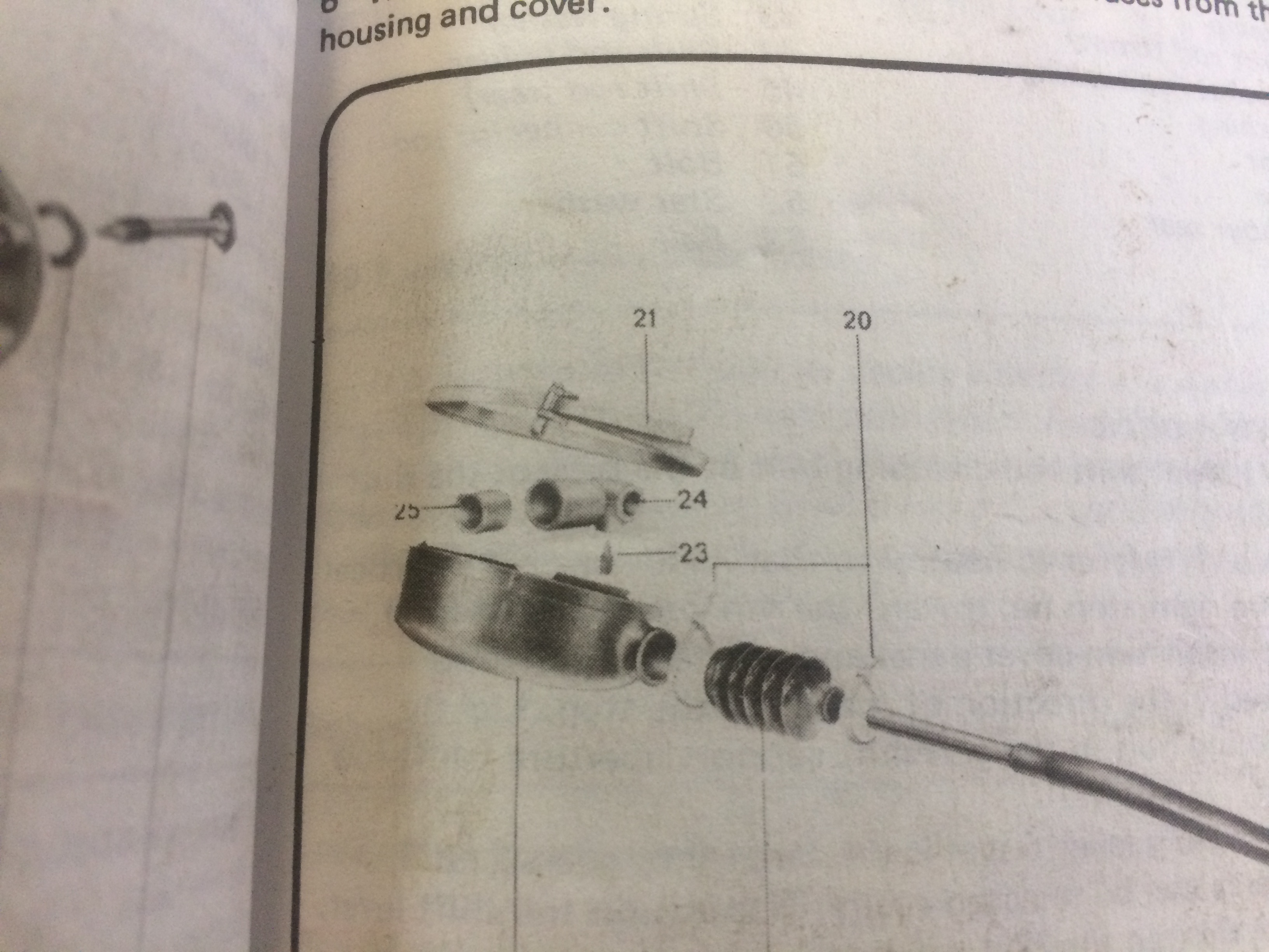

Also I’m looking for part number 4 on this picture to complete my drive train
Any help would be appreciated

burton73   Most of the 914 have clutch tube issues as it is j...   Feb 19 2021, 02:01 PM
Asheikh   Most of the 914 have clutch tube issues as it is ...   Feb 19 2021, 09:16 PM
