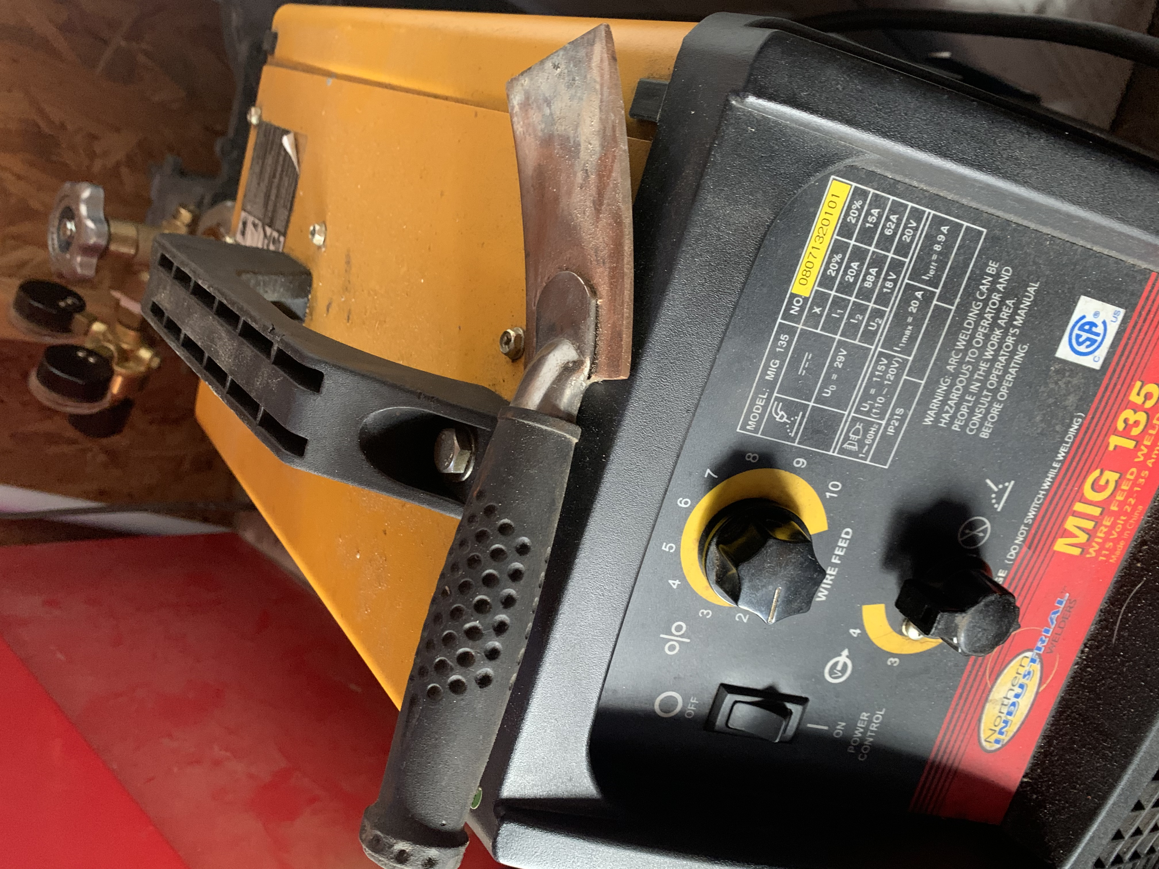

Got this a Harbor Freight for a few bucks....

Mark Henry   Take a section of copper sheet or copper pipe and ...   Feb 23 2021, 08:26 AM

Robarabian   Yes on the copper. Also, where you see the nice ri...   Feb 24 2021, 09:09 AM
rfinegan   Got this a Harbor Freight for a few bucks....   Feb 24 2021, 09:26 AM
