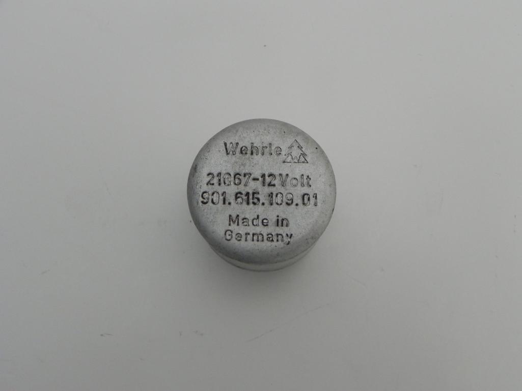

Bruce, when I mentioned other relays, I meant the following.
The 1st couple of relays I had in my spare parts box to replace the fog light relay were all bad. Finally on the 3rd try, that relay worked. When I tested the previously tried relays, they all tested bad.
So not really other relay locations if that's what you're thinking. All the same fog light relay socket.
On my 71 wiring harness, the white with blue stripe wire at terminal 85 on the fog light relay goes over and joins up with another white wire. At that point both wires are terminated jointly in a male spade that goes to terminal 56 on the "combination" relay. It is here, where I cut the white with blue wire separate from the white wire. At this point, I could just take the white with blue stripe directly to ground.
Hope that's clear.
The white with blue stripe wire that goes to the combination relay relies on you turning on the high beams. At that point, terminal 56 on the "combination" relay affectively gets grounded. With LED headlights, for some reason this does not work anymore and strange things happen.

The fogs on my 914 were not coming on. Turns out the relay had oxidized and was not making contact. I could hear the click of the relay pulling in but no contact. I cut the case open with my Dremel, cleaned the contacts and it works fine now.
Do your bad relays click when powered? Likely the contacts need cleaned and filed or sandpapered to bring them back to life.

Likely could have been that. Had plenty of spare relays to plug in, so just found one that worked. I've had much better luck with the old school aluminum case relays than the newer black plastic ones, but they are more difficult to find.

I had a couple on my '70.
