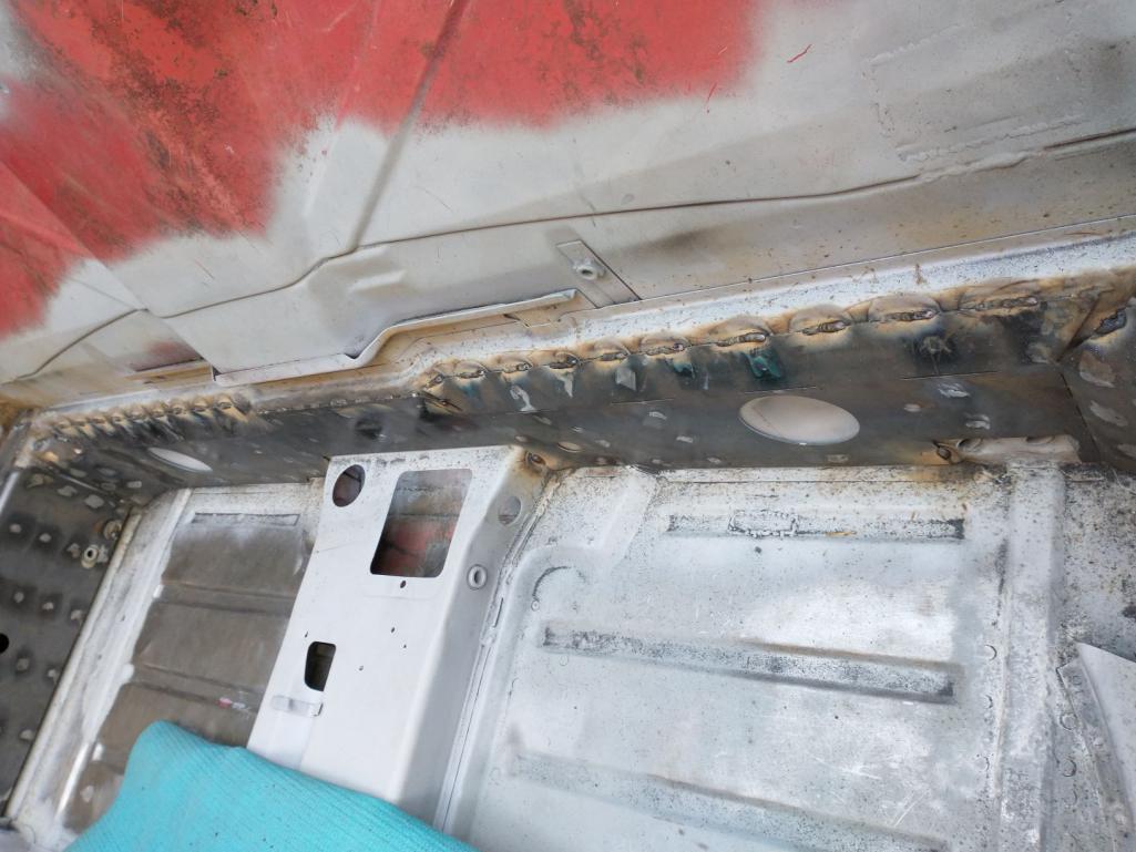

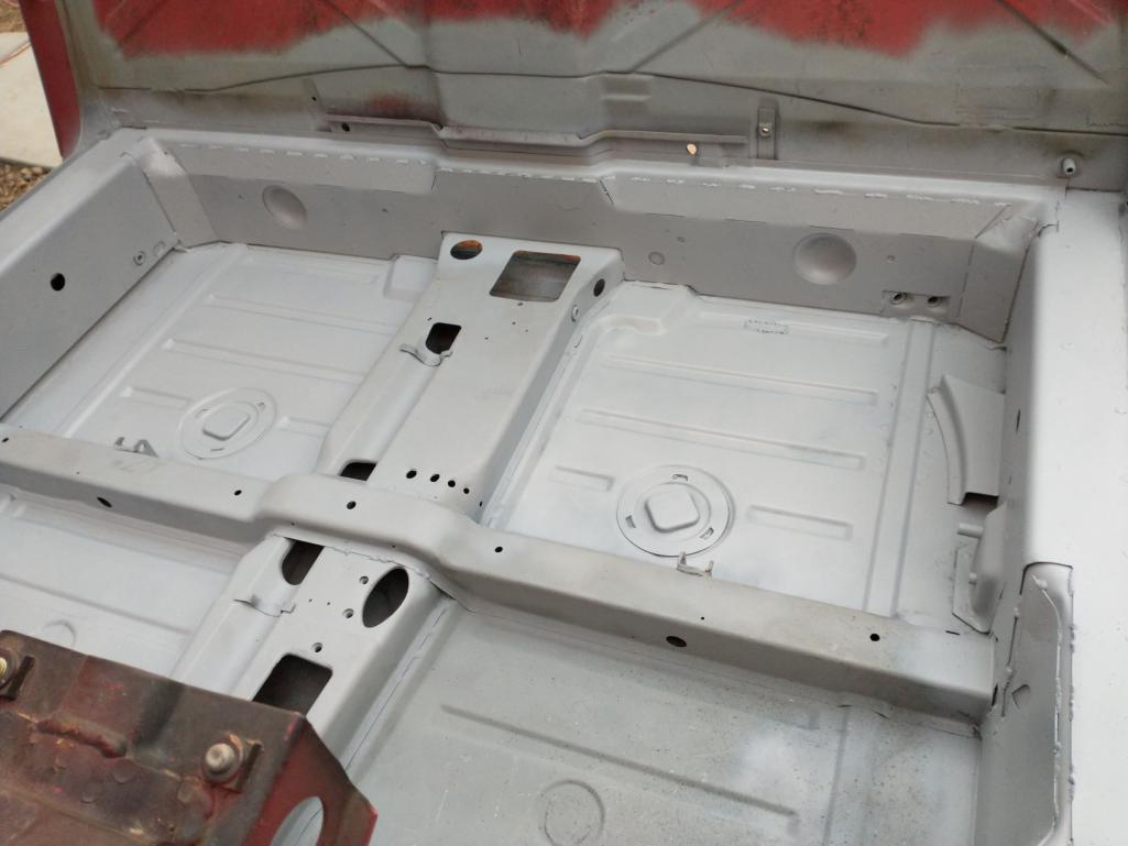

I got the panels all stitched in. Things were going better, so I figured while I was on a roll, I'd just go with it!
Welds looking better...at least for my welds! (IMG:style_emoticons/default/lol-2.gif)
Hit everything with the wire brush, vacuumed up all the debris, and coated with primer to protect it...
seanpaulmc
post Feb 18 2021, 07:55 PM
Posts: 465
Joined: 6-December 16
From: Orlando, FL
Member No.: 20,649
Great job!!! (IMG:style_emoticons/default/piratenanner.gif)
Is there any stich welding on the bottom at the floor pan?
Curious if this kit can be installed before doing floor pan replacement.
Thanks,
Sean

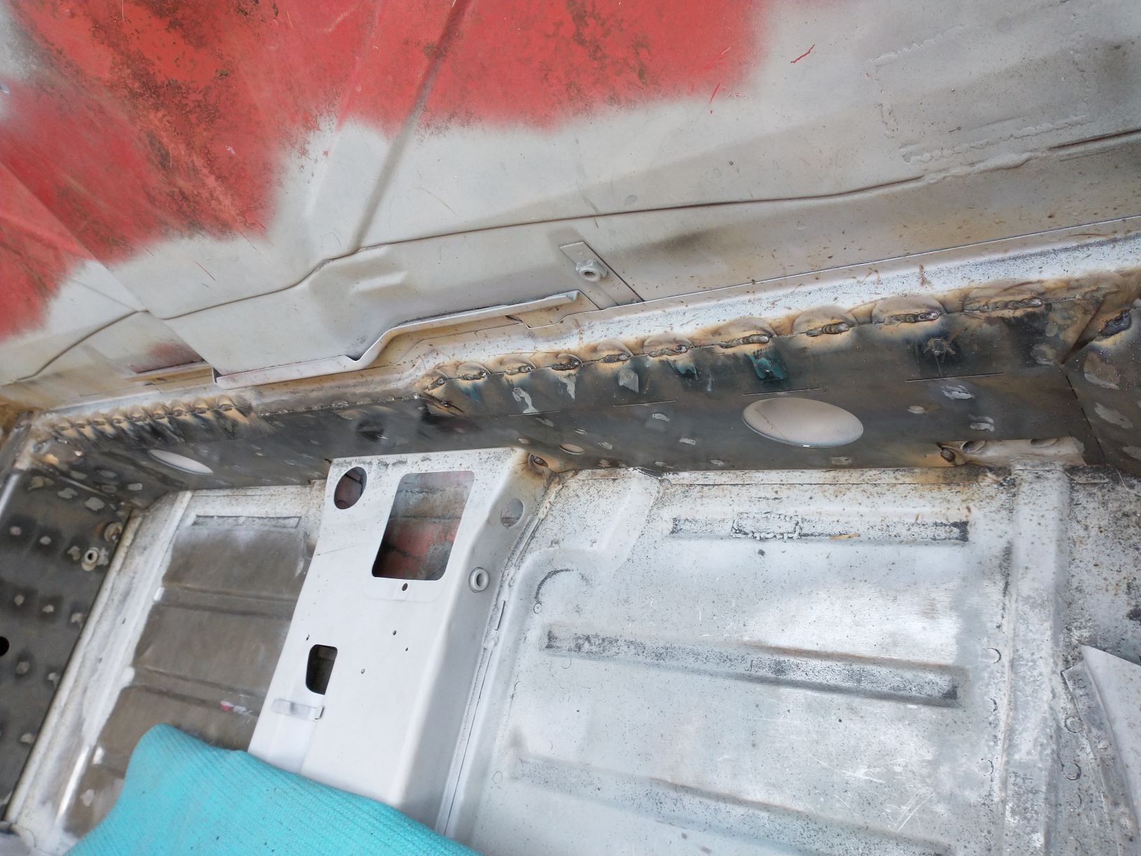

QUOTE(mgarrison @ Feb 18 2021, 08:39 PM) *
mgarrison

QUOTE(seanpaulmc @ Feb 18 2021, 06:55 PM) *
Thanks,
Sean
I did not do any stitch welds along the bottom. Since the longs are curved at the bottom, they pull away from the new panels. Not sure how you would weld down in there, and the stiffening panels do not go all the way down to the floor pan.
