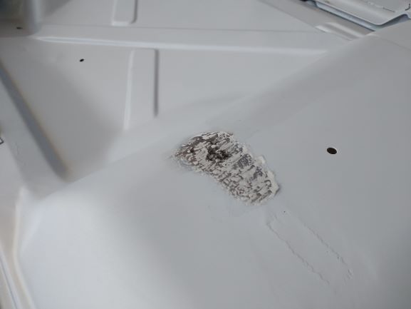

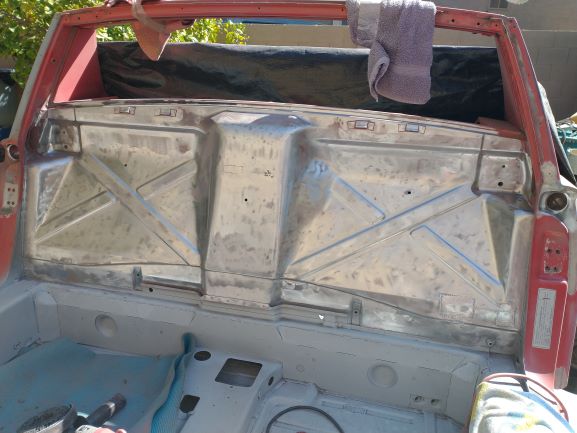

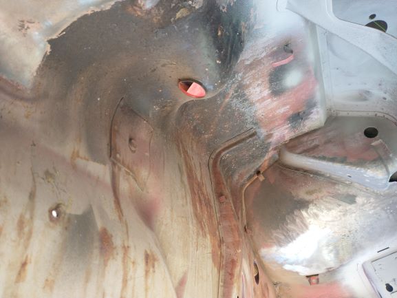

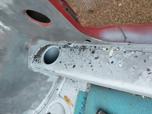

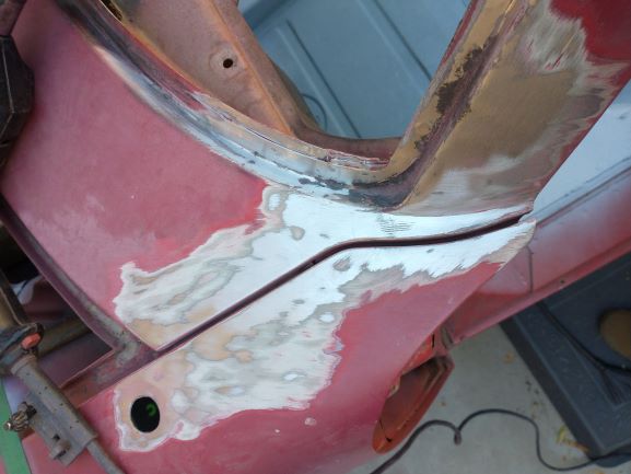

Still just trying to keep moving forward. Inch by slow inch...
Trying to get the interior of the chassis all wire brushed, any rust I find treated, and then a quick coat of primer to protect it. With all the little nooks & crannies I think doing the flares and the outside might seem easier! Still have the frunk to finish up!
I found some surface rust under the dash - seems like a really odd place to rust, especially on an Arizona car!
Not too terrible after cleanup.
Some more surface rust on the firewall, but not much!

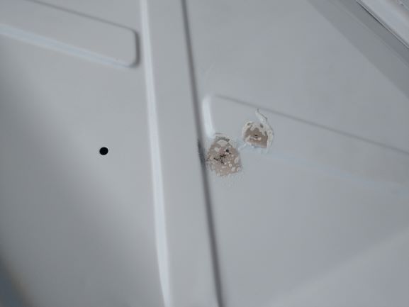

I actually forgot to treat the two spots on the firewall before priming, so I looked back at the above photo and hit the right areas with the wire brush so I could treat them. Just try to ignore my amateur patch on the left there! (IMG:style_emoticons/default/confused24.gif)
There was some odd, crunchy sealer just in front of the doors under the dash. Very different stuff from the other seam sealer!
I tried to check all the problem areas to uncover any rust. The usual spots look really good!

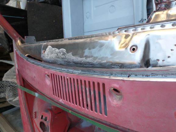

There was a bit of rust in the windshield channel, especially at the two bottom corners. Did my best to wire brush it and then treated it too.
The shop vac is seeing daily use, and getting quite the workout sucking up all the paint dust, rust, and metal shavings! (IMG:style_emoticons/default/blink.gif)
