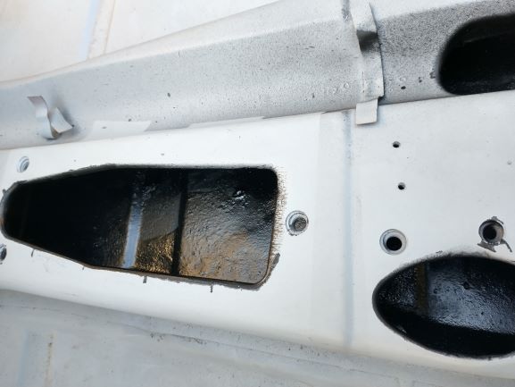

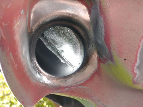

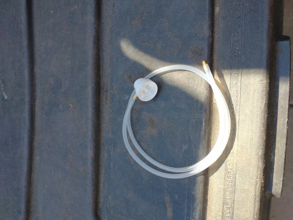

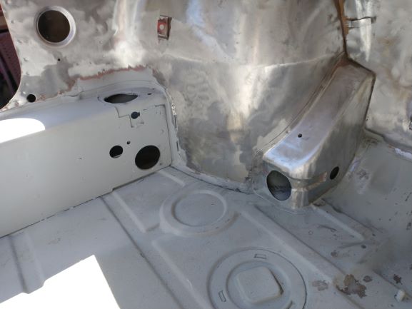

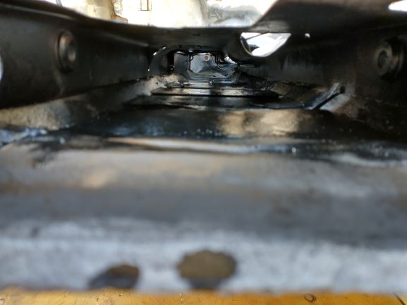

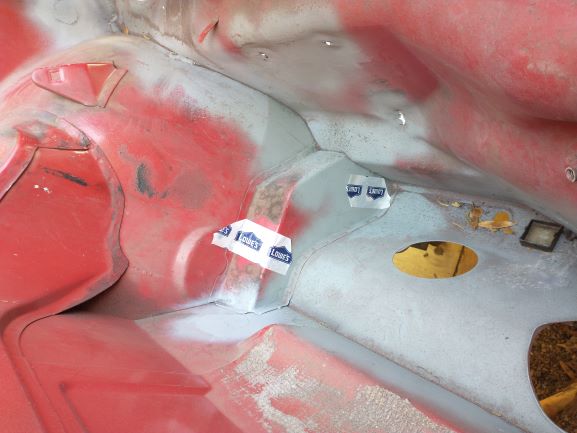

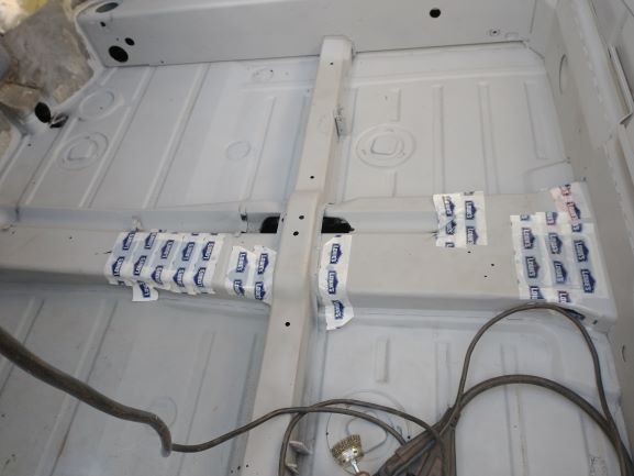

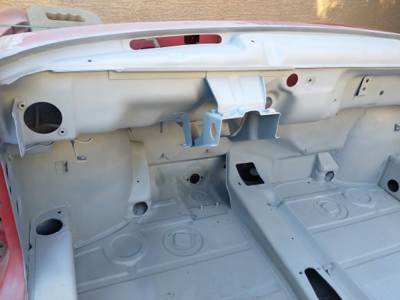

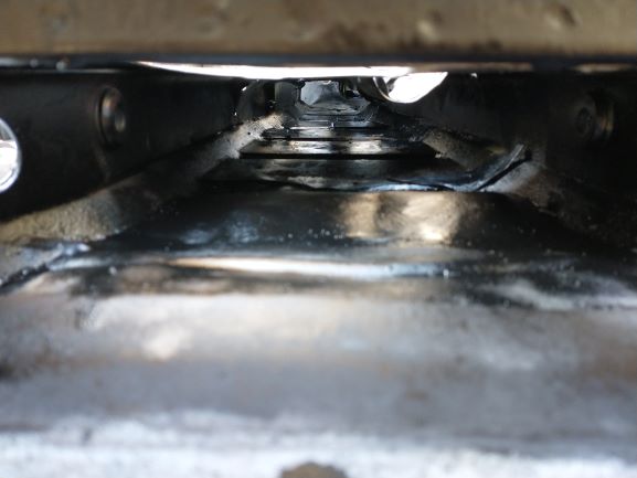

I wire brushed the vent holes as best I could and then coated them with the Eastwood internal frame coating. Should keep them from rusting, etc.

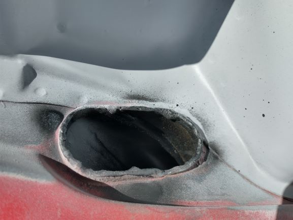

I drilled out the holes for the coolant lines through the longs. Took a deep breath before drilling through the panels I had just welded in!
I taped over the smaller holes in the "ducts" where I will run the coolant lines to the frunk, and most of the holes in the center tunnel so I could spray the internal frame coating without getting it in my face...
Still got some on my boots though...That's not coming off!

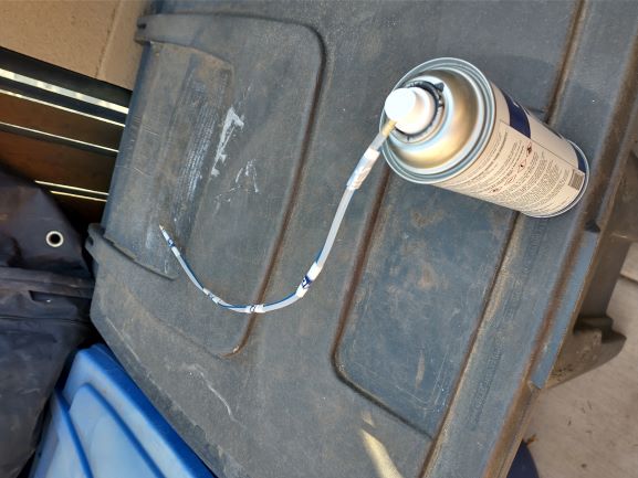

Here's the tube & nozzle it comes with. I taped the tube to a section of coat hanger to keep it straight, and to be able to aim it a bit better.
Stuff seems to work rather well, but it does make a mess, and is thin enough to drip out the bottom of the chassis (how it got on my boots).

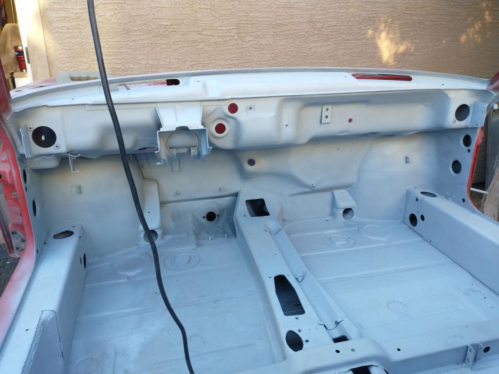

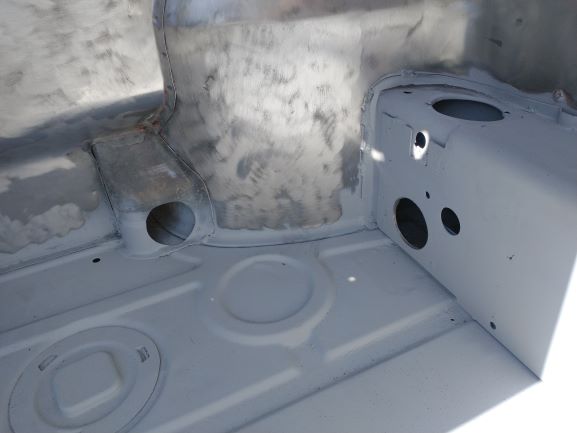

Shot the dash support with some primer, and tried to catch all the other areas I had stripped so they are protected.
On/back to the frunk! (IMG:style_emoticons/default/piratenanner.gif)
