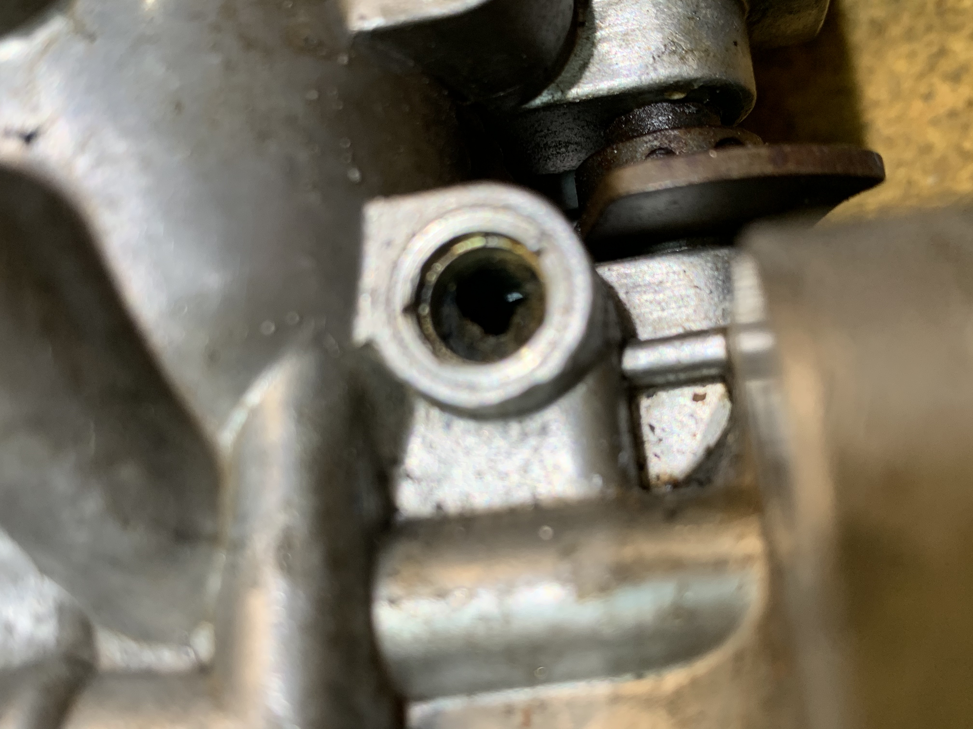

Tonight i decided to pull down the Old Weber 44 IDFs and get them cleaned up (rebuilt) before they are needed. Pretty standard results and dried gas. I decided to pull the lead Gallery plugs, which are prone to leaking and drill tap and seal the plug holes with 8mmx1.0x5mm fine set screws. (smaller metric plugs require less material removal before tapping)
@VaccaRabite did a fine write up on this here: http://www.914world.com/bbs2/lofiversion/i...hp?t133490.html
I am very happy I decided upon this course of action as I found all kinds of solids in one in the wells/galleys Here:

rfinegan   Tonight i decided to pull down the Old Weber 44 ID...   Mar 4 2021, 06:29 PM
rfinegan   other carb Solids are seen in both holes here too....   Mar 4 2021, 06:31 PM
rfinegan   a better shot of the plugs hole   Mar 4 2021, 06:42 PM
