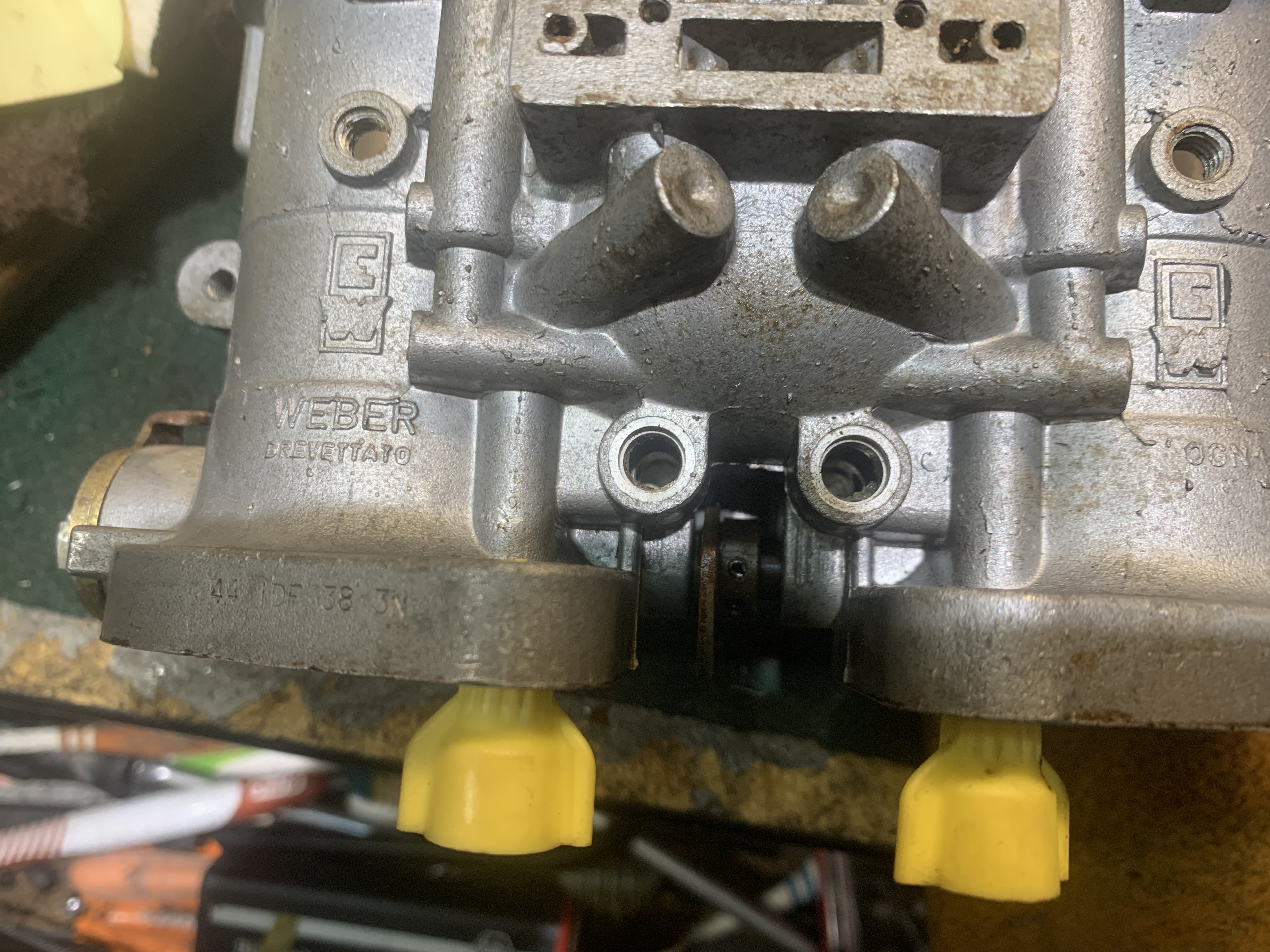

rfinegan   Tonight i decided to pull down the Old Weber 44 ID...   Mar 4 2021, 06:29 PM
rfinegan   other carb Solids are seen in both holes here too....   Mar 4 2021, 06:31 PM
rfinegan   a better shot of the plugs hole   Mar 4 2021, 06:42 PM
