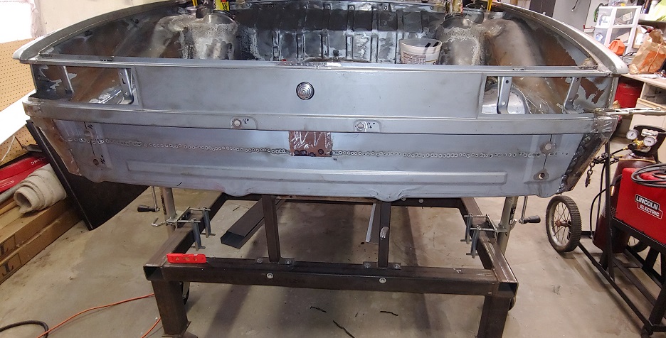

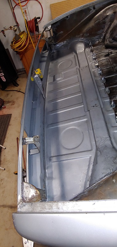

Worked on the rear trunk pan today. The spot welder worked great and best of all no grinding to do.

Luke M   Worked on the rear trunk pan today. The spot welde...   Mar 13 2021, 05:45 PM
Root_Werks   I really like the spot welder you are using. Yes,...   Mar 16 2021, 05:13 PM
Luke M   I really like the spot welder you are using. Yes...   Mar 16 2021, 06:18 PM
