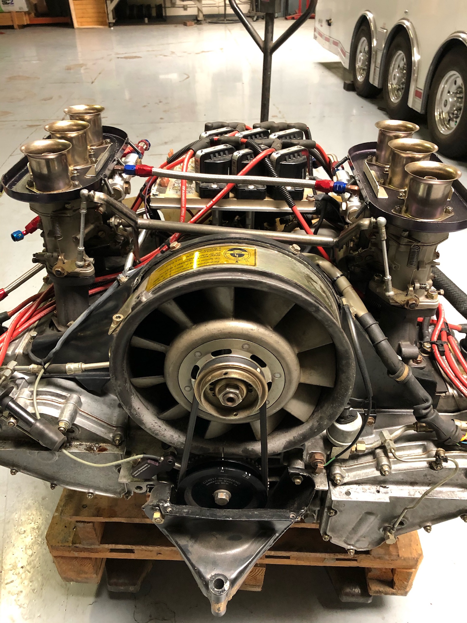

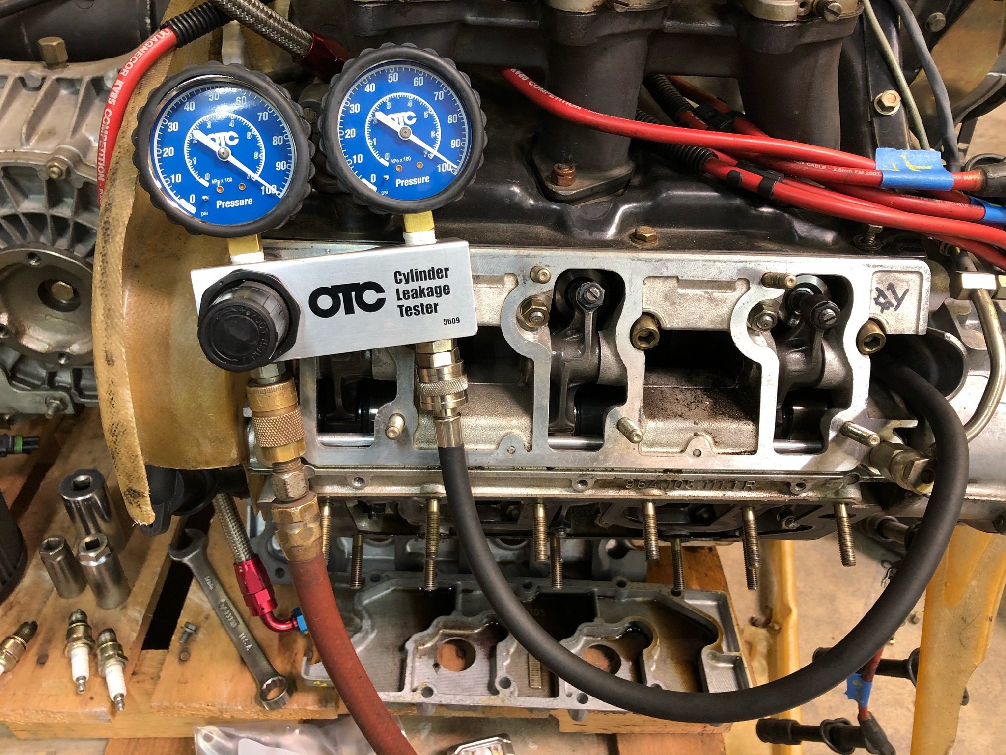

Who would have thought spark plugs would be on back order... yanked the motor, did the valves, spot on, took a look inside, I think I still see assembly lube... how many miles are on this engine???
Decided to do a leak down test as well... at 70, 90, and 100 psi I got less than 1% leak down on all cylinders (IMG:style_emoticons/default/cheer.gif) (IMG:style_emoticons/default/cheer.gif) (IMG:style_emoticons/default/cheer.gif) this thing is near new!
Ordered valve cover seals, will button her back up.
