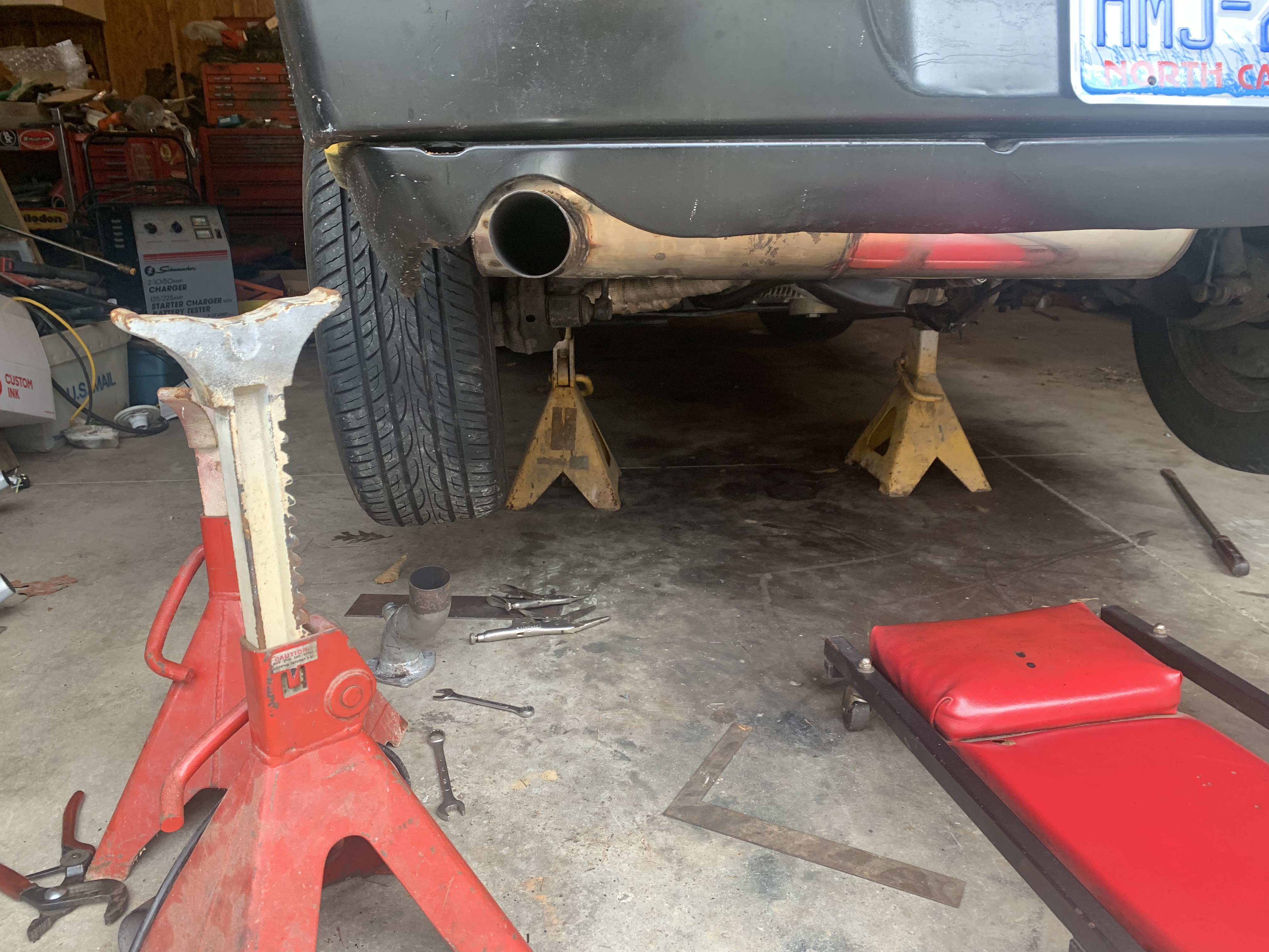

This week was fabrication work: 2 1/8 exhaust pipe
I recently picked up a Pete weber 4-2-1 quiet Horsepower Header( looks a lot like an early Tangerine super header). I had the Evo II muffler with the Kerry hunter header.
But the KH is 1.5 in primary and the 2056 needs to breathe deep. The 4-2-1 is 1 5/8 primary and has stub pipes! The Outlet is 2 1/8. So I had to make the transition pipe to the muffler and add an O2 bung after the last collector.
Its tack welded together and will get the TIG torch out over the week end
