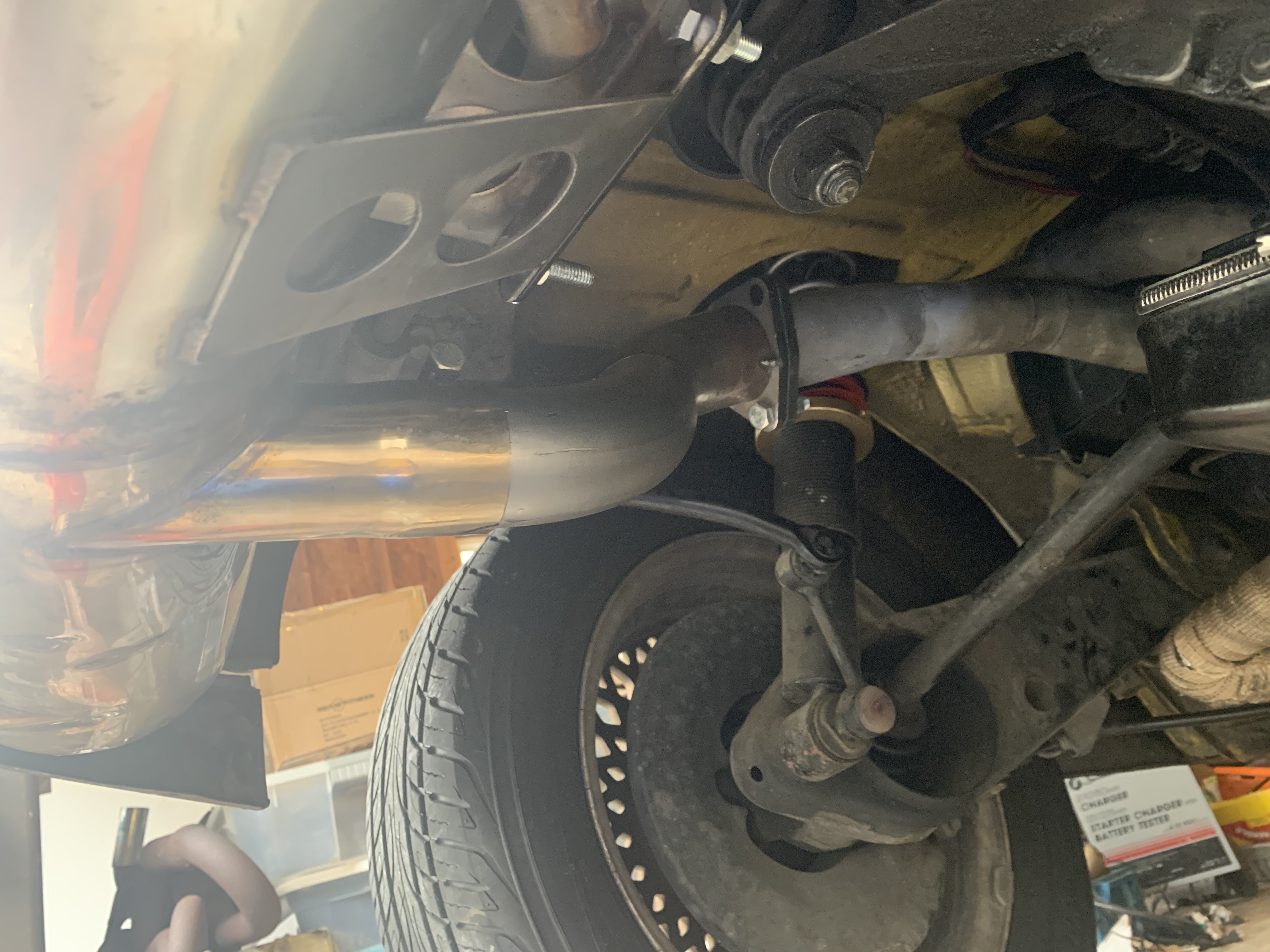

rfinegan   This week was fabrication work: 2 1/8 exhaust pipe...   Mar 18 2021, 03:55 PM
rfinegan   another view   Mar 18 2021, 03:56 PM
rfinegan   Sound clip LhNNEG_Mi6A   Mar 18 2021, 03:57 PM
rfinegan   forgot the shot of the pipe   Mar 18 2021, 04:14 PM
