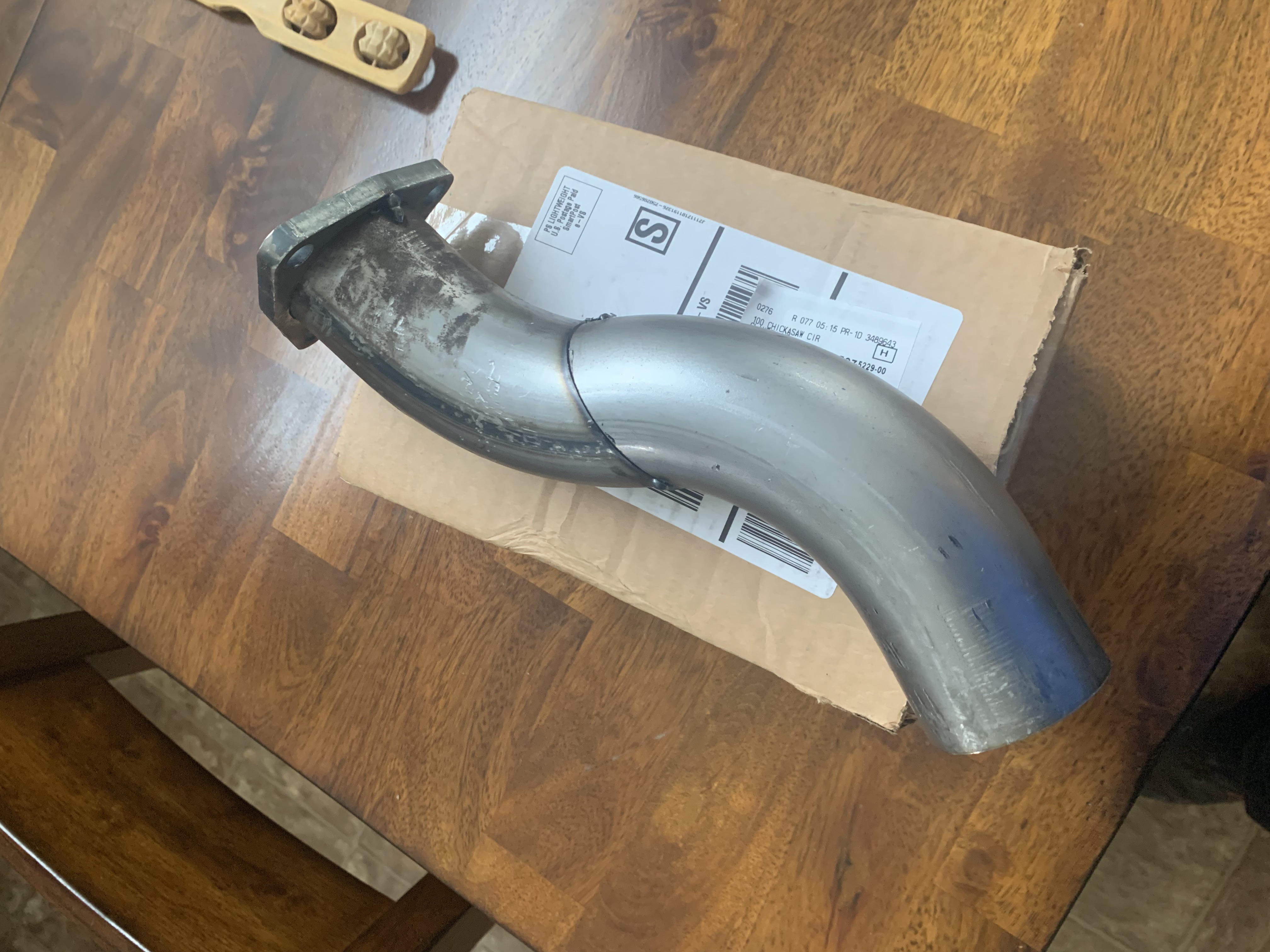

rfinegan   This week was fabrication work: 2 1/8 exhaust pipe...   Mar 18 2021, 03:55 PM

rfinegan   forgot the shot of the pipe   Mar 18 2021, 04:14 PM
