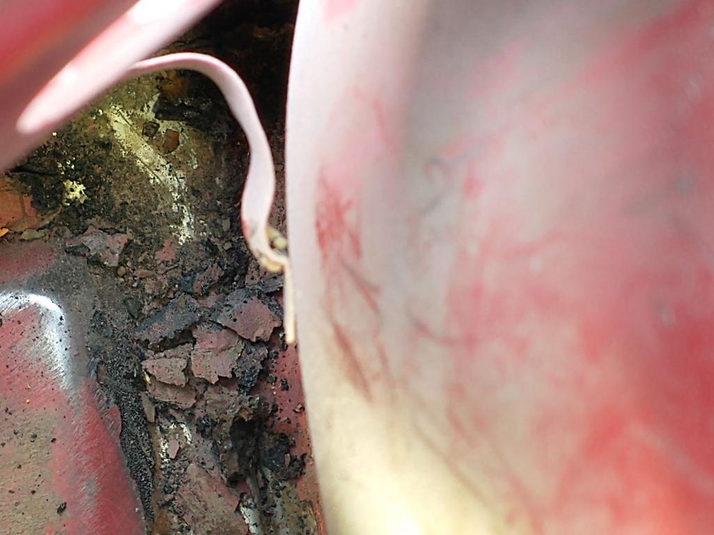

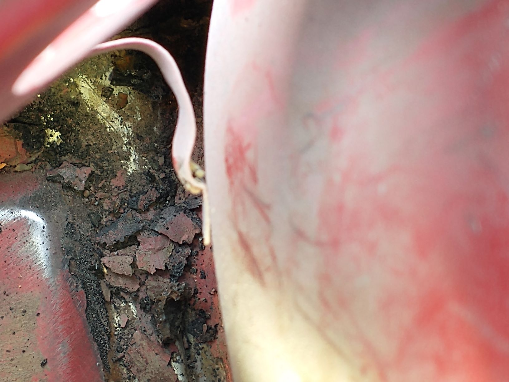

I see why there is not much paint or primer in the area under the head light buckets...HTH do you get in there???

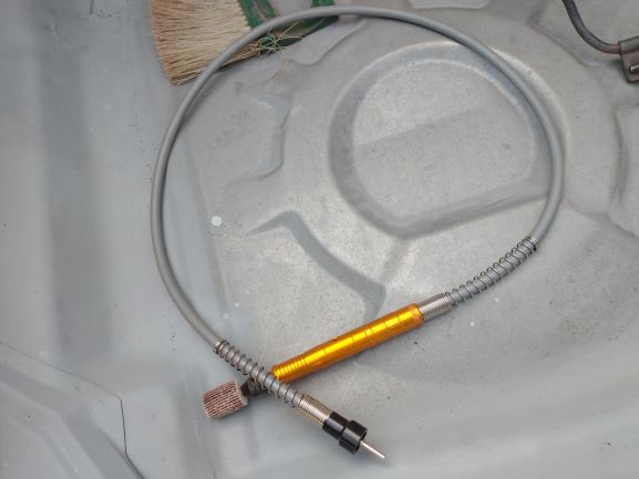

I ordered this extension from Amazon, but it only takes a 1/8" shank, so very limited options other than Dremel ends.
It kind of works, but not very well. I tried using it to get down in the corners of the fender well where it disappears behind the headlight bucket.

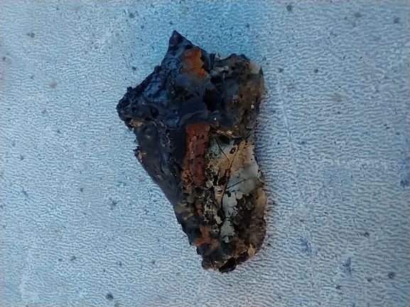

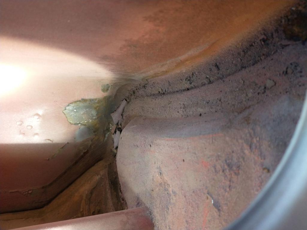

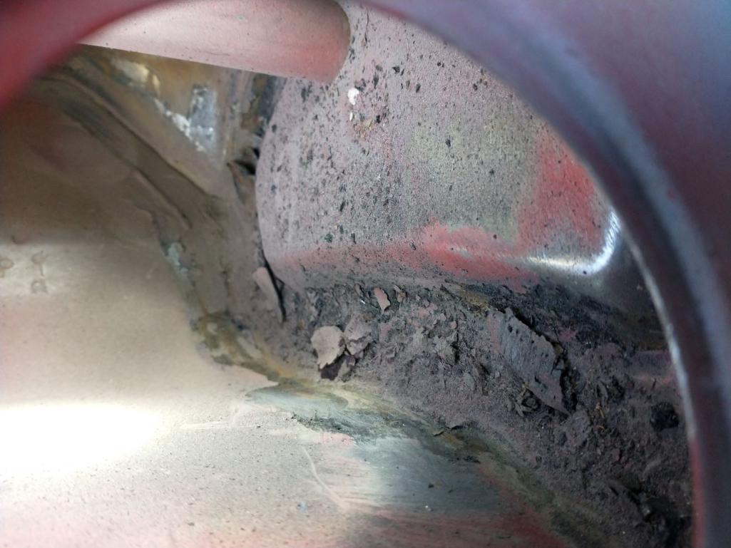

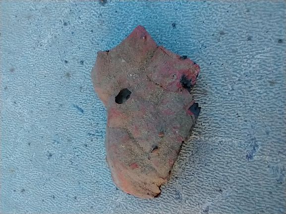

The area under the headlight buckets had a bit of surface rust, but not bad. The "seam sealer" they used in this area was very different from the rest. It is dark and had hardened up to a brittle, charcoal like substance!
Quite a bit chipped off rather easily:
Here's a closeup of a big chunk, odd stuff:

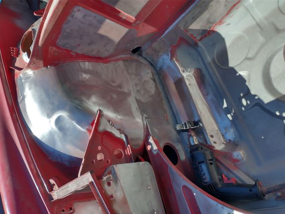

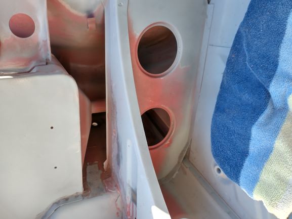

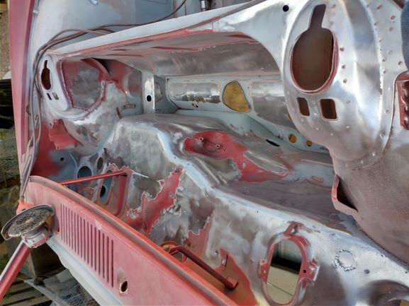

I moved over to the area under the gas tank. I needed to feel like I was making some progress/difference...needed to see some kind of change!
Attached Image (IMG:style_emoticons/default/headbang.gif)
