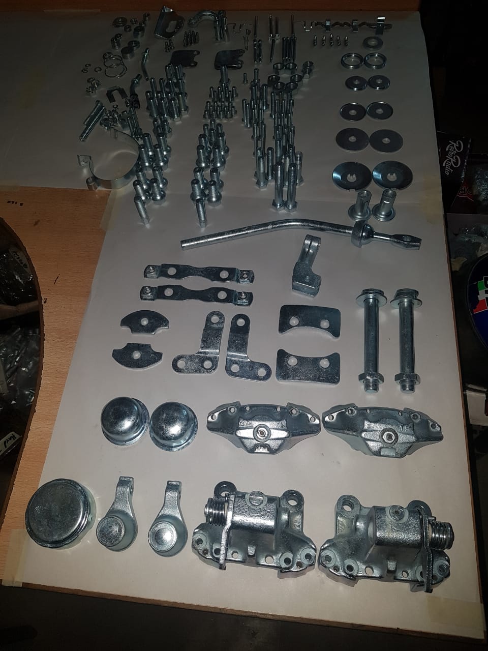

Asheikh   Going to send all the following parts for powder c...   Feb 10 2021, 05:14 AM

Asheikh   My elephant racing 914 suspension Restoration kit ...   Feb 19 2021, 08:04 AM

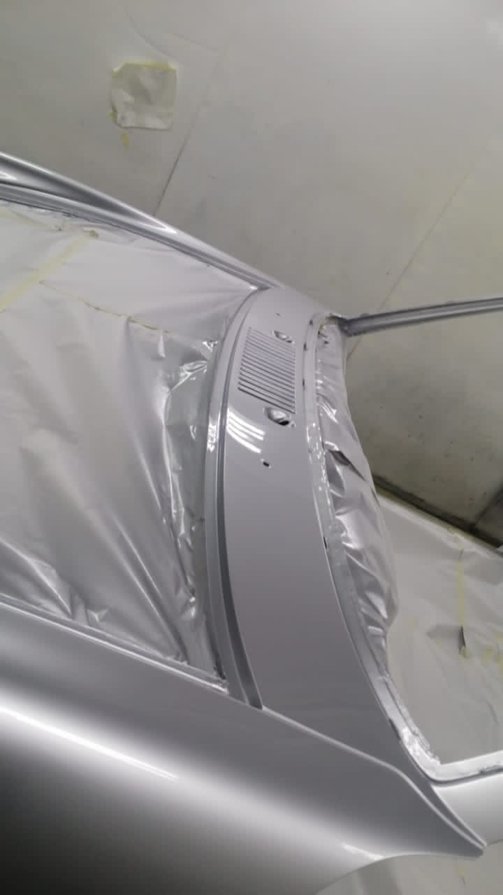

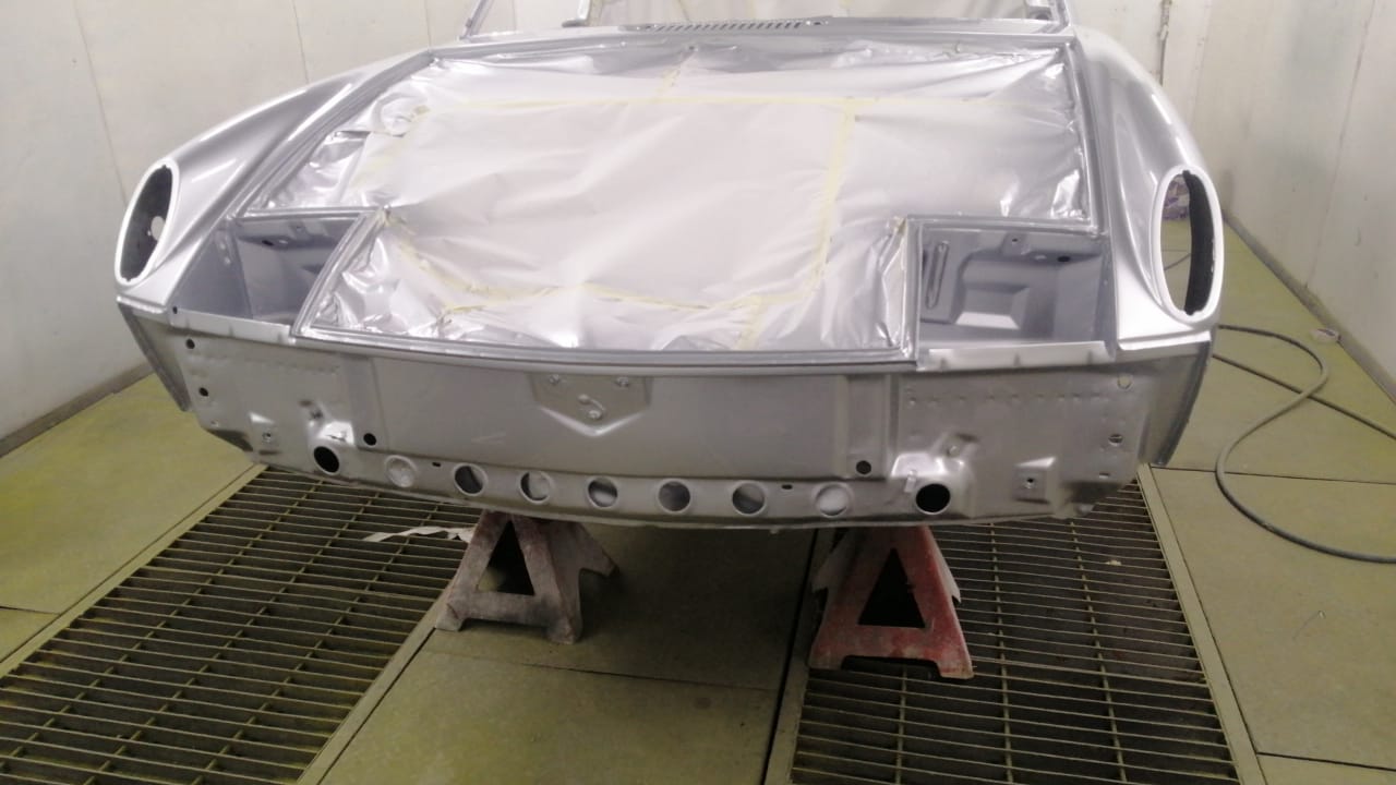

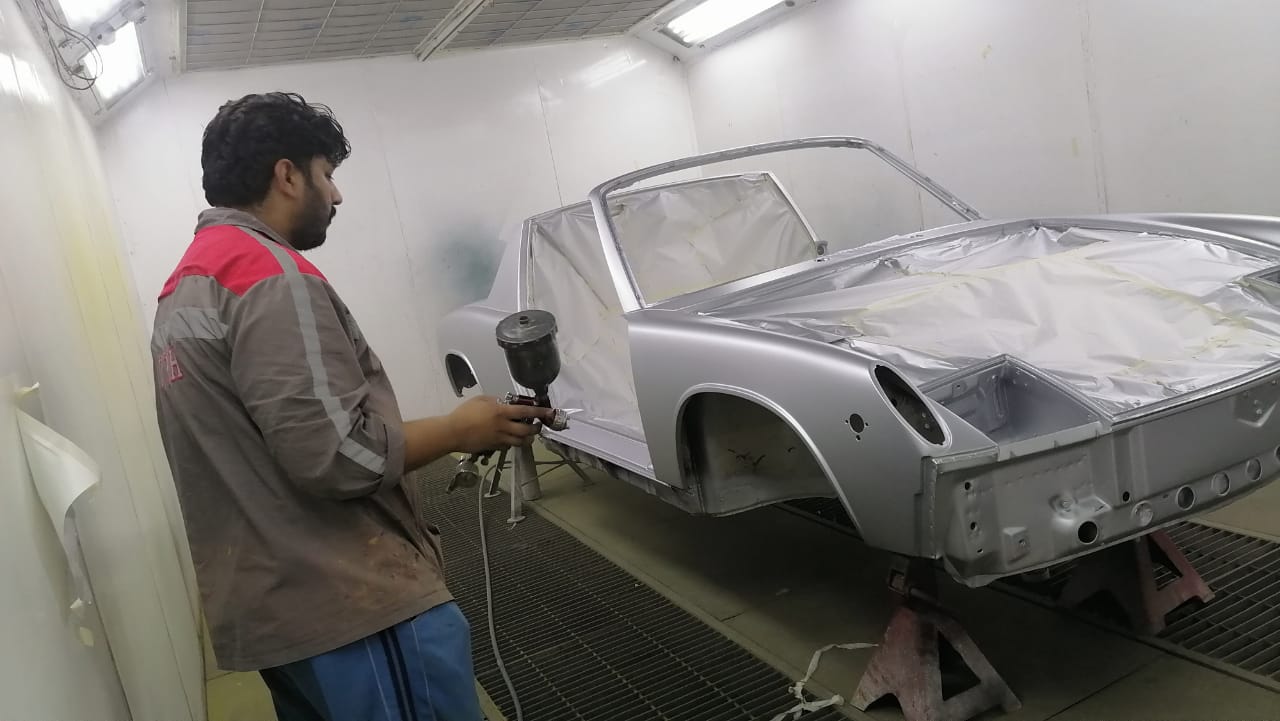

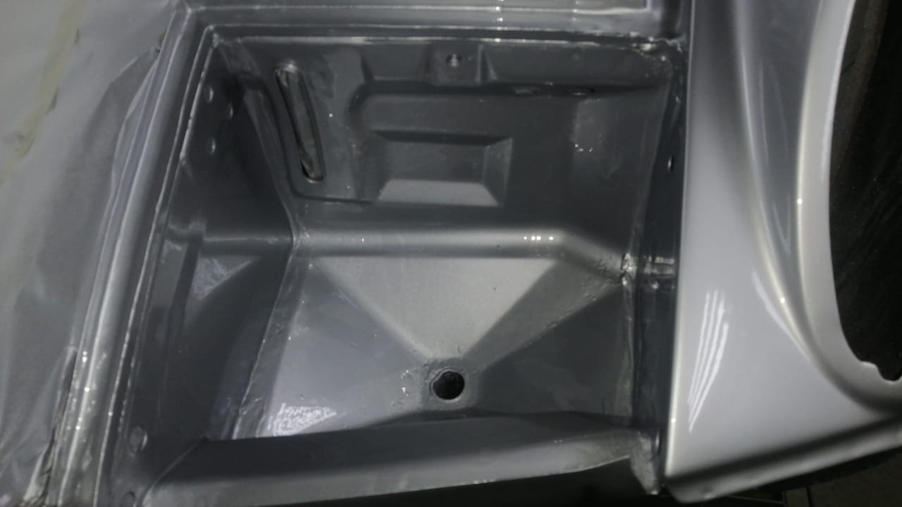

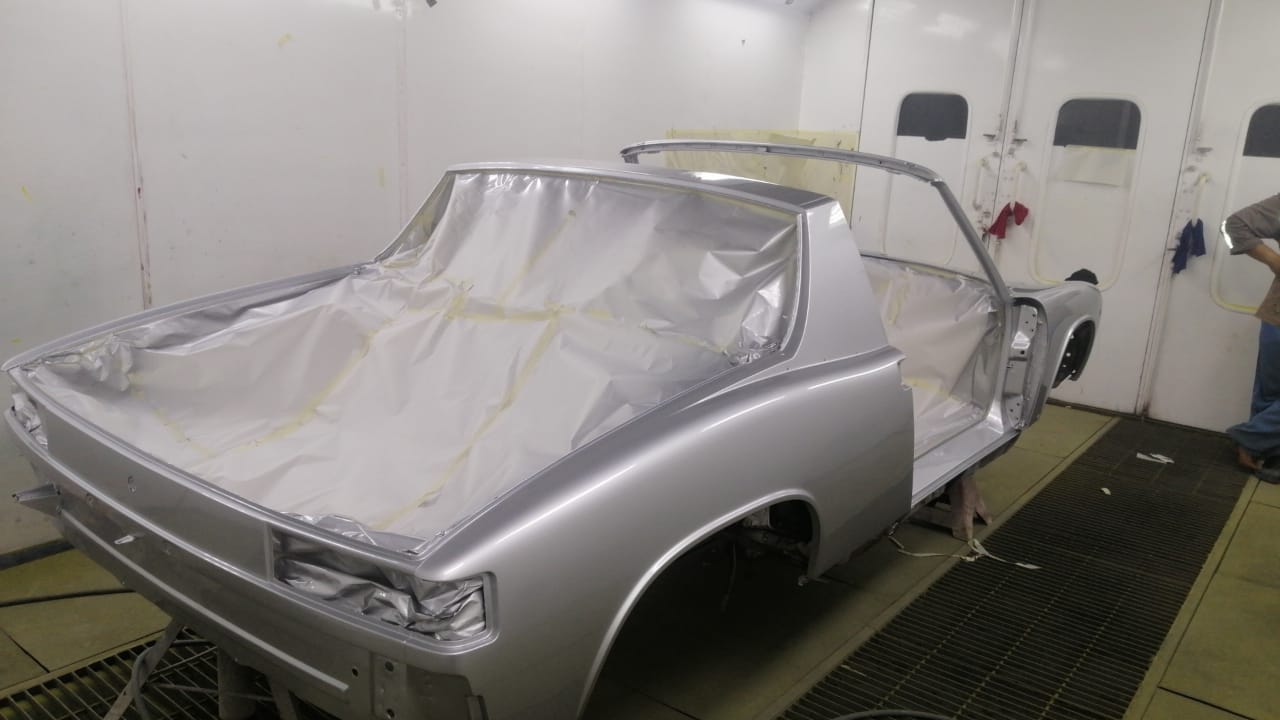

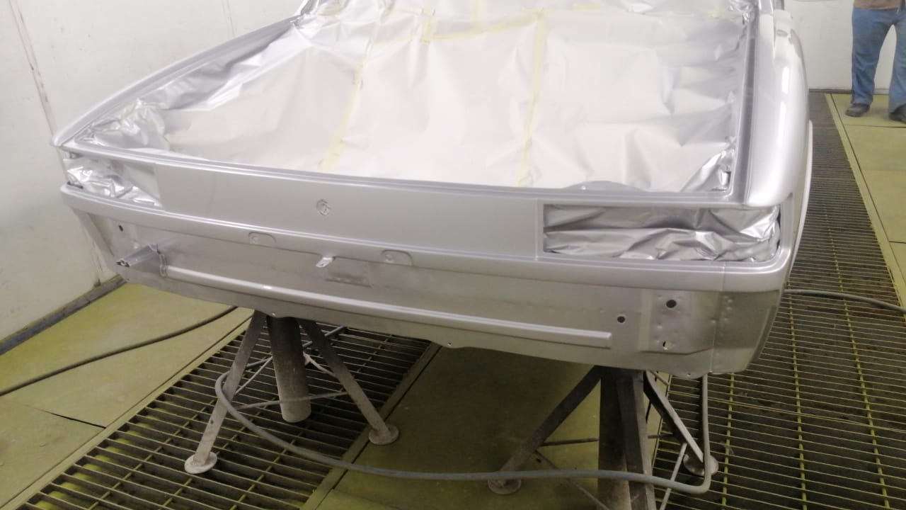

Asheikh   Some pics to make up for the late update   Mar 23 2021, 09:33 AM
FlacaProductions   That's some good work - nice progress!   Mar 23 2021, 09:35 AM

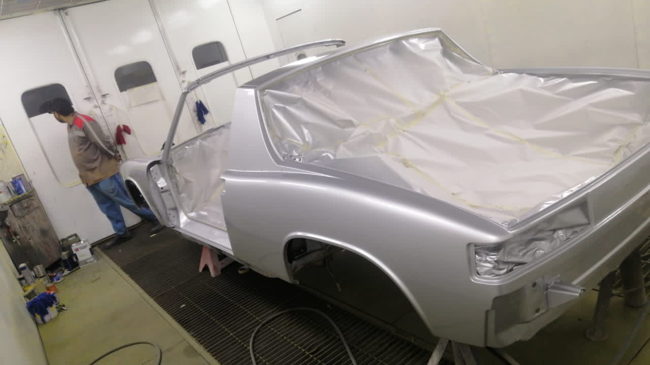

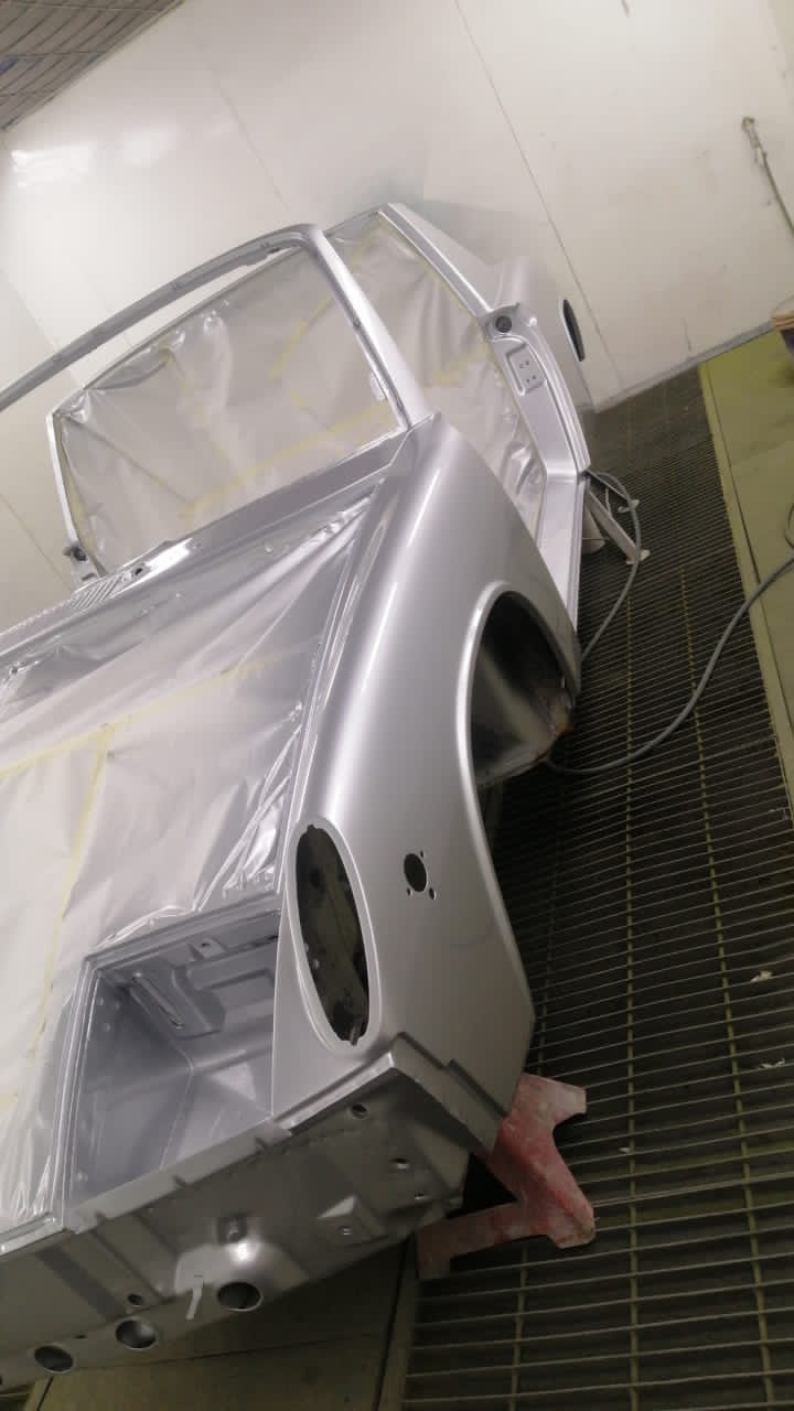

Asheikh   And more   Mar 23 2021, 09:43 AM
kroelofsen   :Qarl: That is really nice work! A 914 must b...   Mar 23 2021, 10:50 AM
