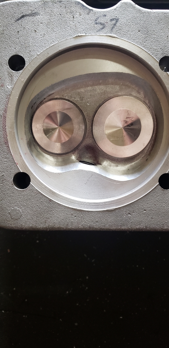

Heads: Started life as 1.8 heads
Here is a pic from the machinist of the new chamber with 44 x38 valves and 57 CC cambers
More when they arrive
