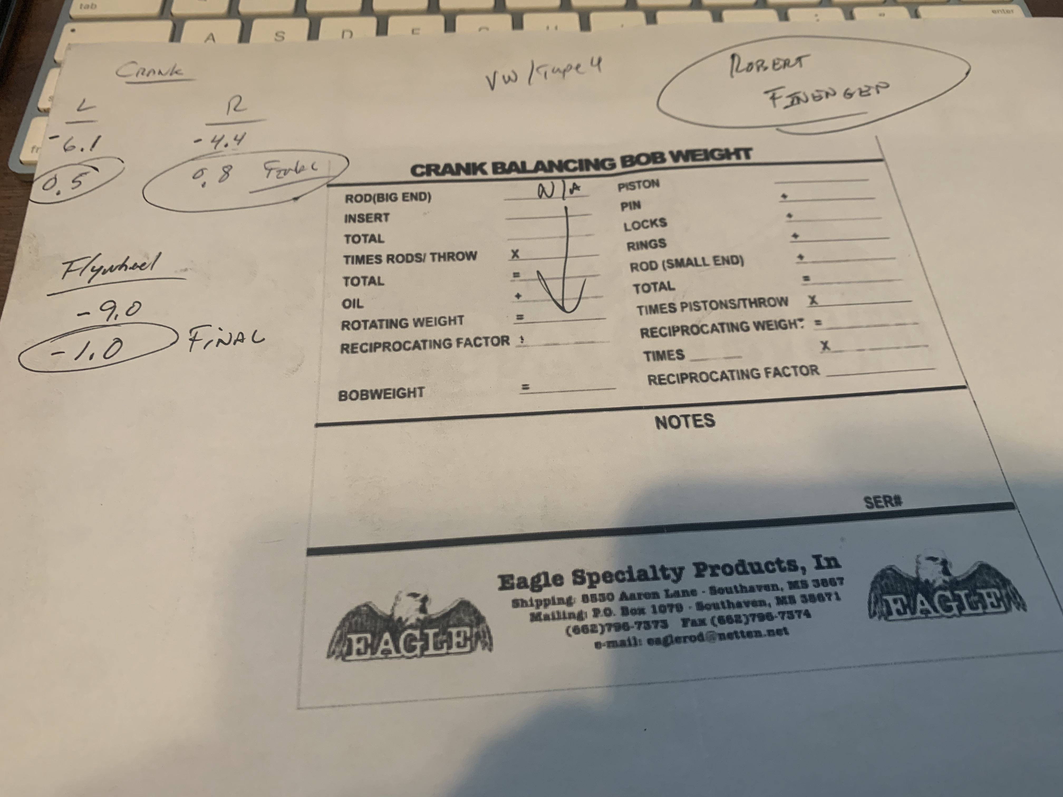

Trying make some sense out of the balance card
Looks like it was a little out of balance
