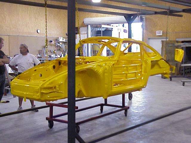

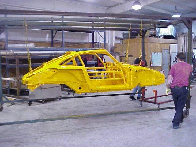

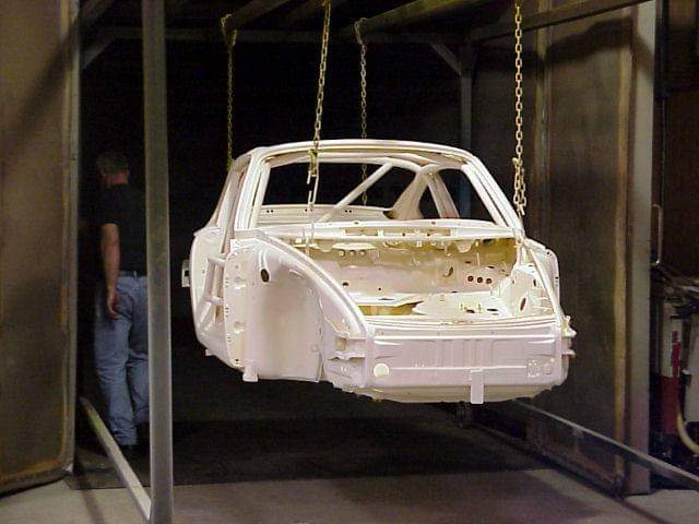

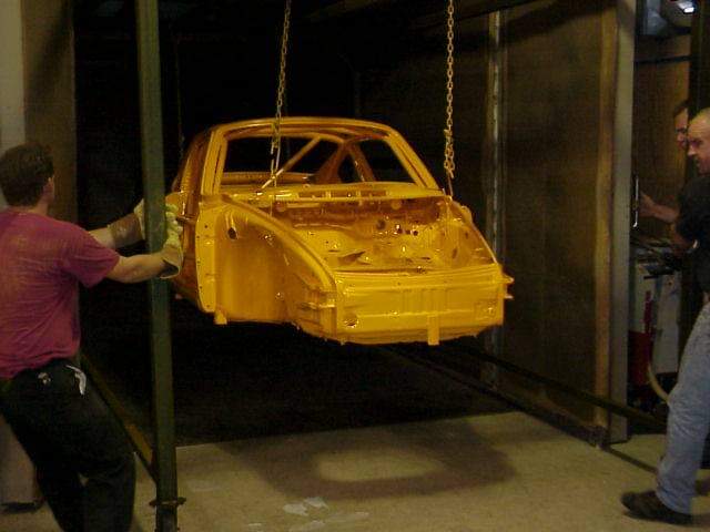

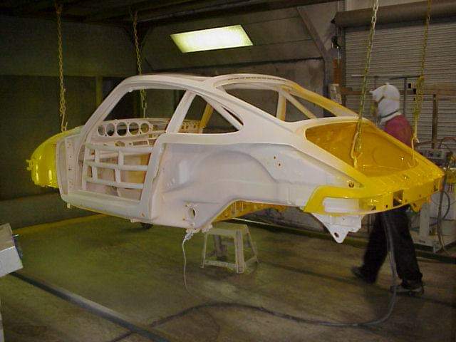

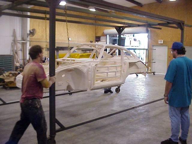

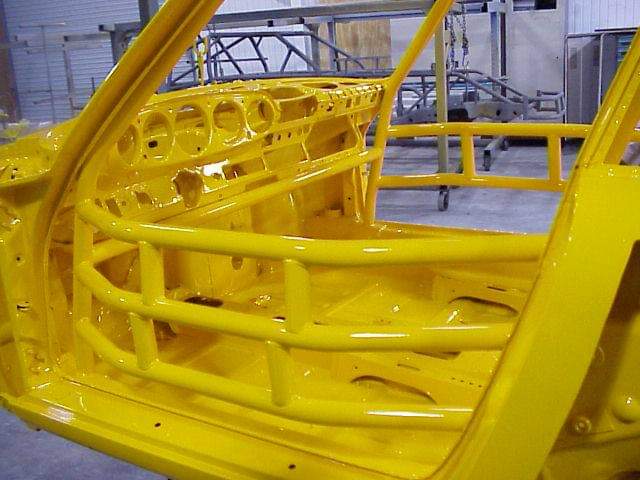

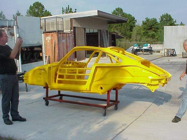

Back when you could reasonably get a tub acid dipped and more places did it, we would spray the tubs with Pam to protect from rust for the trip to the powder coater ( in this case, as with all our powder coating, PowderTech-Plus) who would put the tubs in their big ovens and literally bake the acid and Pam out of the tubs. When it came to sandblasting, it seemed that you could never get all the sand out.
The white is clear coat
