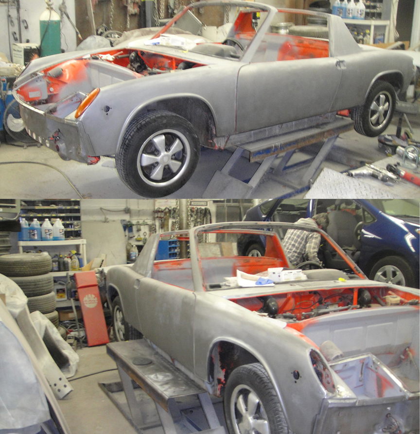

This is what my car looked like when it came back from soda blasting
about 4 years ago..

QUOTE(gandalf_025 @ Mar 25 2021, 12:02 PM) *
about 4 years ago..
How does she look today? would you soda blast again

gandalf_025   This is what my car looked like when it came back ...   Mar 25 2021, 12:02 PM
930cabman   This is what my car looked like when it came back...   Mar 25 2021, 12:53 PM
d914   I did soda on my car.. worked well.. Just needs a ...   Mar 25 2021, 12:10 PM
gandalf_025   Car looks more like this now.. It was painted imme...   Mar 25 2021, 01:09 PM
mepstein   Car looks more like this now.. It was painted imm...   Mar 25 2021, 03:33 PM
gandalf_025   I wasn’t involved in the blasting process. The b...   Mar 25 2021, 04:02 PM
