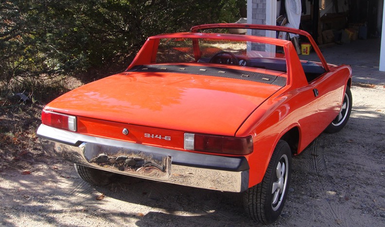

When prepping a car for sandblasting, what is the common thing to do with the aluminum tags in the front trunk and door pillar?
I suppose the second question would be do I acid dip the car or get it sandblasted?

Car looks more like this now..
It was painted immediately after being stripped.
I would do it again if I ever needed another car stripped..

What prep was needed to clean off the soda
