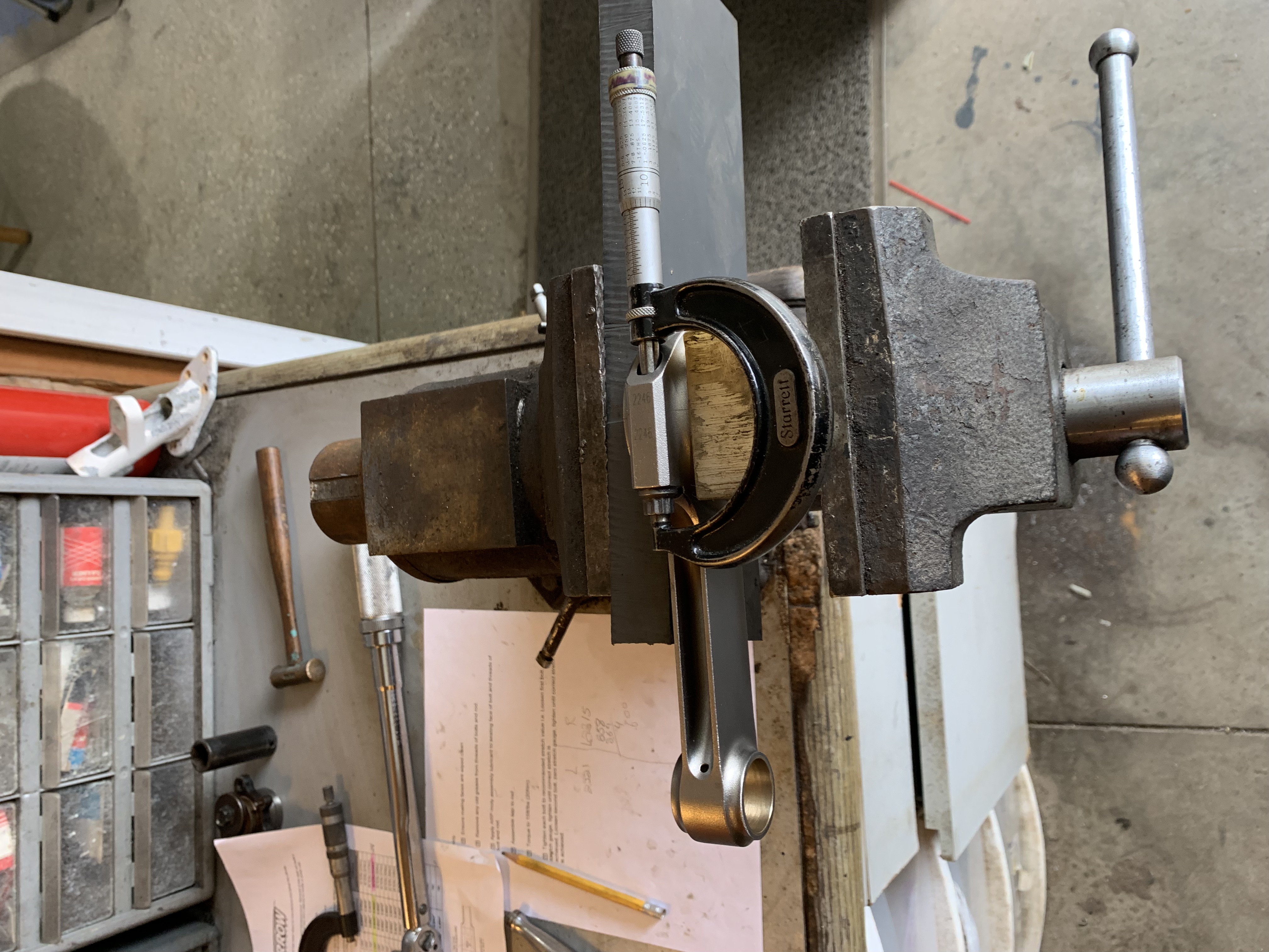

ARP bolt stretch:
Following the instructions for messing bolt stretch required a $60.00 to $200.00 bolt stretch dial indicator. I will do my best to user a micrometer for this. peeps just a little better them guessing and generic number. 0.0005 to 0.00055 torque 30 lbs. I also plastigaged the cleansed the rods too.
1) Clean rod ends and mating faceless
2) Remove grease from threaded rod ends
3) Apply arp molly lube rod threads faces, bolts
4) Assemble cap and rod
5) Torque bolts to 15 lbs
6) Losen first bolt and measure base rod boot length. Tighten to to rod stretch is achieved. repeat for other rod bolt
MY results were:
base bolt measure : 1.8640
bolt stretch : 1.8580
difference : 0.00060 @ 28lbs
very close
I used 27 for my final torque and bearing clearance of 0.0015
