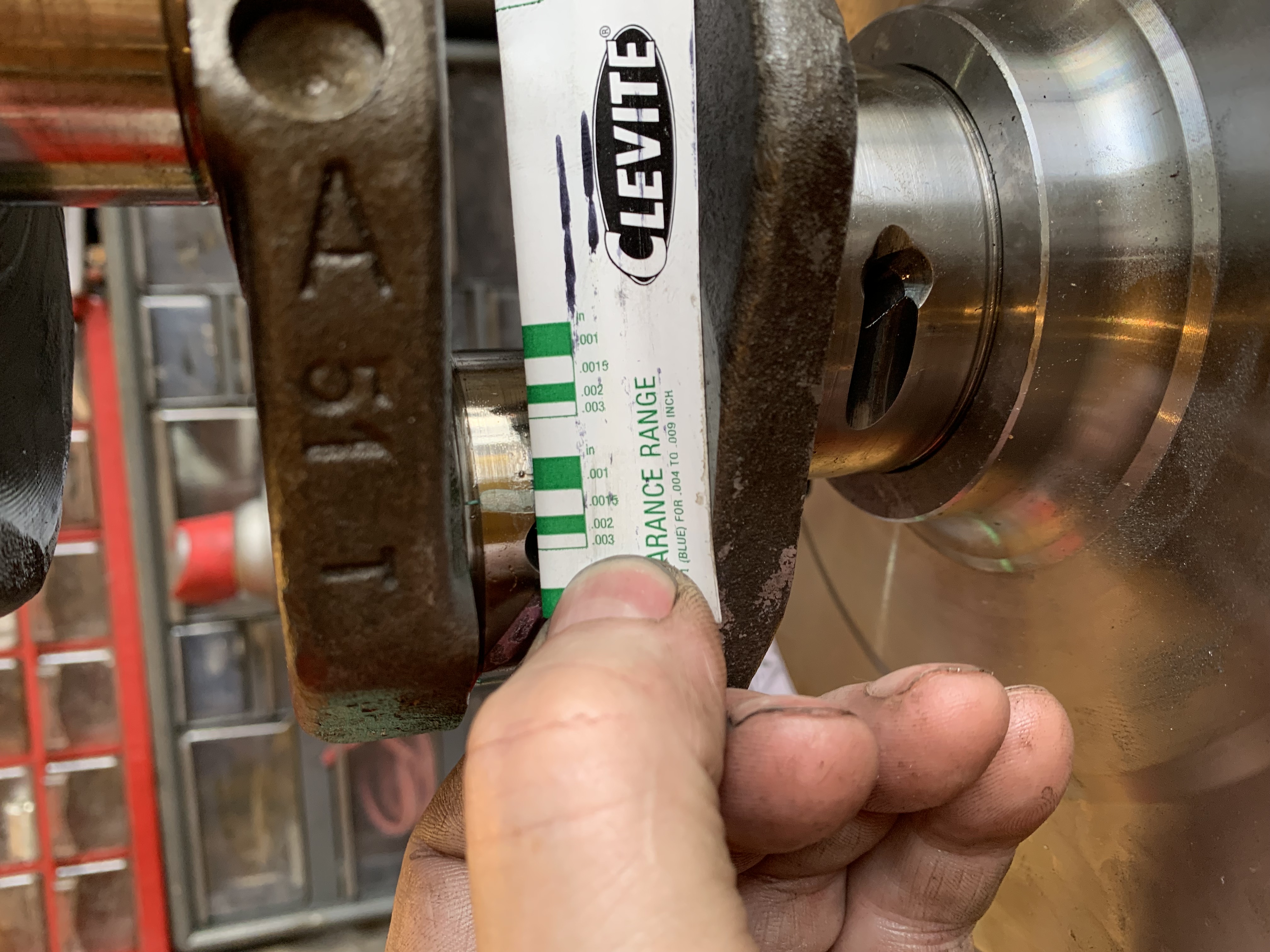

plasigage:

rfinegan   Tonight, I fitted the second thrust bearing in the...   Mar 26 2021, 06:48 PM
rfinegan   ARP bolt stretch: Following the instructions for ...   Mar 28 2021, 07:41 AM
Mark Henry   ARP bolt stretch: Following the instructions for...   Mar 28 2021, 09:59 AM
rfinegan   plasigage:   Mar 28 2021, 07:43 AM
