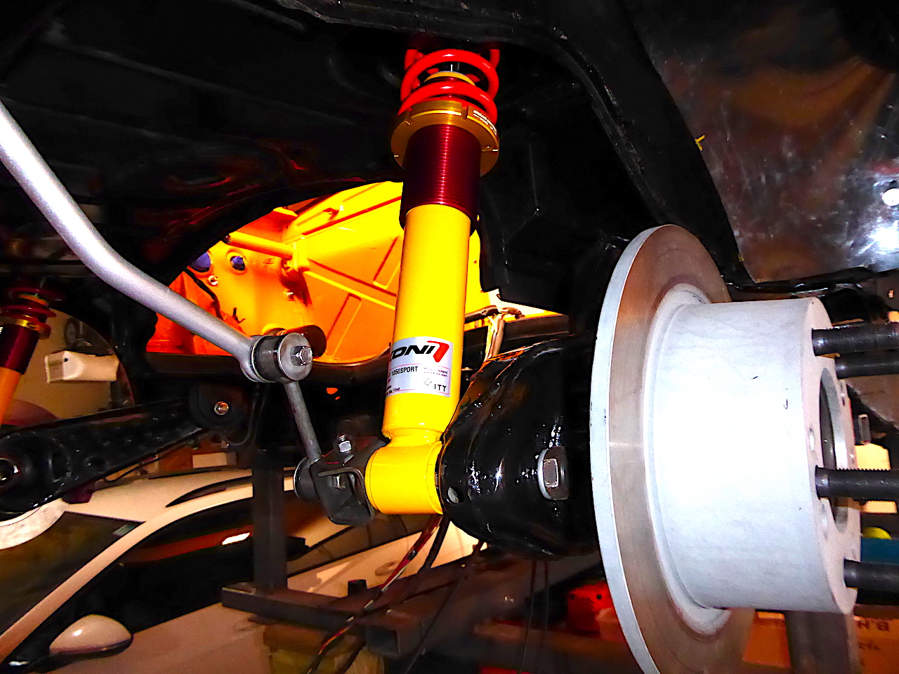

I went with Ground Control, great product for 914s and service and price to match. Best, MarkAttached Image
