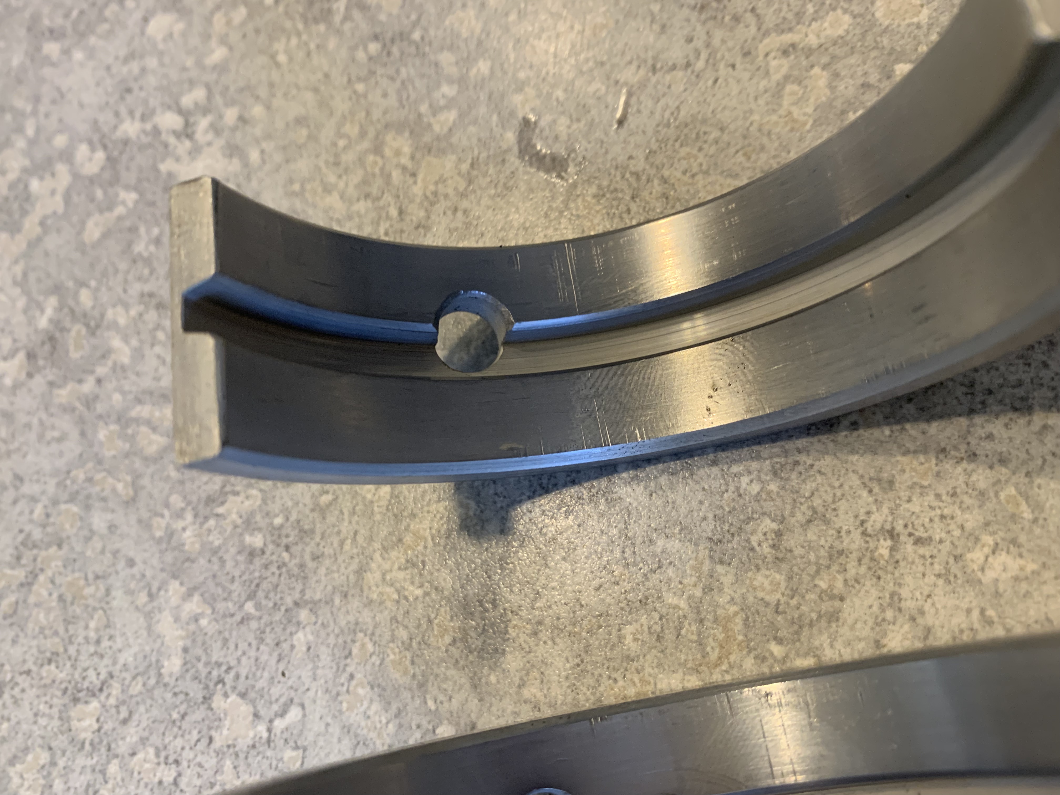

rfinegan   Main bearing time: ALWAYS measure your crank jour...   Mar 29 2021, 04:52 PM
rfinegan   another   Mar 29 2021, 04:53 PM
rfinegan   another pic of the worst bearing F-ed up bearing. ...   Mar 30 2021, 09:08 AM
rfinegan   another pic of the worst bearing F-ed up bearing. ...   Mar 30 2021, 09:09 AM

rfinegan   Latest setbacks include: Defective Main bearing s...   Apr 21 2021, 05:54 PM
