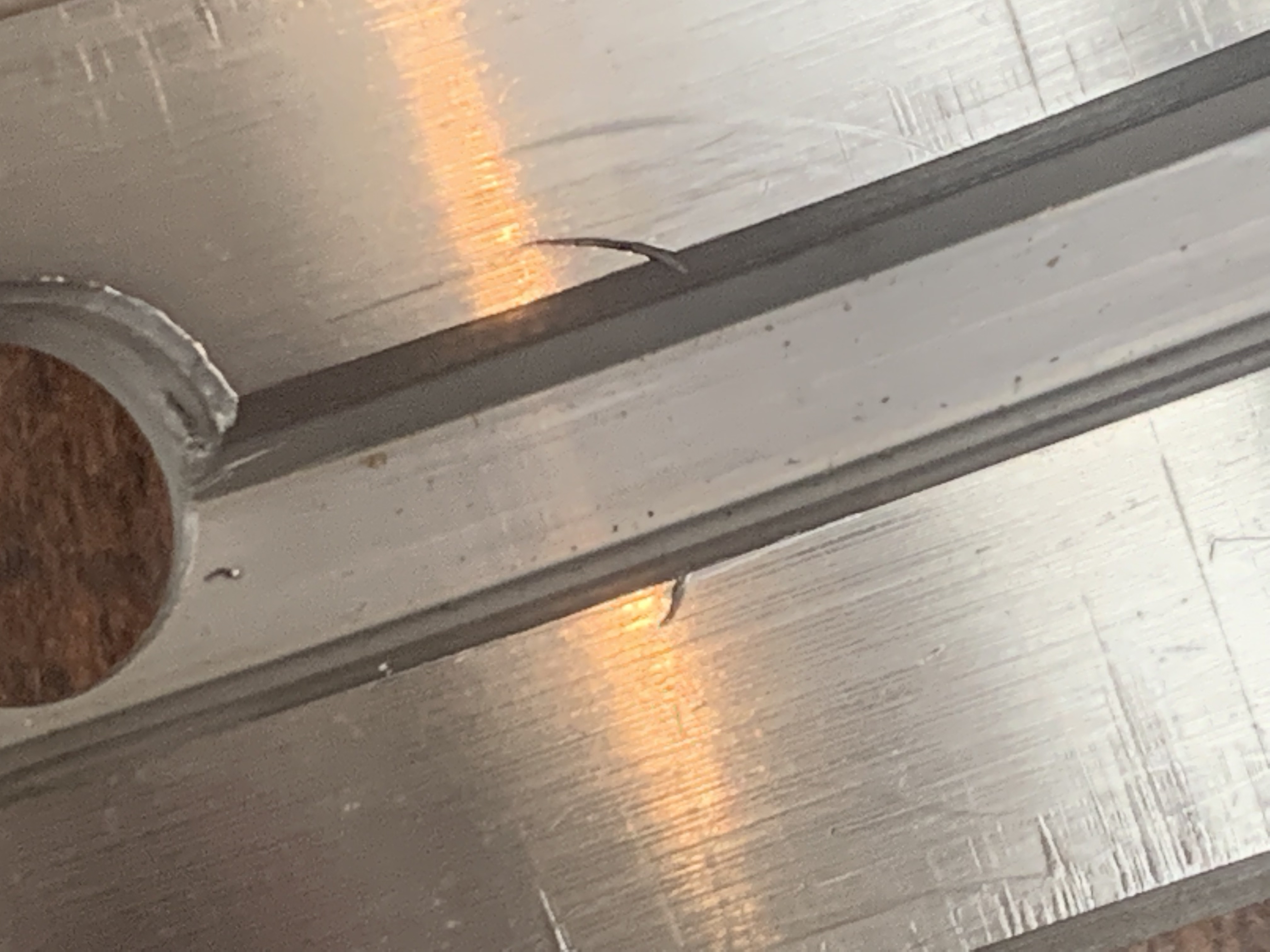

another pic of the worst bearing F-ed up bearing. Also this bearing is too small to even make good contact with the crank... AMAZING it came out of the package this way!

rfinegan   another pic of the worst bearing F-ed up bearing. ...   Mar 30 2021, 09:08 AM
rfinegan   another pic of the worst bearing F-ed up bearing. ...   Mar 30 2021, 09:09 AM
