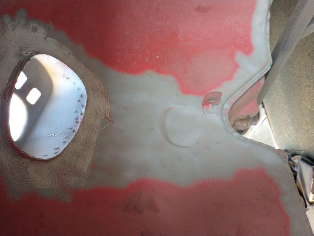

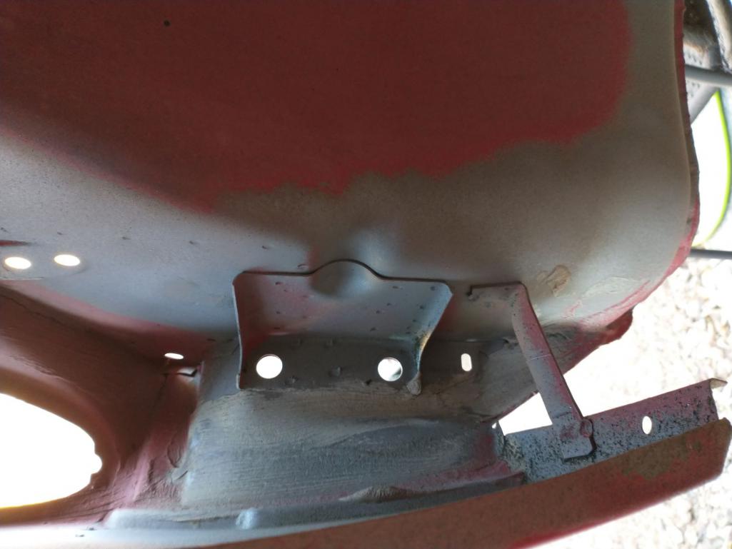

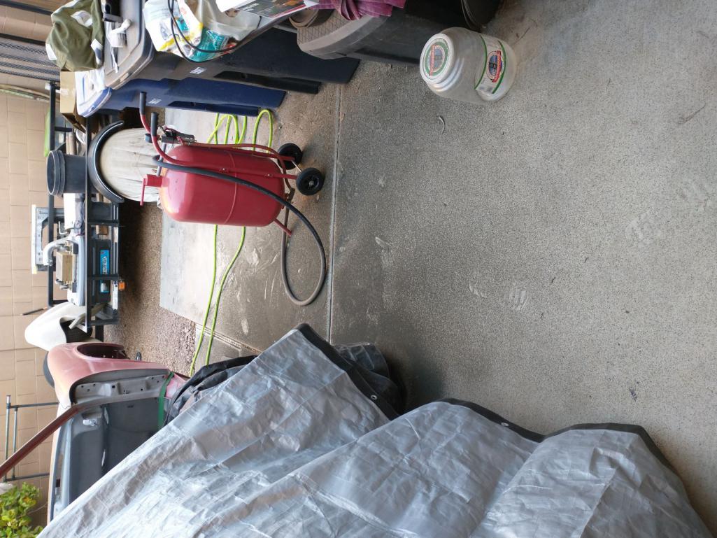

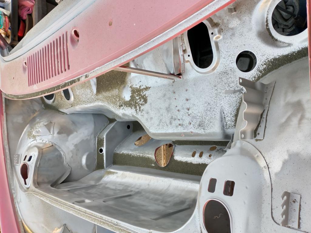

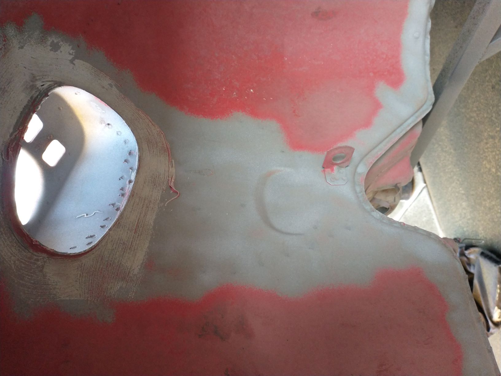

I was really struggling trying to figure out how to get a wire/fiber brush down into all the nooks & crannies in the frunk area, and the area under the gas tank. I thought I had found a flexible extension for my drill, but then received an email that it was no longer available from the supplier! (IMG:style_emoticons/default/headbang.gif)
At that point I gave up and got a abrasive blaster from HF. I decided on the 110lb model since it was only $20 more than the 40lb model. After reading reviews, I stopped by Tractor Supply and got 100lbs of the Black Diamond fine blasting media (coal slag). It's $9.99/bag for 50lbs. The HF media is $24.99/bag for 50lbs!
I have a 2HP Kobalt twin cylinder compressor that's plumbed in to another 32 gallon tank left over from my old compressor that died. So, 62 gallons of 150PSI air, theoretically...
So far, so good. Works pretty well, and I have not run low on air pressure that I have noticed. I blast a section, then take a break - it's been in the mid to high 90s here already, so having a N95, safety glasses, hood, gloves, long sleeves makes it a bit too toasty to blast for very long!
Creates a nice finish, but boy does it make a huge mess!
I have been cleaning the media up with my shop vac - one reviewer suggested sucking up all the used media in a clean shop vac, and then sifting it and reusing it. Have not tried doing that yet, but the shop vac is getting pretty heavy! (IMG:style_emoticons/default/idea.gif)
