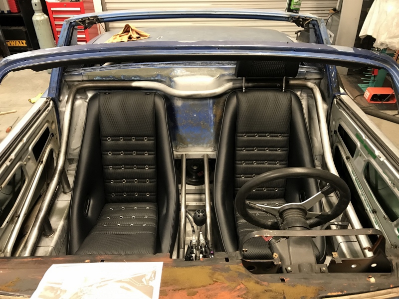

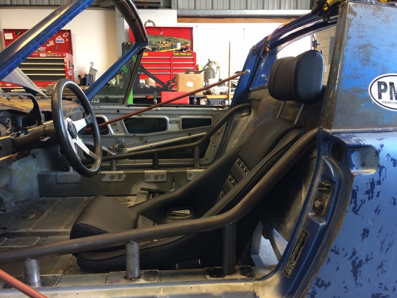

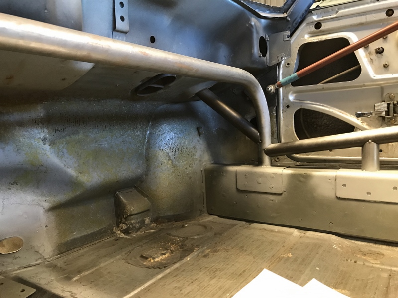

I vote weld in. I helped a buddy with his bolt-in GT bar and didn't like the way it forced the bar to be set forward - you give up some room.
Given that, you can't go wrong with @ChrisFoley products, assuming you don't want to fab your own.
I went a bit non-traditional with my design as I didn't want a full main hoop and did things like relocating my seatbelt retractors so I'm not sure these pics help but maybe will give some ideas. I call it "the roadster cage".
