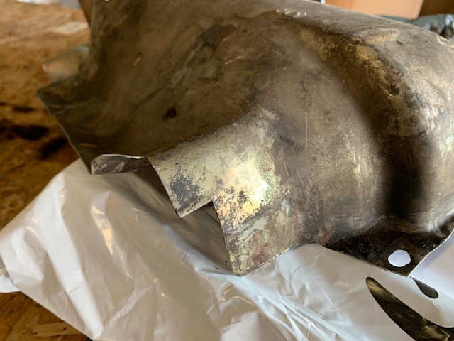

I recommend all new welders to get some 50 year old thin gage sheet metal to learn with. (IMG:style_emoticons/default/welder.gif) How hard could it be?
In doing so, you’ll practice with voltage and wire speed, stick out, part set up, metal cleaning, contamination and porosity, work area lighting, youtube, weld grinding, fabrication, clamping, gapping, blow thru, backing materials, warping, patience and wire brushing, to name a few.
What I have...
How many cracks can you spot?
Save your original OG engine tin they say. It's the best they say.
So after a few hours...
I'm not kidding anyone here with these pictures, after many days I find myself with this...
I have several questions for those with at least a few hours more experience.
1) How much more, if any, should these welds be ground down? Or, will the weld beads provide future strength to the thin, stretched sheet metal so leave as-is?
2) In order of preference, what would be the best three tools to use to grind down welds on thin sheet metal? Assume you don't have an air compressor. I don't.
3) For the top section where the coil attaches on the tin, the coil bracket uses P/N: N 010 210 13 which is M 6 x 10 hex-head bolt. Is the tin supposed to have a captured nut on the backside or just thicker sheet metal in the locations that are missing on my tin (see first few pictures).
4) Should the coil mounting location be relocated in order to avoid whatever the hell happened here? If so, where?
In actuality I'm quite please with the results so far, maybe not the pace of the work, but at least the product thus far. It'll be useable tin and certainly better than it was. (IMG:style_emoticons/default/screwy.gif) This is literally the first time I have ever fabricated a patch and tried to weld anything. I'm working my way up to the easy stuff if there such a thing?
I appreciate you entertaining my questions.
Thanks,
Sean

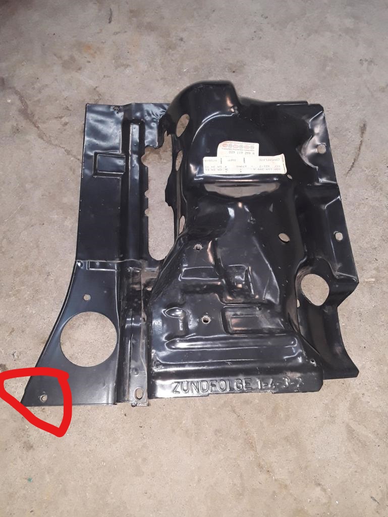

QUOTE(dr914@autoatlanta.com @ Feb 24 2021, 11:09 AM) *
the passenger side 2.0 engine cylinder cover is impossibly hard to find as many have been cut (as yours has) for air conditioning. I applaud you in your job to fix this piece. HOWEVER when it gets this bad, could be easier to convert a 1.7 1.8 piece (readily available) by relocating the two spark plug holes. We are in the process of recreating the right front piece where the accelerator cable passes through. THIS piece is IMPOSSIBLE to find
Like this one?
BTW I have the other side as well but it lost its label.

Hello Mark Henry -
Could you scoot that tin around and show the back inside corner? Mine looks to have been modified but cannot tell for certain. I don't know what it should look like.
Also, does the front outside corner have a captured nut welded on the tin or is it just a straight thru hole?

QUOTE(seanpaulmc @ Apr 7 2021, 08:06 PM) *
Hello Mark Henry -
The circled hole has a M6 weldnut.
Not sure where you mean, can you circle the area you want me to take a pic?
