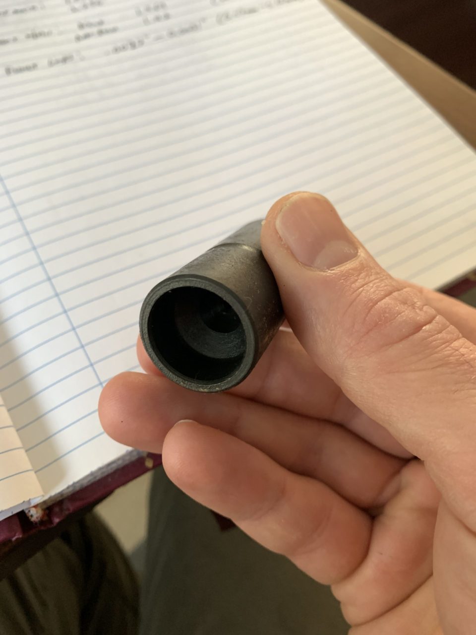

The first thing my aging brain did was ask:
"what the hell lifters are these?"
(IMG:http://www.914world.com/bbs2/uploads_offsite/www.patsachs.com-7353-1617896825.1.jpeg)
(IMG:http://www.914world.com/bbs2/uploads_offsite/www.patsachs.com-7353-1617896826.2.jpeg)
So I called webcam to see if they could help me identify them, and sure enough they are not theirs. So I ordered a set of Webcam solid lifters as I have seen/heard of plenty of horror stories about cams eating themselves when the improper lifter cam combo and oil is used.

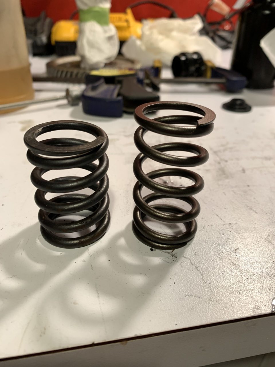

Scat 20011 Springs next to a stock spring
(IMG:http://www.914world.com/bbs2/uploads_offsite/www.patsachs.com-7353-1617896826.3.jpeg)

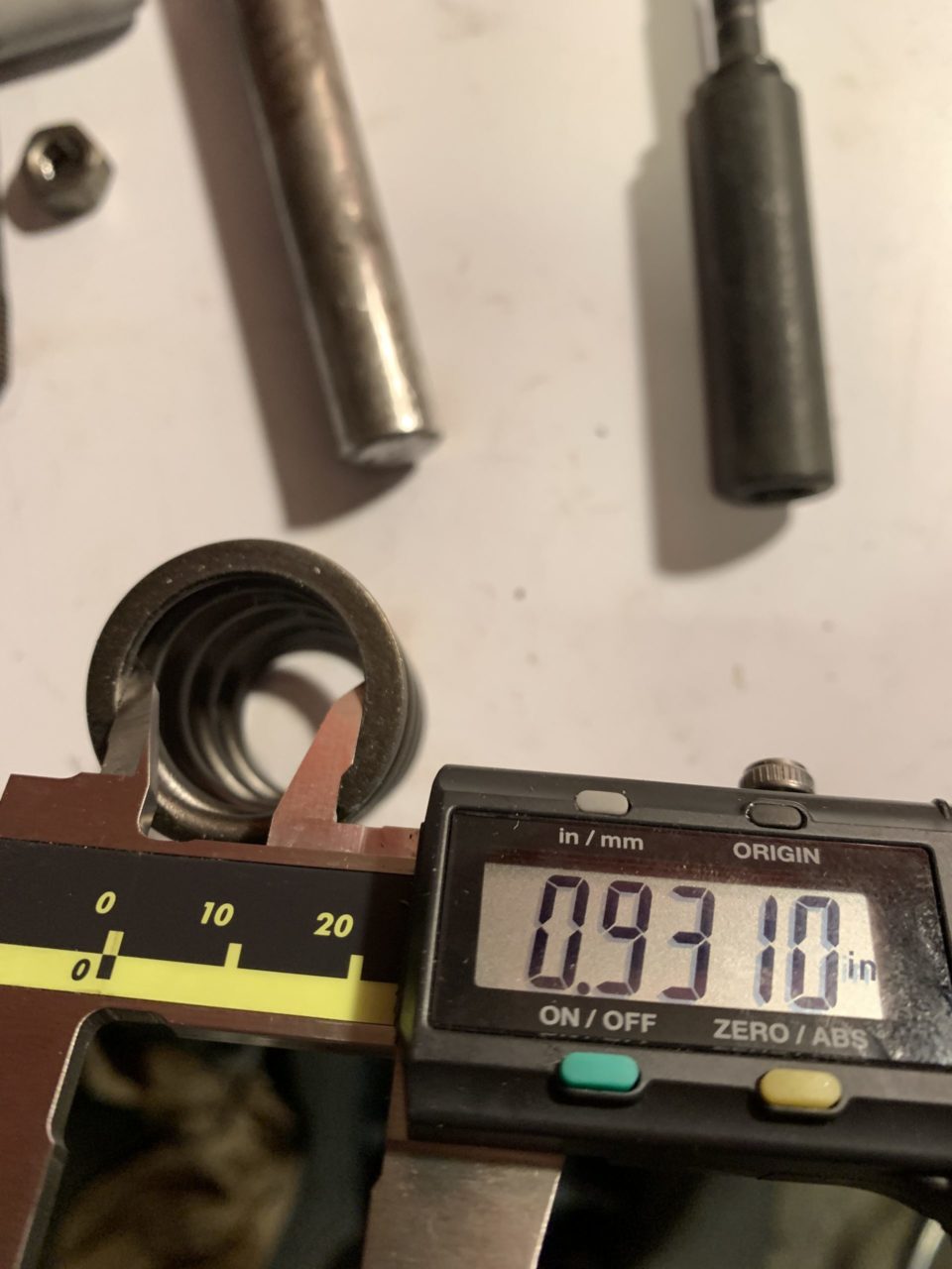

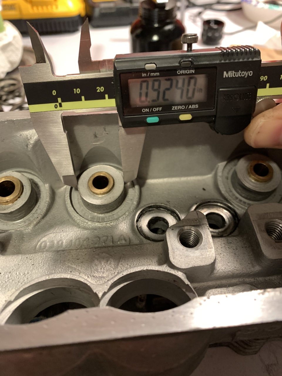

I measure out the Scat springs to be around 2.32" total length and an ID of around 0.931"
(IMG:http://www.914world.com/bbs2/uploads_offsite/www.patsachs.com-7353-1617896827.4.jpeg)

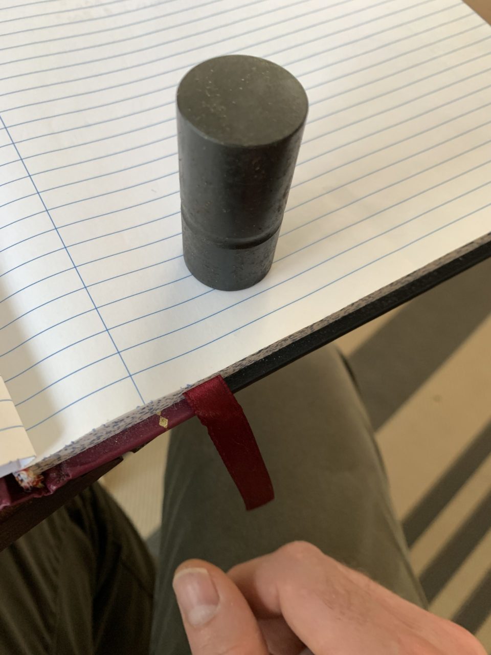

The guide boss is around 0.924" so the fit is certainly snug:
(IMG:http://www.914world.com/bbs2/uploads_offsite/www.patsachs.com-7353-1617896827.5.jpeg)
But they fit. At first my installed height was around 1.45", but a few "seating taps" with my hammer got it to around 1.48" so I am getting to a more acceptable level.

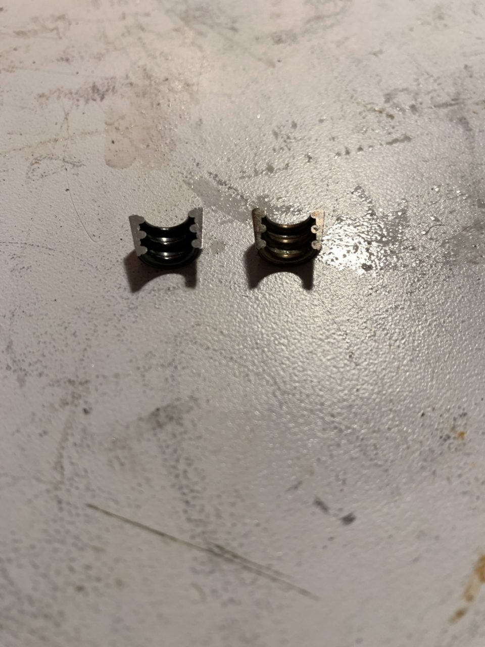

Next I noticed that my stock keepers were nice and shiny at the mating surface, where as my brand new ones looked like someone finished the edge with a chisel *sigh*.

Nice and shiny and smooth (stock keeper is on the right, new one on the left)
With this done the keepers no longer "rocked" when placed on the stem of the valves and when I installed them, I am now at 1.5" of installed height! Yay!

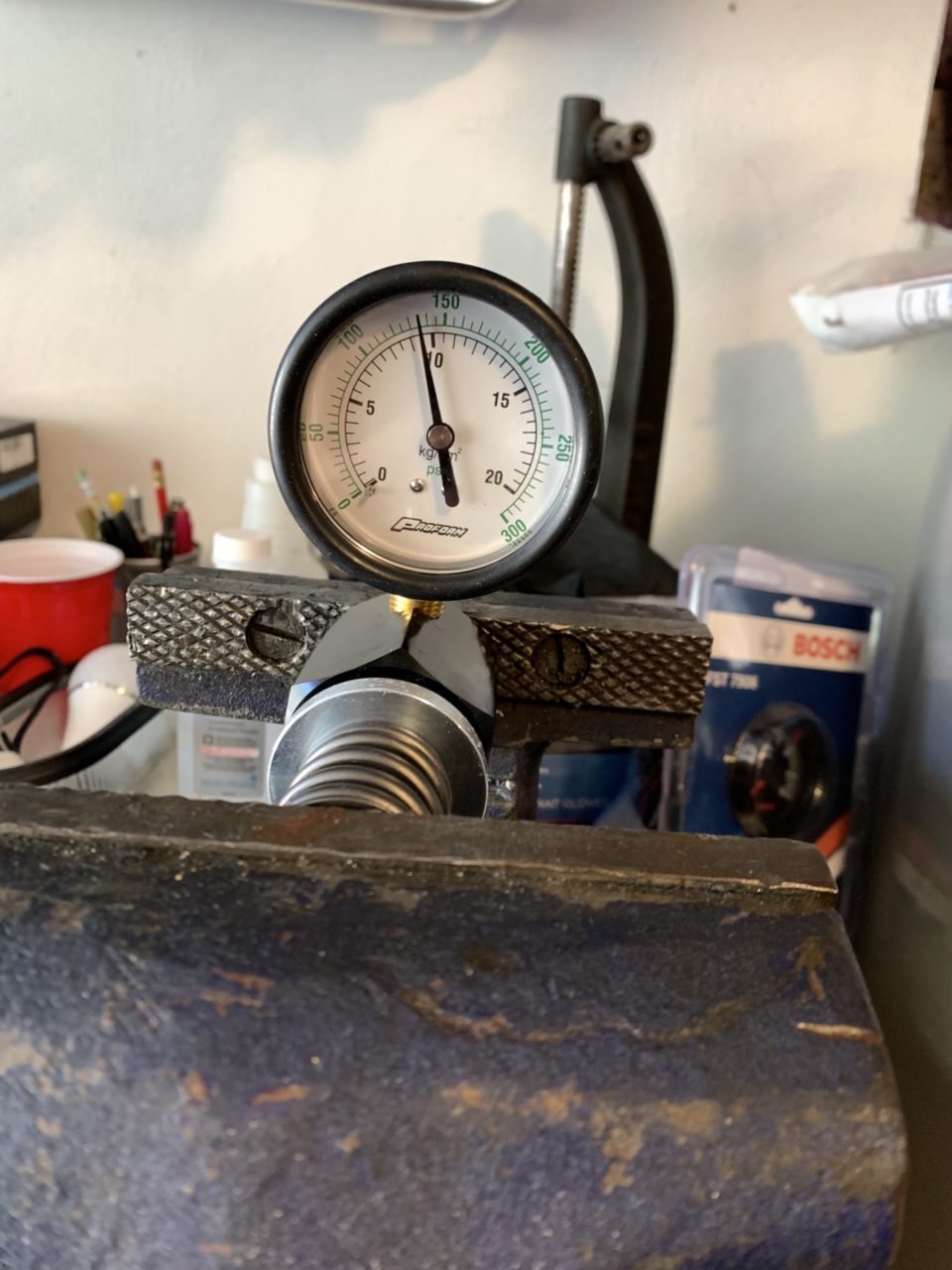

This should give me a seat pressure of around 140 PSI
(IMG:http://www.914world.com/bbs2/uploads_offsite/www.patsachs.com-7353-1617896829.8.jpeg)
And my clearance from coil bind should be around 0.1" with a hypothetical nose pressure of around 220 PSI. I am still on the fence about if this is enough for the webcam 86B. In conversation with webcam, they said it is in the middle between their double and single springs. I have no intentions of running this thing above 6000 RPM, so that is where I am at. Should I run what I brought? Should I go double spring? I could also go "beehive", but both would likely require machining.
