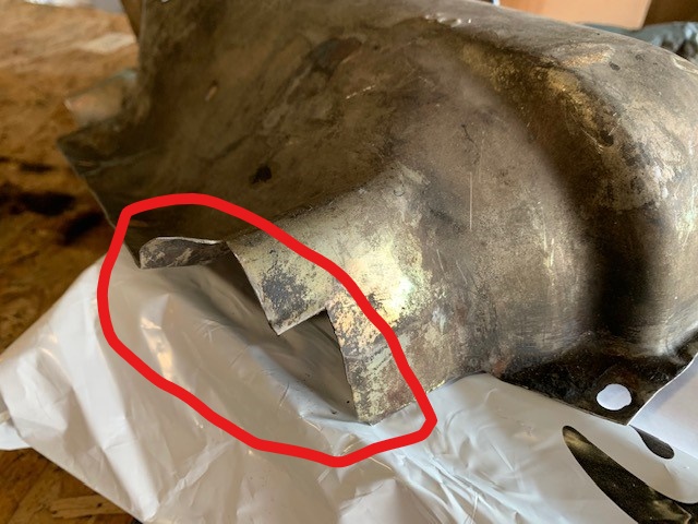

The area of concern I have for this piece of tin is circled here.
On mine it looks and feels like it has been trimmed, but I don't have anything to compare it too. I can't tell if this was just a little snip to make it fit or something more.

seanpaulmc   The area of concern I have for this piece of tin i...   Apr 8 2021, 11:42 AM
Mark Henry   The tin is correct in that area, you're good t...   Apr 8 2021, 11:45 AM
