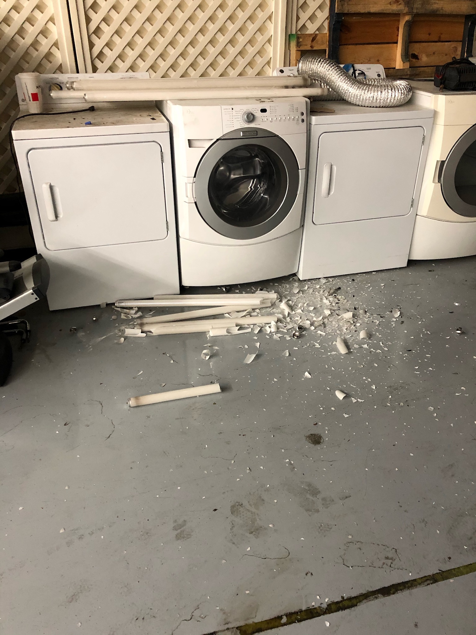

Got motor back in, everything hooked up, 6 qts of VR1 for starters, immediately fired, but took about 10 tries to prime the carbs before she stayed running.
Was sitting in the car keeping the rpms up when I started hearing loud popping and what I assumed were engine bits being thrown to the floor...
Turns out it was this...
A crew is retrofitting the lights in the warehouse, these were stacked on the W/D near the rear of the car, the exhaust vibrated them off.
(IMG:style_emoticons/default/lol-2.gif)
