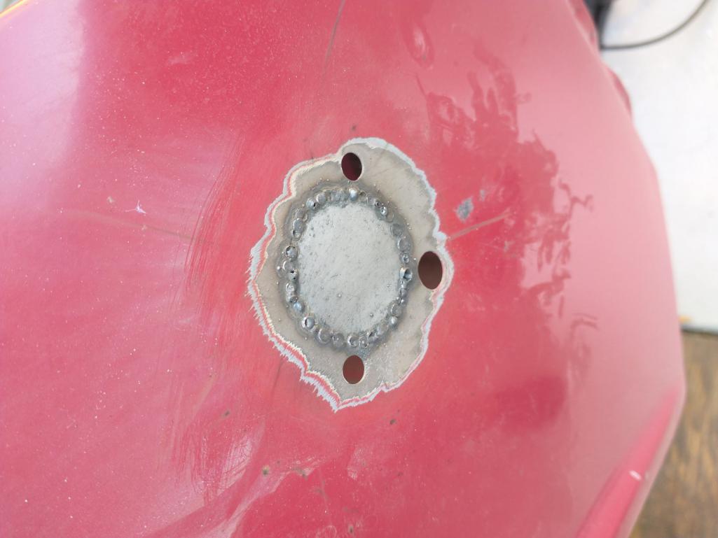

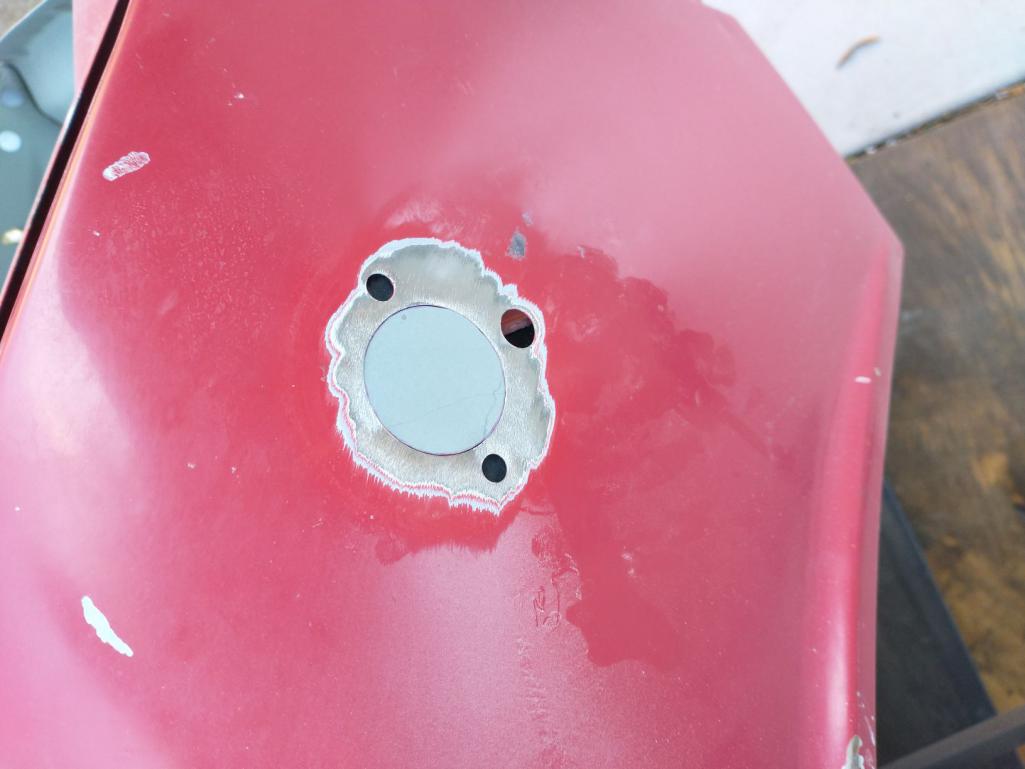

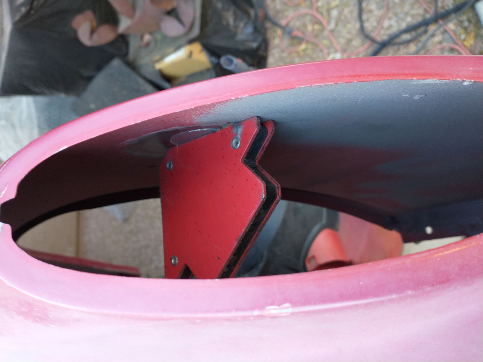

Been plugging along slowly. Finished up the frunk, tested sandblasting a bit along one rocker and both front fender wells. Cut and welded patches for the side marker light holes - Think I'm finally ready to order my flares and outer rockers! (IMG:style_emoticons/default/piratenanner.gif)
Once I get them mocked up and the fenders cut I plan on sandblasting the inside of the fenders - the larger cut out should make for easier access, I hope!
Some pics of the marker light patches...
