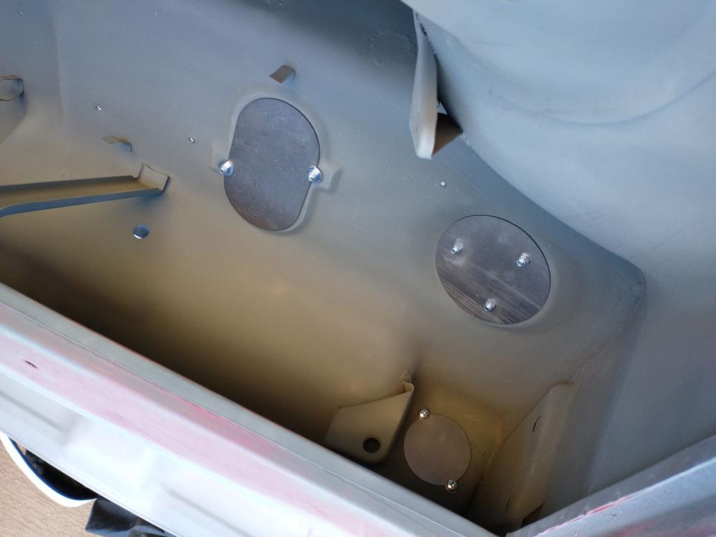

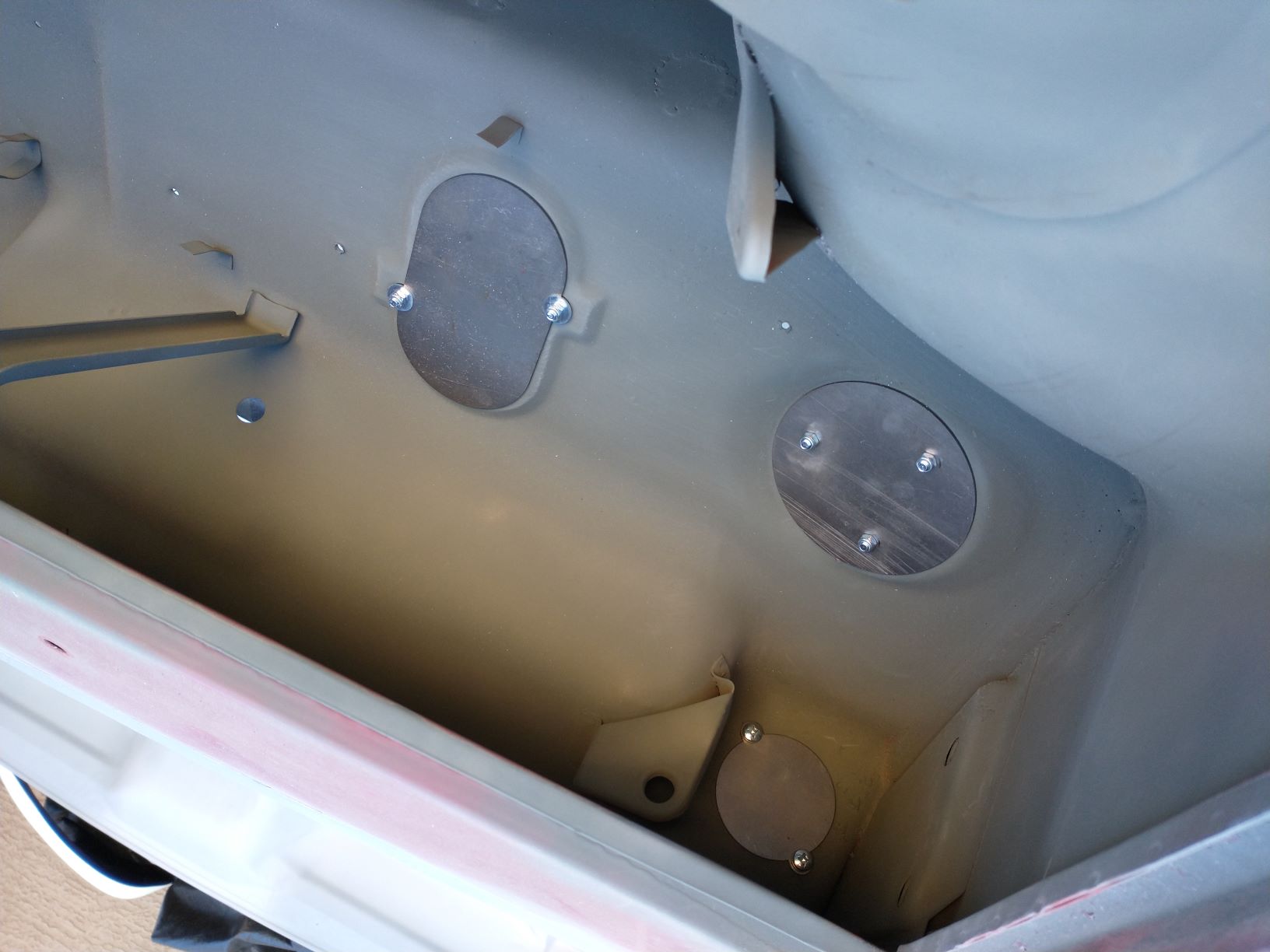

I got the block off plates from Mad Dog Motorsports for the heater openings under the dash. No instructions, but it mostly made sense once I laid it all out.

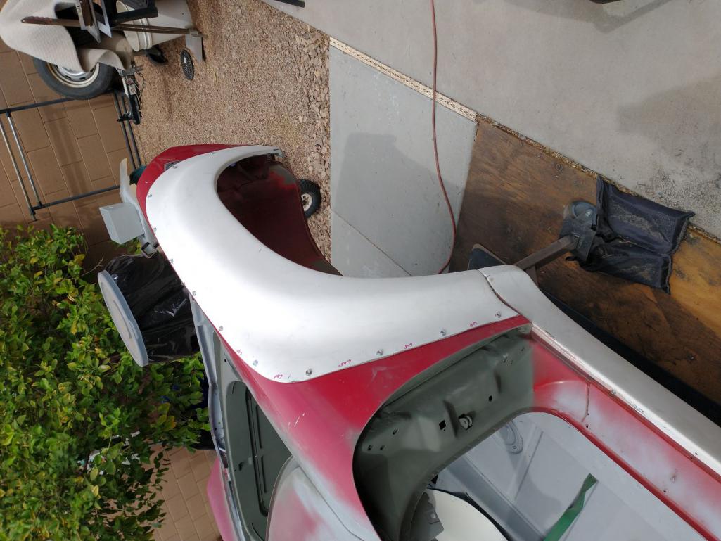

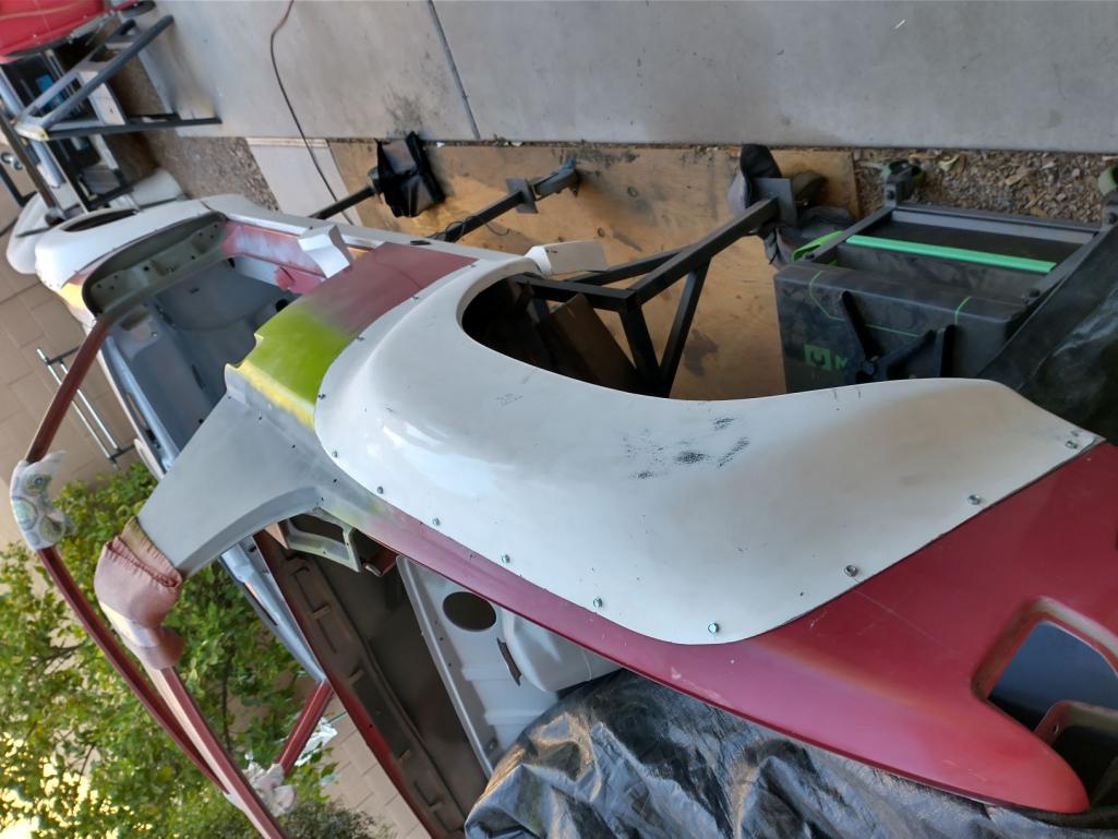

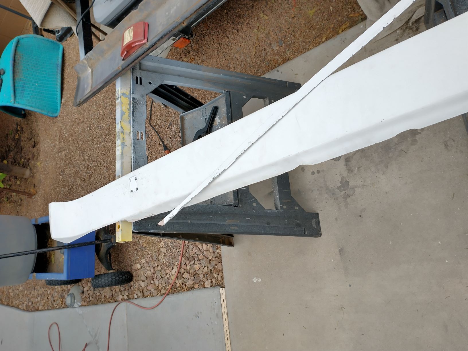

I finally was able to get my flares and rockers. A big shout out to Patrick Motorsports (who knew they were local!), and James Patrick for taking the time to go over his approach, and lessons learned on how to install the flares. I really appreciated his time and getting to see some really cool cars, and learning the local options for take-off parts, etc.

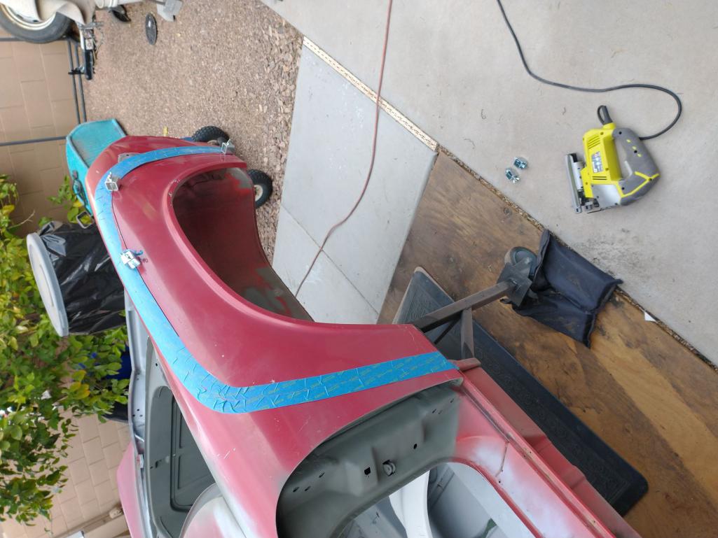

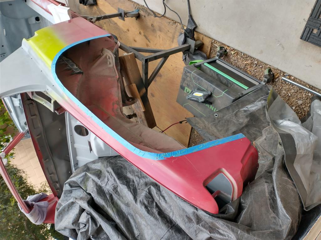

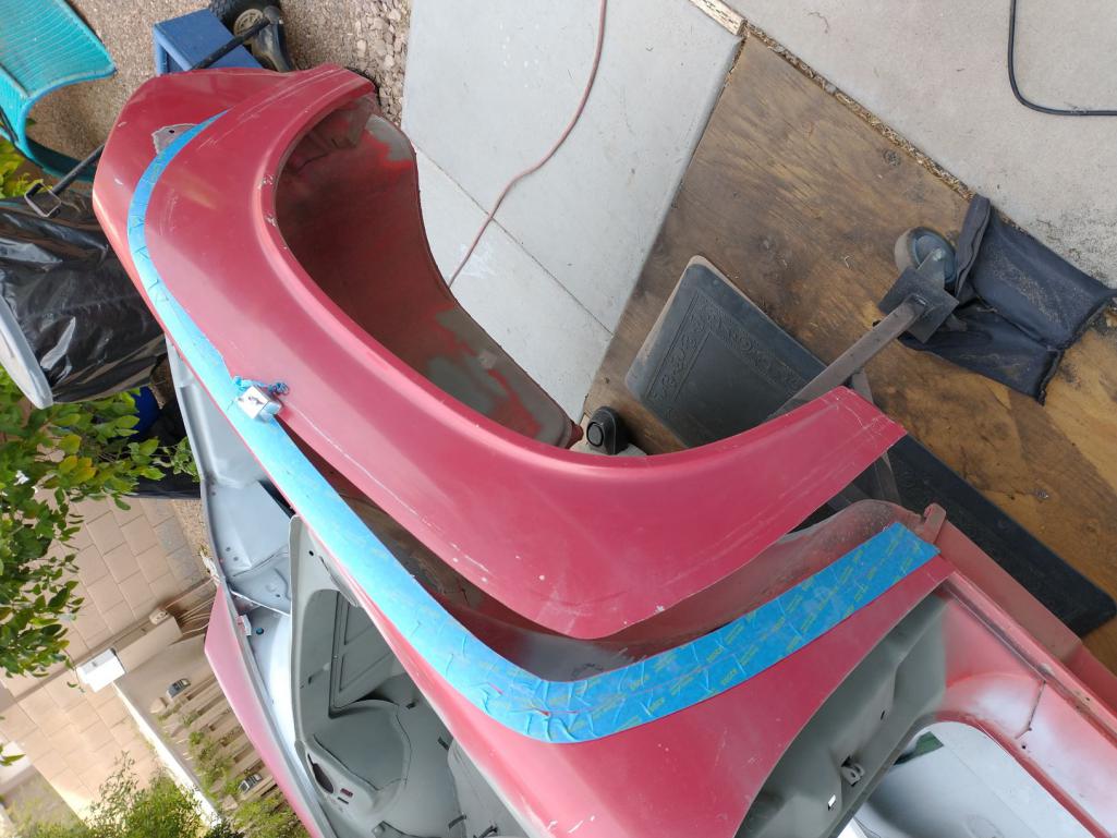

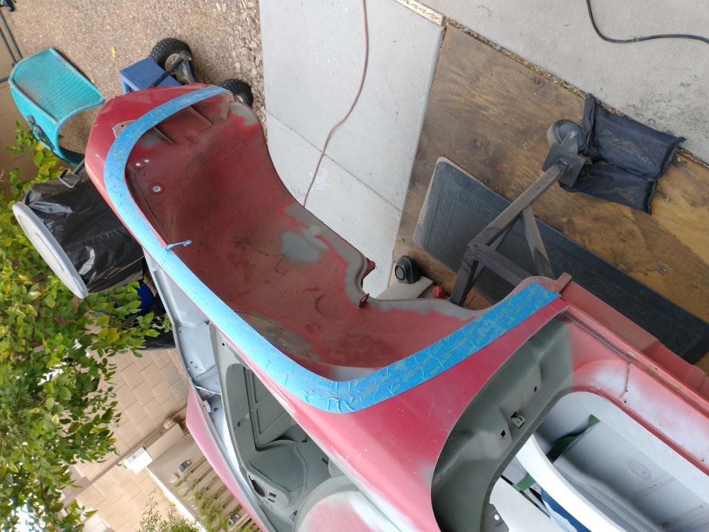

I started with the rockers first. Got them trimmed, openings cut out, and holes drilled for mounting.

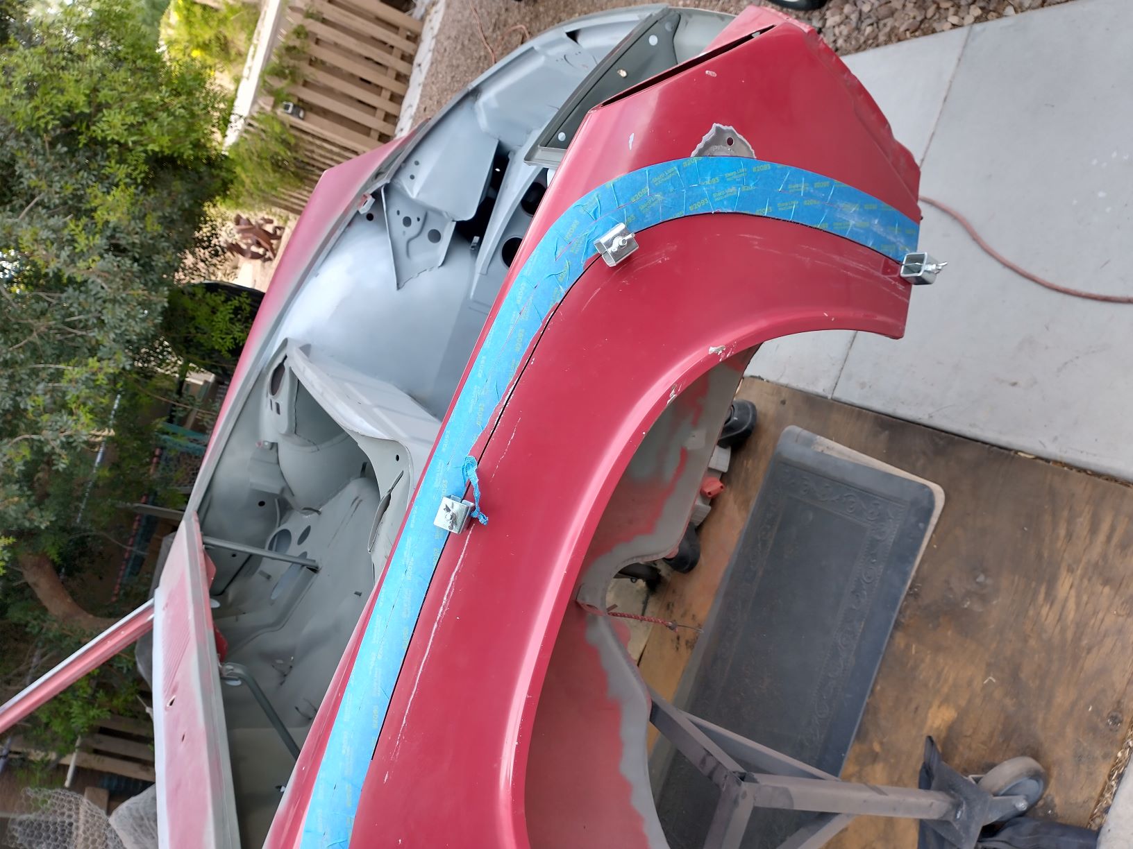

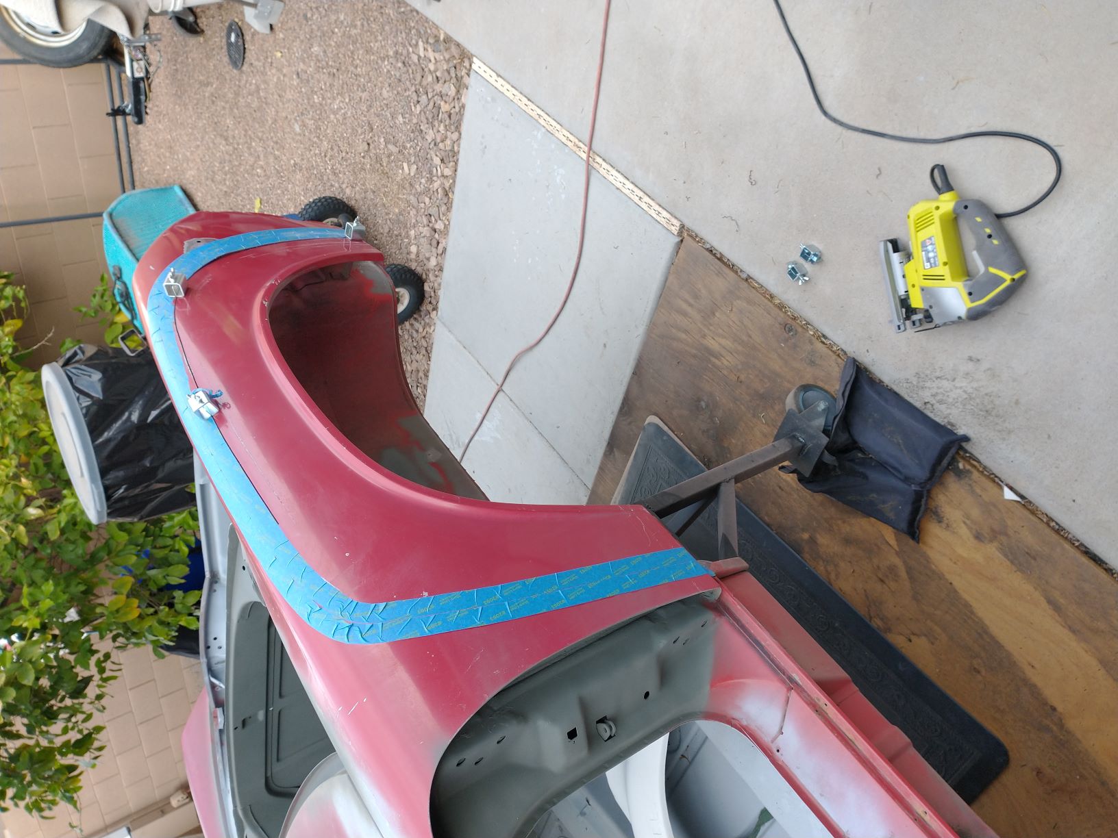

I did my best to get each side of the car all lined up between front, rear, and rocker. It's challenging to try and test fit the flares without an extra sets of hands.
How does that song go? "The first cut is the deepest"...
I used my butt-weld clamps to mostly keep things in place until the cut was finished.
Definitely had the "what have I done!" moment!

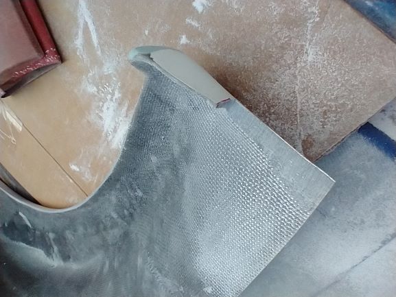

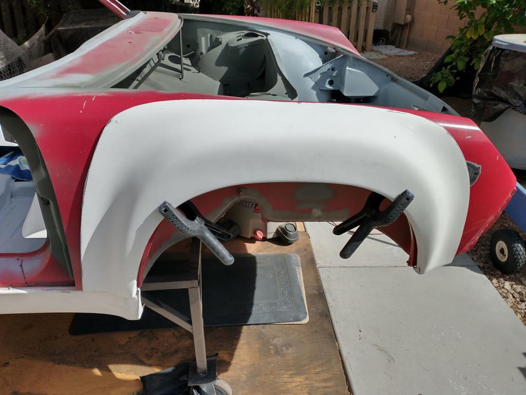

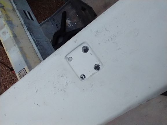

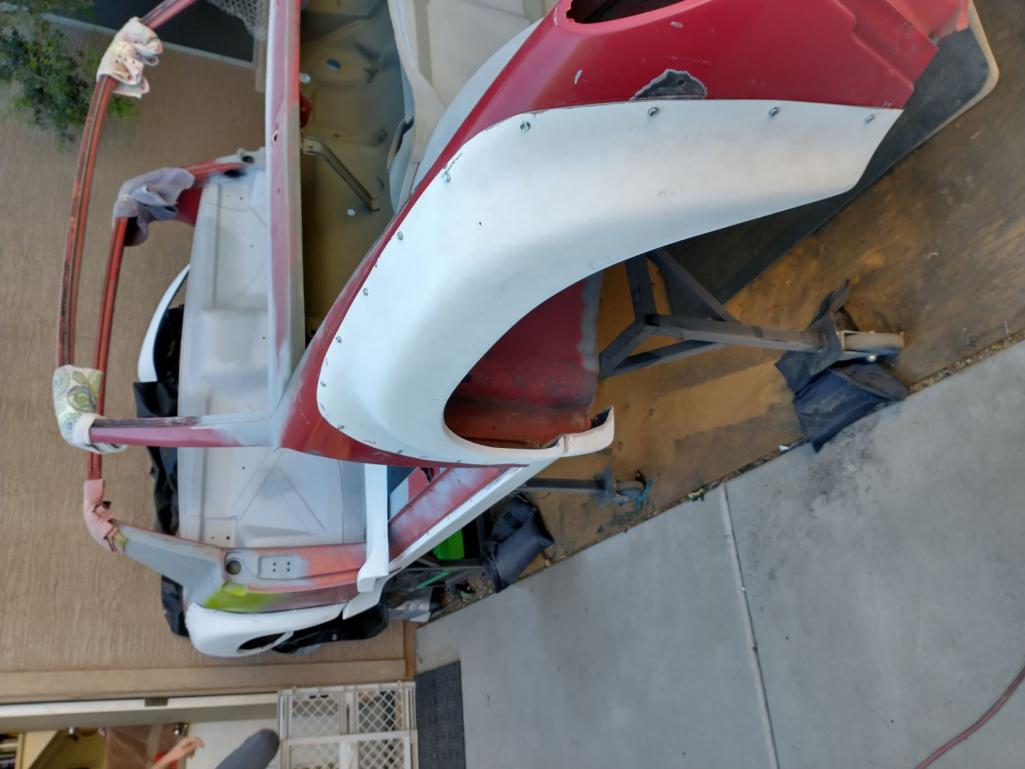

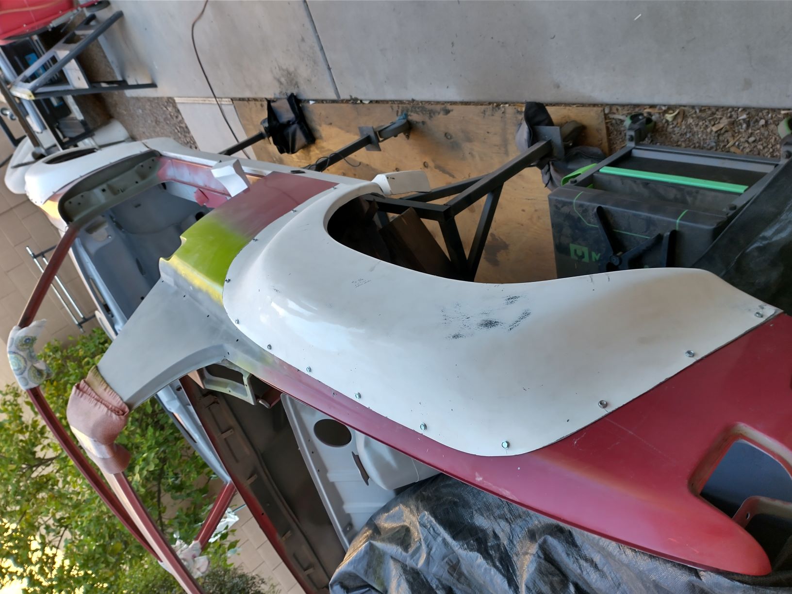

It sure takes a bit of sanding to try and get the flares to fit tight to the body.
I just have things temporarily mounted. Still need to sand things a bit more in a few spots, and I need to find the right bolts and order some more rivnuts.
