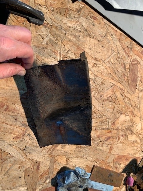

When taking the Tin off the engine, I have this small piece on the 3/4 side at the back part of the head. The leading part of the head is where the oil cooler is. Not a very good picture.
I think this is part 20 in the PET - 022 119 361, air duct /H/R.
Of course this part is missing on the left side of my engine.
I think I need part 21 in the diagram which for the 2.0L is 039 119 362, air duct /H/L.
Would someone confirm the P/N for me?
WTB this part if anyone has extras?
Thanks
