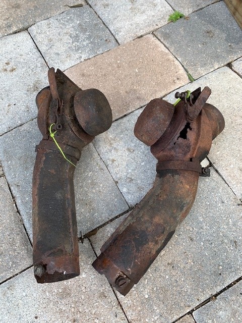

Are the heat control boxes salvageable?

QUOTE(seanpaulmc @ Apr 19 2021, 08:57 AM) *
Thanks,
Sean
No they look way too crunchy.
The rest of your work looks good (IMG:style_emoticons/default/thumb3d.gif)
