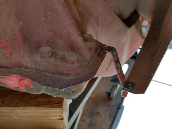

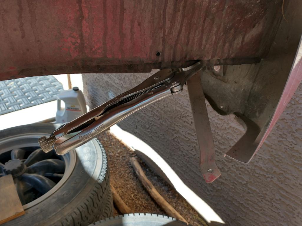

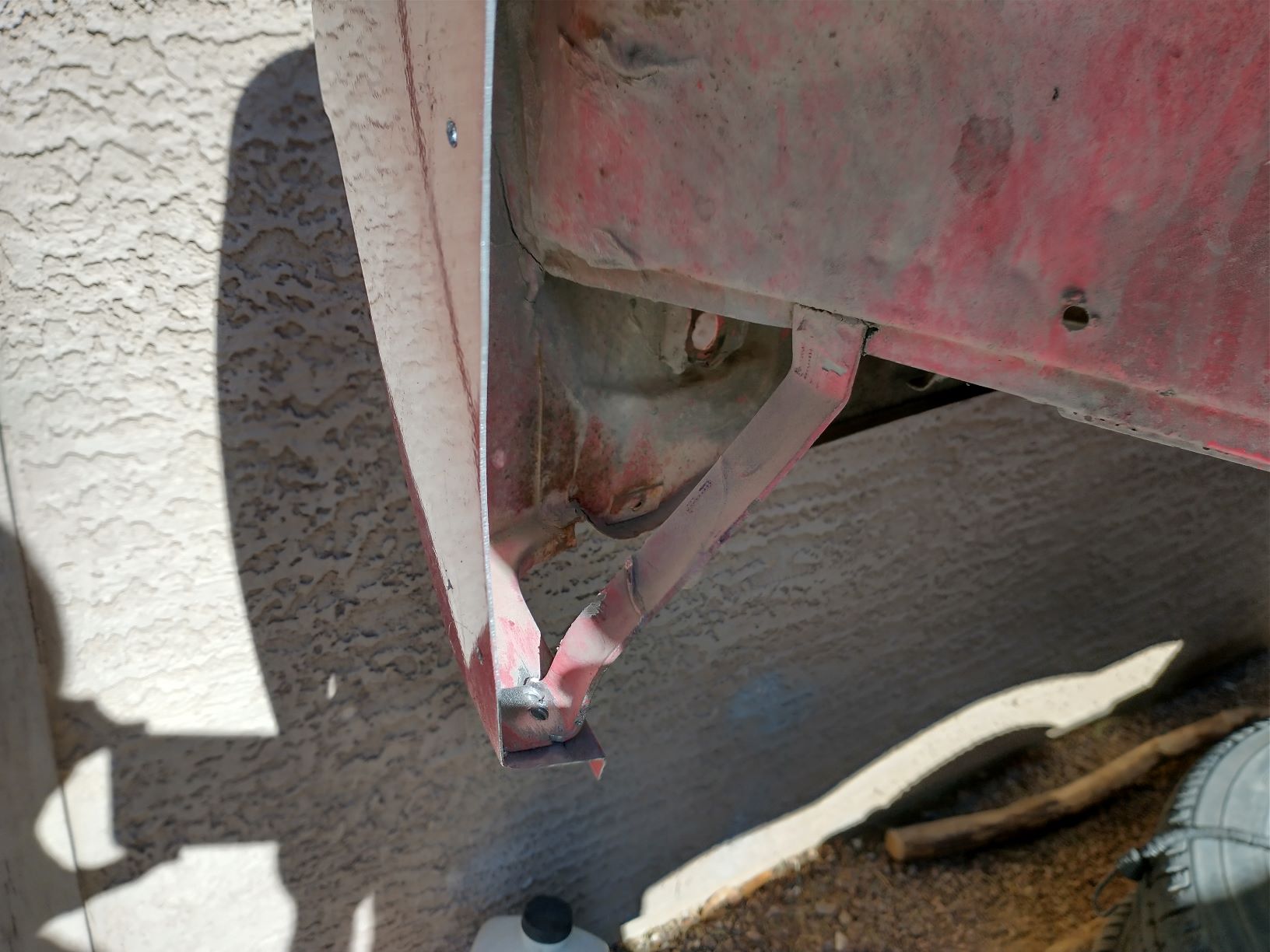

Working on reusing/repurposing the fender braces on the rear fenders since the area they attach to gets cut out. This one is pretty easy since its close to where it needs to be, and can just be bent a little to line up with what's left of the steel fender. It already has the holes in it from drilling out the spots welds.
Still need to bend this one around after wire brushing where it needs to be welded back on.
The front brace on the rear fenders needs to be removed, and then re-bent to be reused. Guess I could have just bent a new piece of steel, but figured why not reuse what was there originally since nothing is wrong with it.
