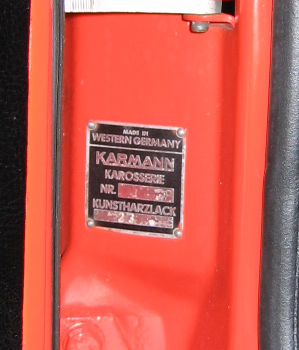

Why would they remove fuel injection over carbs? I definitely gotta do some inspection on the engine. The driver door jamb card seems to have been removed, would there be any other place for a paint code? Well in the period when these were "poor mans Porsches", a lot of mechanics and DIY'ers didn't know how or want to spend the time trying to fix the fuel injection. Cheap solution was to throw a carb on there. Those single carb kits are frowned upon probably for a variety of reasons. Also, just throwing a carb on an FI car is a problem because the engine is cammed for the FI. The FI, when sorted out, works really good. If you rebuild the motor putting duel carbs on is a reasonable option assuming you build the motor to be carbureted. This is a paint code tag, pulled off google randomly... It's between the door hinge and the door strap. I would be surprised if it wasn't there. (IMG:http://www.914world.com/bbs2/uploads_offsite/forums.pelicanparts.com-2573-1619197719.1.jpg) |

This is a paint code tag, pulled off google randomly... It's between the door hinge and the door strap. I would be surprised if it wasn't there. Slightly better angle (IMG:http://www.914world.com/bbs2/uploads/post-179-1217494641.jpg) |
