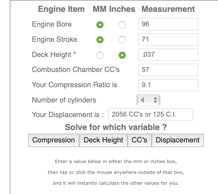

post Apr 24 2021, 11:31 AM
Posts: 1,212
Joined: 8-February 13
From: NC
Member No.: 15,499
Deck height measurements and compression ratio calculation .037 and 9.1 compression. I will measure the valve to piston clearance once I set my push rod length

rfinegan   Deck height measurements and compression ratio cal...   Apr 24 2021, 11:31 AM
