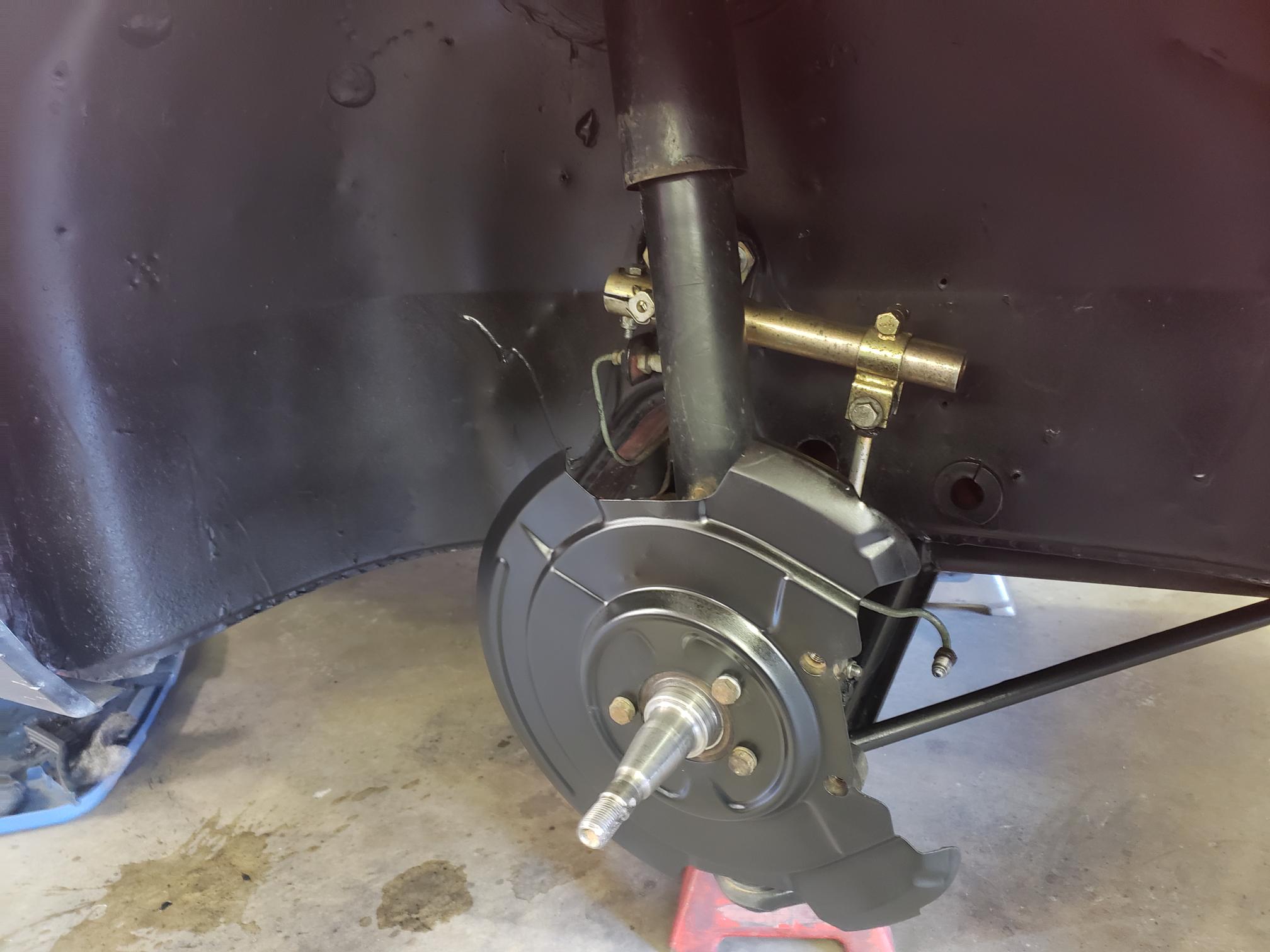

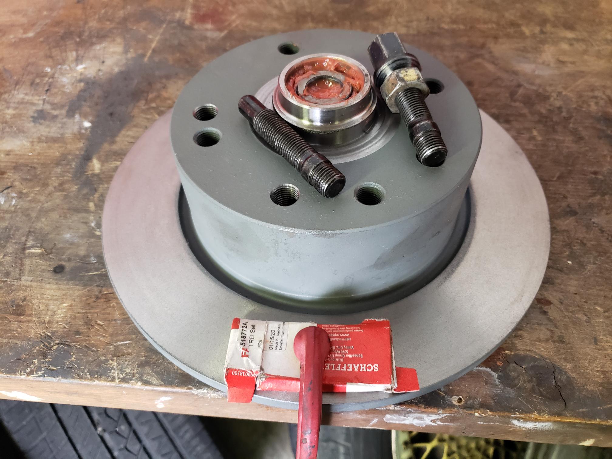

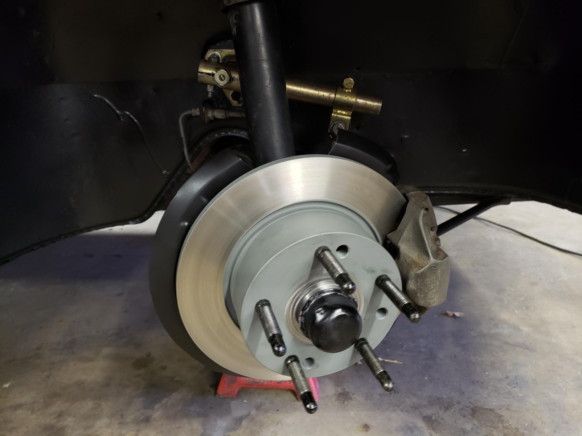

PMB five lug conversion complete!
The specs are as follow: PMB five lug kit, which includes new redrilled front rotors, new front wheel bearings, new redrilled rear rotors, redrilled rear 914 hubs, new rear wheel bearings. Also, 72mm bullet nose studs, 15x7 cookie cutters, 195/55-15 Sumitomos (I wanted 205/50 but my brother had these new tires that he donated to the project). The tires look pretty nice and I certainly don't need any more rubber for the street with the 1.7.
I thought I took more pics of the rear but I guess not. There will be a video in a couple of days.
Here are a few random photos from the conversion:

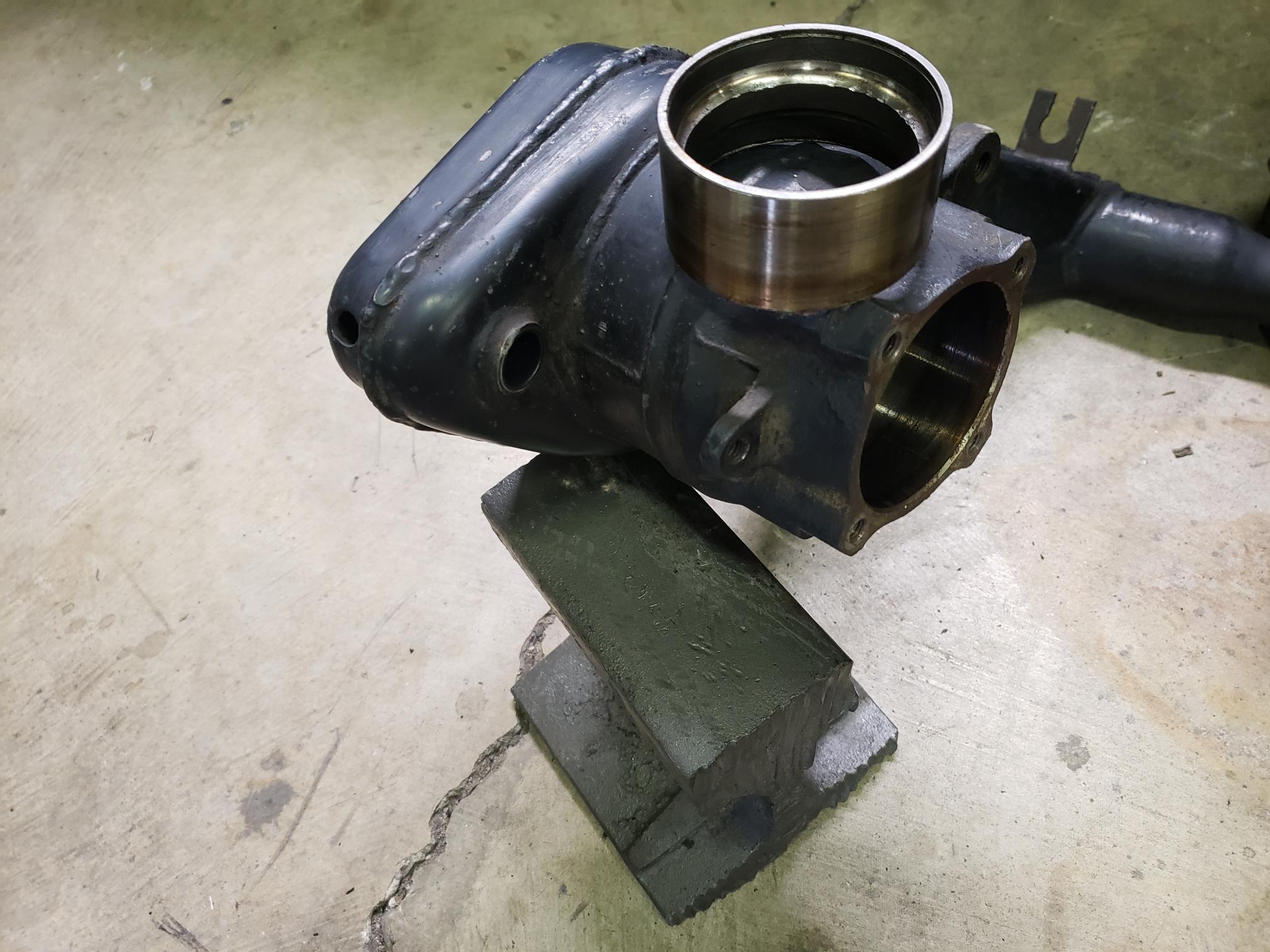

My rear calipers were frozen solid so they're out at PMB right now. Hopefully I can get those on in another week or so, then get it aligned and see how it feels.

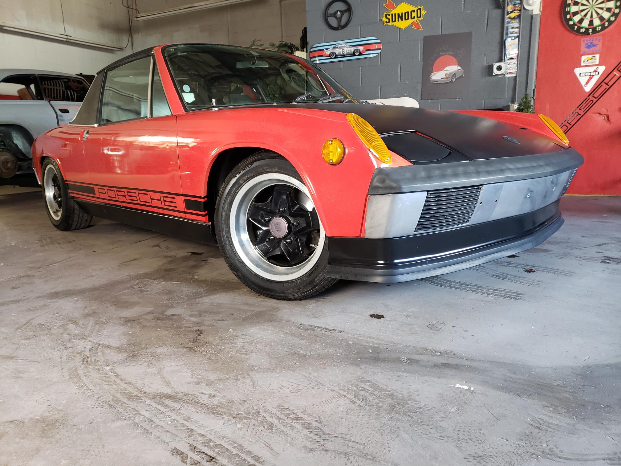

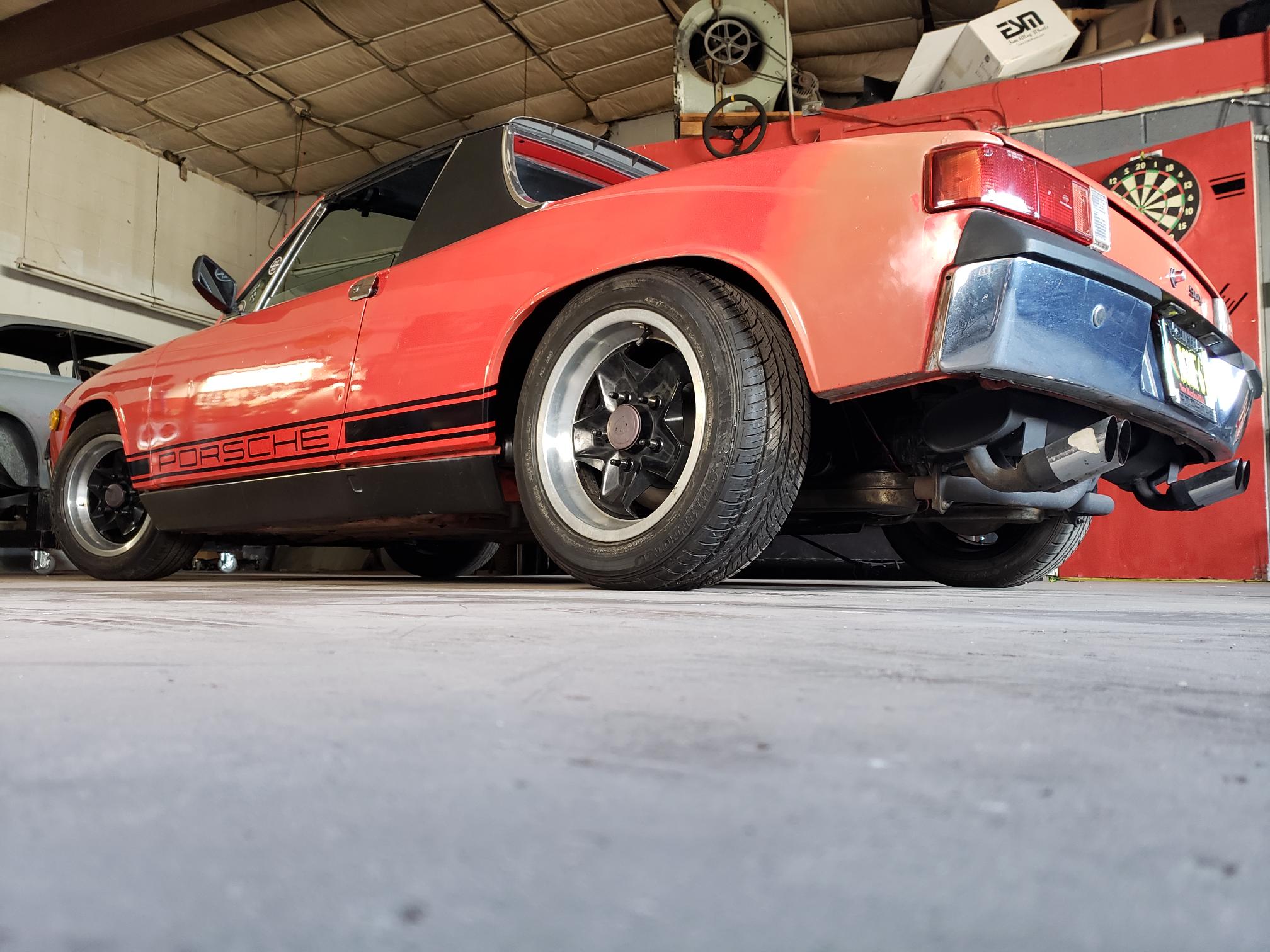

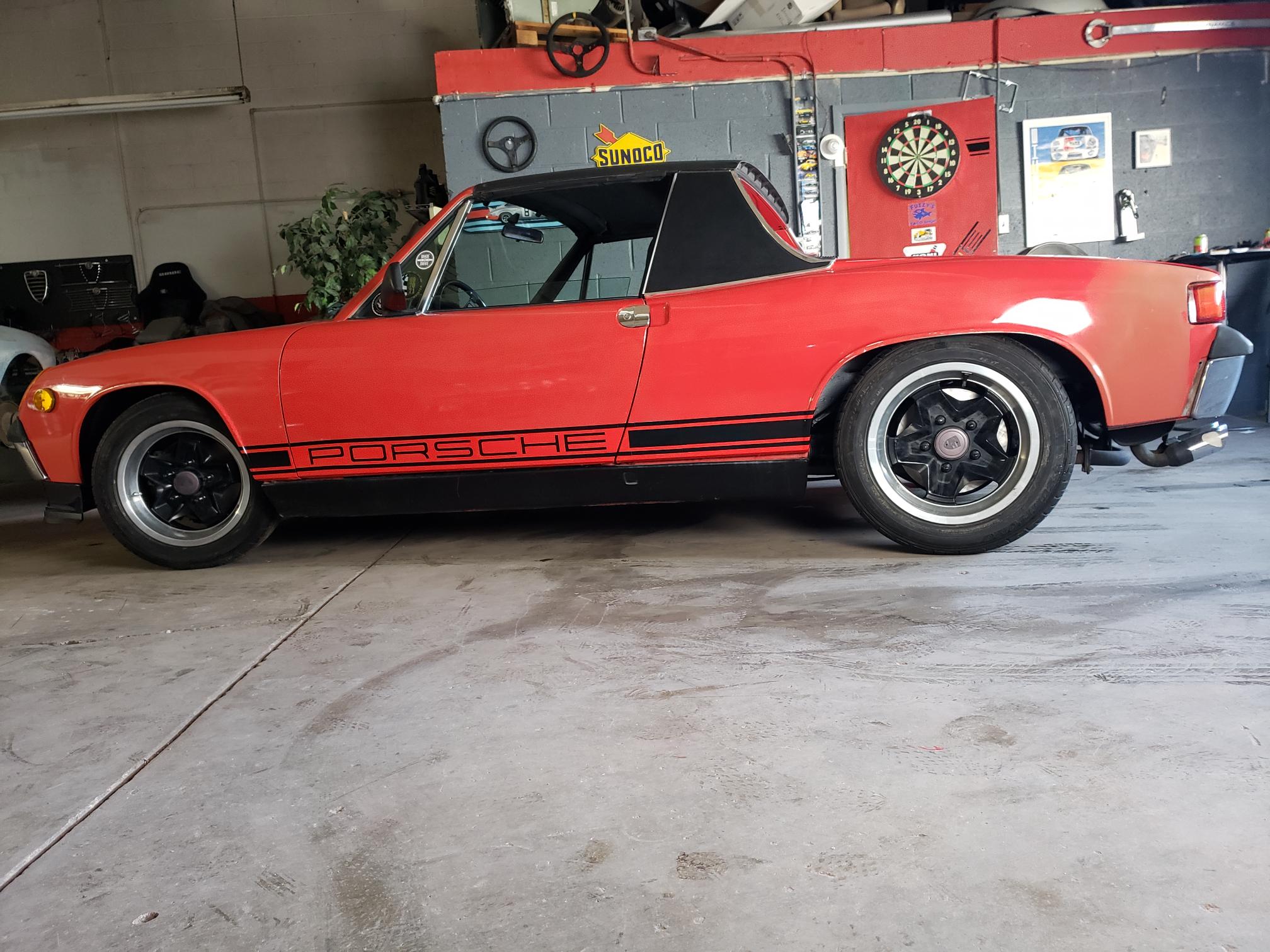

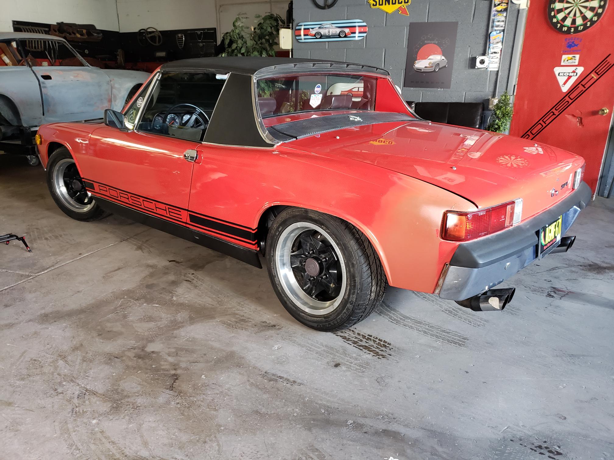

Mayne   Wow, it sure has been a while since I updated this...   Sep 4 2019, 11:25 AM
Mayne   Woops, got ahead of myself with the pics of the ho...   Sep 4 2019, 11:28 AM
Mayne   In the time I've owned the car, it's never...   Sep 4 2019, 11:36 AM

Mayne   Managed to make it to Cars and Coffee on 9/14: ...   Sep 22 2019, 12:29 PM
Mayne   I also got an awesome 50th anniversary key fob. Th...   Sep 22 2019, 01:11 PM

Mayne   PMB five lug conversion complete! The specs ...   Apr 25 2021, 09:37 AM
Mayne   As promised, a video on the five lug install. This...   Apr 26 2021, 08:11 PM
VegasRacer   I normally don't like Cookies on a 914. But th...   Apr 27 2021, 12:48 AM
Mayne   Okay, here's part 2 of the five lug swap video...   May 9 2021, 09:35 AM

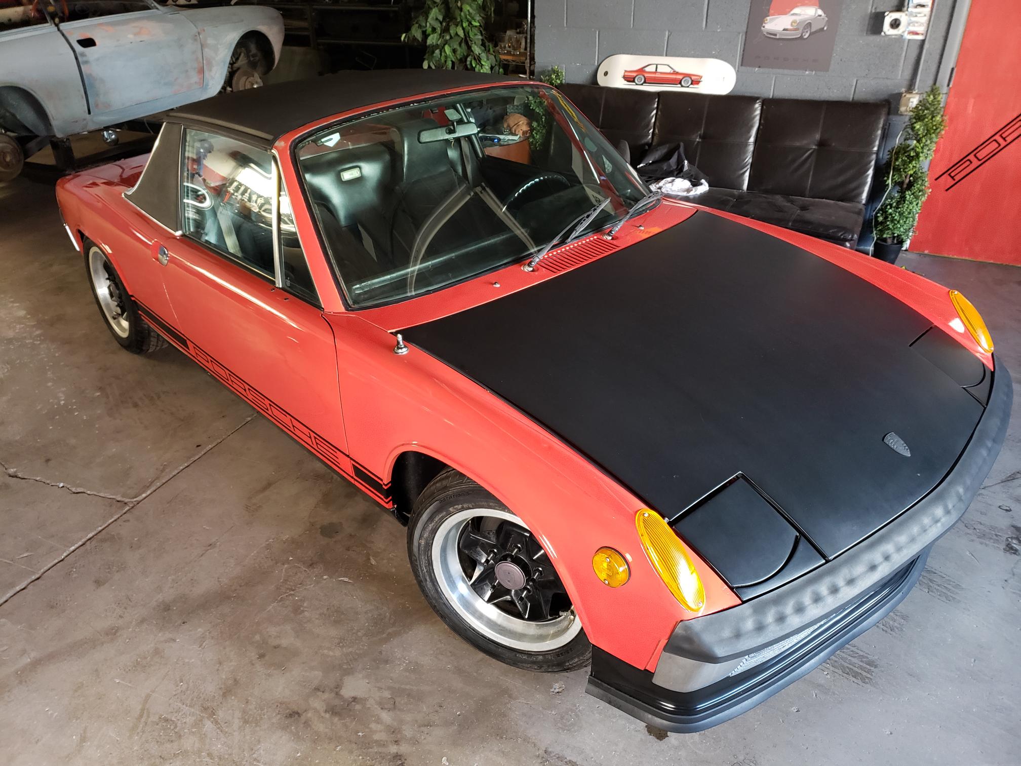

Mayne   In working on the front of the car so much, I deci...   Jan 25 2022, 03:16 PM
Mayne   I stripped as much of the paint on the nose as I c...   Jan 25 2022, 03:30 PM
