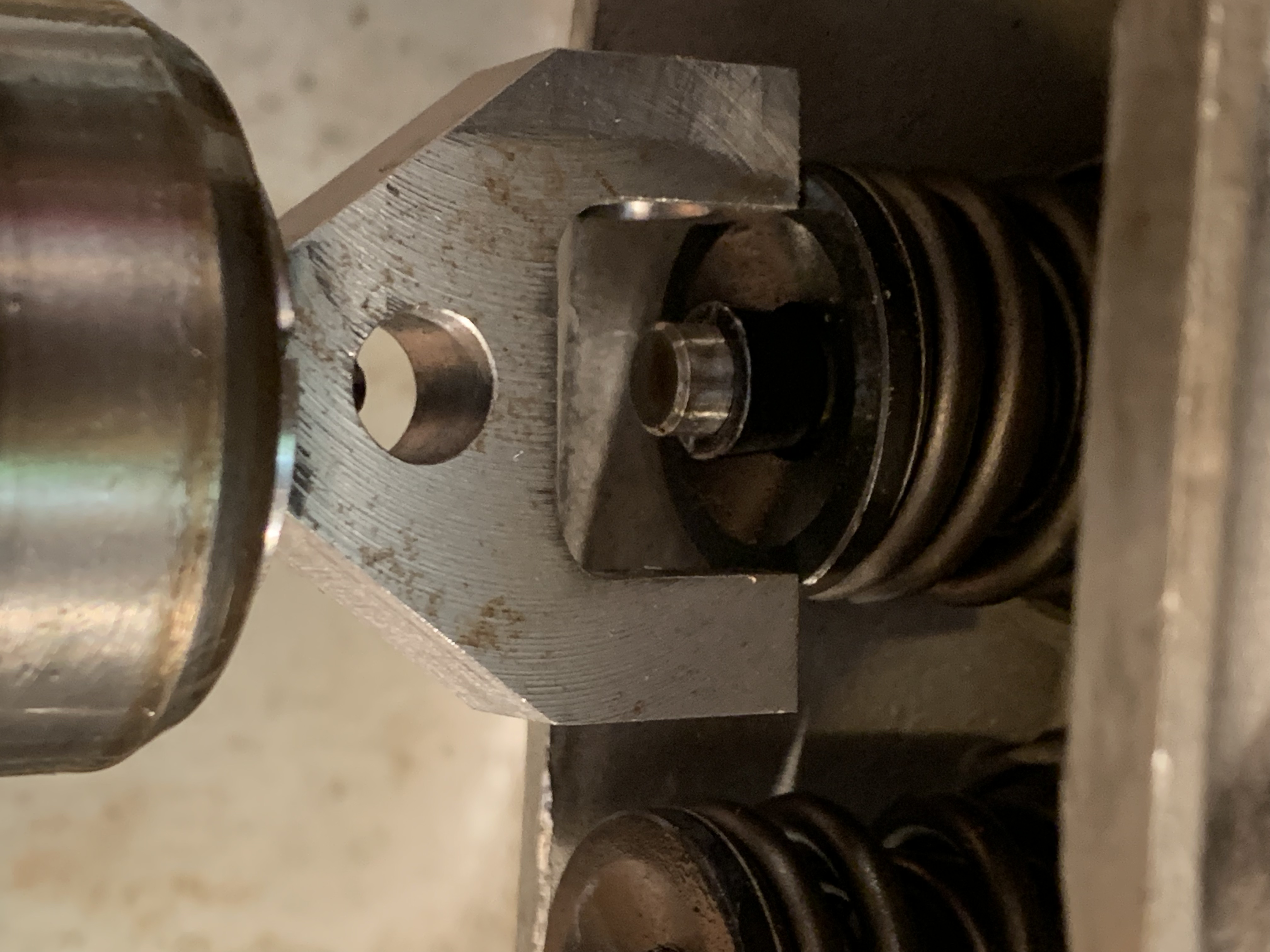

Add new valve train studs tonight and getting the swivel foot rockers on for cylinder one!
More to come
I used the Bridgeport and the adapter in pic to compress the double springs (EZ) a drill press would work here too
-RobertAttached Image
