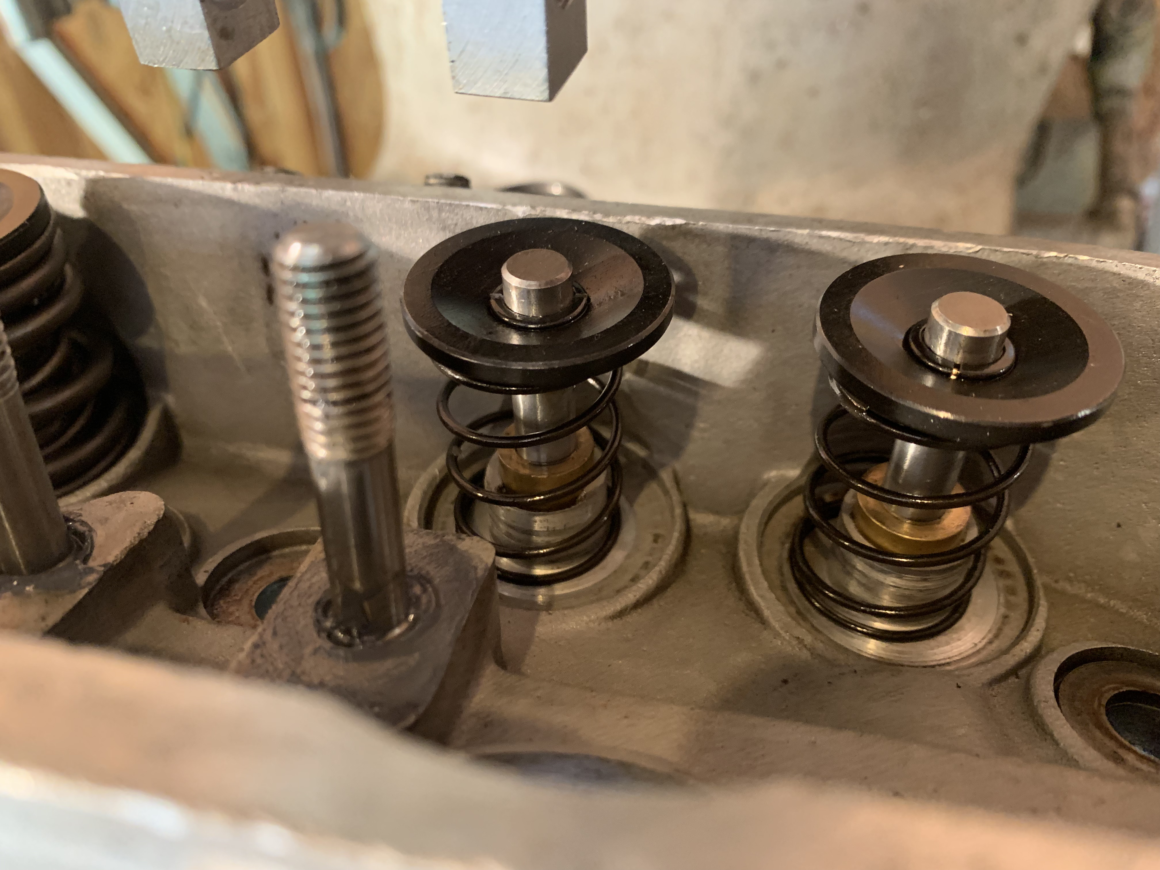

and test springs added
The test seings are from the rocker shaft
One spring is a little light, so I added 2 springs to the Intake valve for testing (working pretty good). I do the final with one of the valve springs in place
